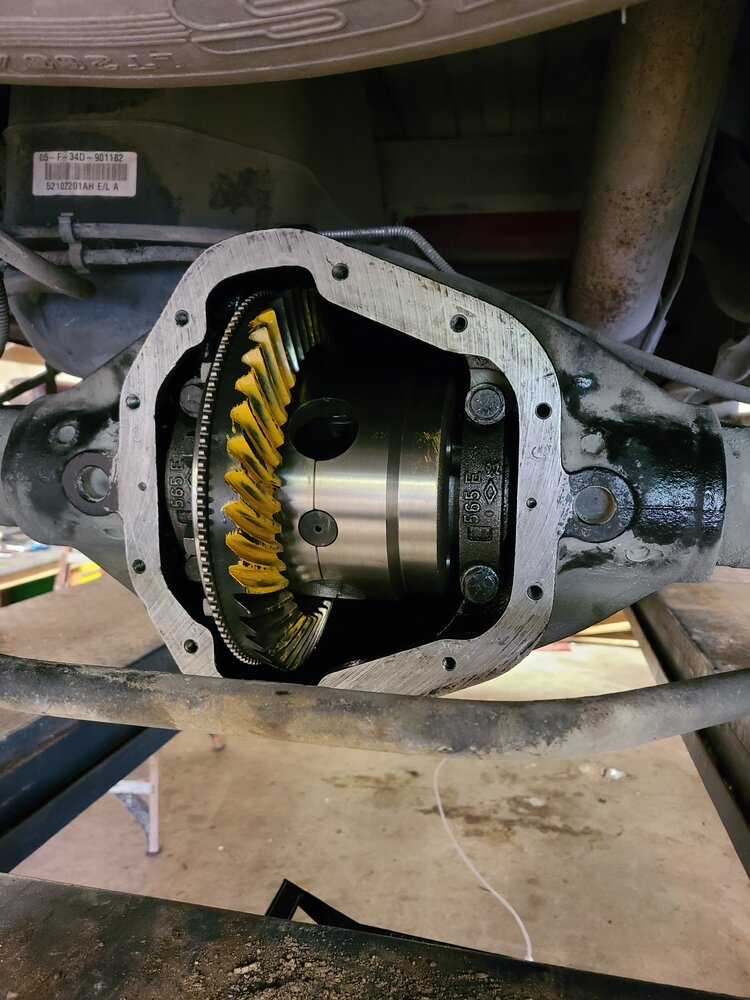

I put a DuraGrip in my buddy's 01 Dodge with a 70U. Can confirm they're nice and tight and will spin both tires on the pavement :D It seemed like the best option available. ECGS hooked me up with the LSD and some new carrier bearings for a damn good price. I picked up two bottles of the Yukon additive as well. Had to do some looking to confirm how much additive to how much gear oil though. So far, it's been a trooper!
Edit: Easier than the Dana 80/TrueTrac route, better when towing than a lunchbox locker, and beefier than the factory style LSD which would require replacing the carrier anyway. In the event the clutches do wear out, they're fairly inexpensive to throw a new set of clutches in! Although, a Dana 80 SRW swap with disc brakes and a TrueTrac would have been sweeeeet.
