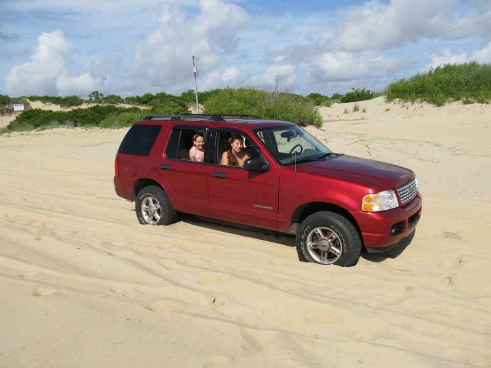

3rd set (load range c though) on the exploder
GREAT road manners, and I've yet to get stuck in sand, mud, wet grass, or even pulling my car hauler up out of the woods behind the house in a downpour (read: I COVERED the trailer in mud throwing rooster tails at it, but made it up that massive hill pulling a trailer)
I get about 35-40k out of them depending on if I'm diligent in keeping the alignment correct :shaking: (friggin independent suspension)

3rd set of at3's?
