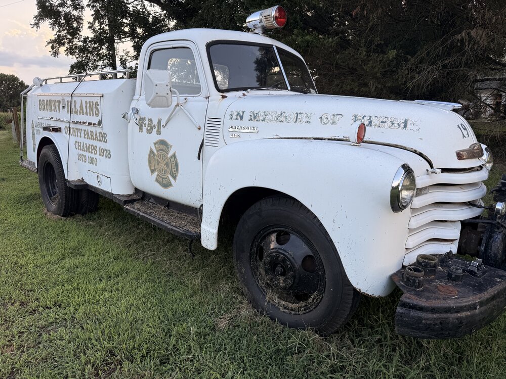

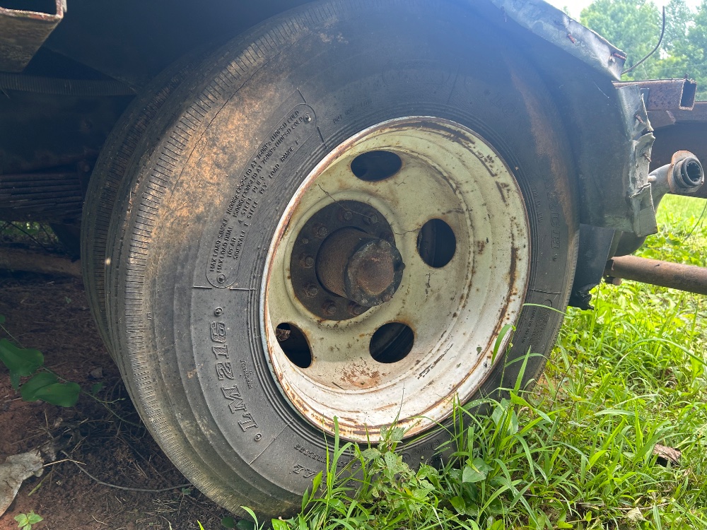

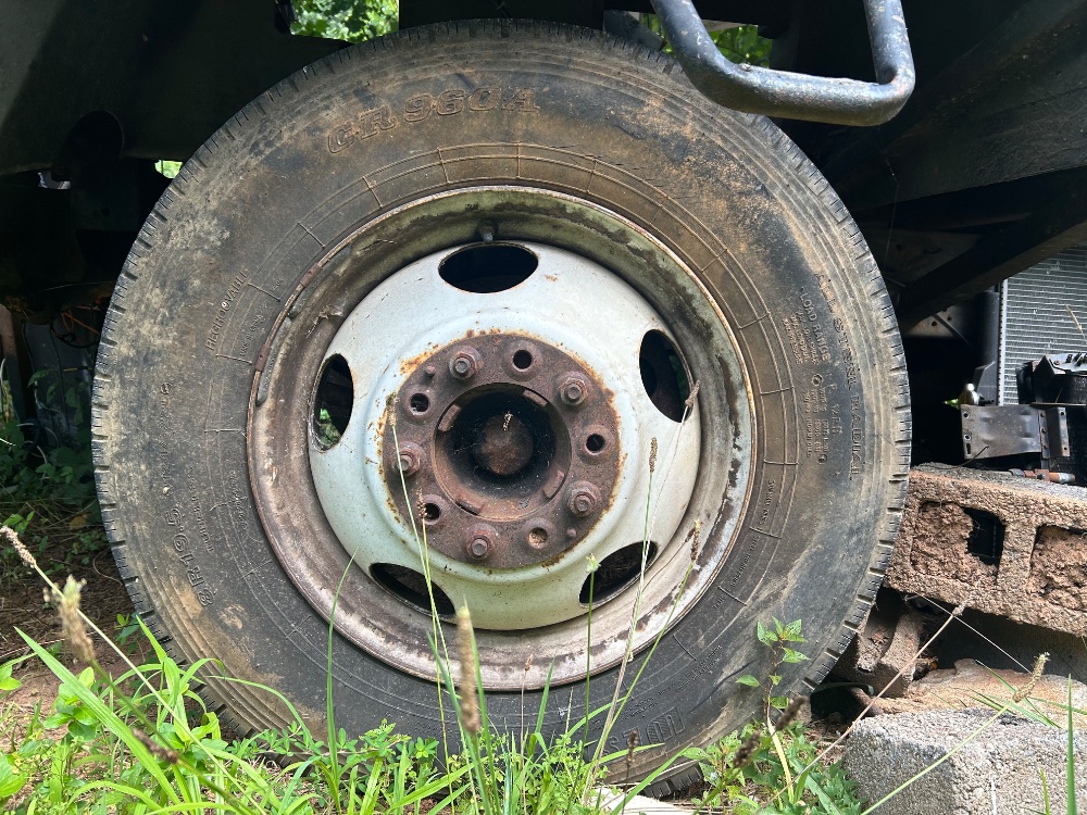

I need 6 Chevy Dually wheels to fit a 10 bolt (5 front is ok) setup, 19.5 or 22.5 to replace the widow makers on my 1949 Chevy 4100 Fire Truck.
Anyone have any leads?
Assuming Google is correct about the bolt pattern being 10x7 25...
You could do adapters to something common like 10x225 which is on F450/F550 and Ram 4500/5500.
But they are stupid expensive.
Or $200ea on ebay, but there's only 5 haha
My be cheaper to get axles from a f450/550 or ram and install them, vs the adapters. Then you have upgraded brakes & steering in the process
ITs a thought, my big thing right now is to get it rolling, but it does need rear brakes
