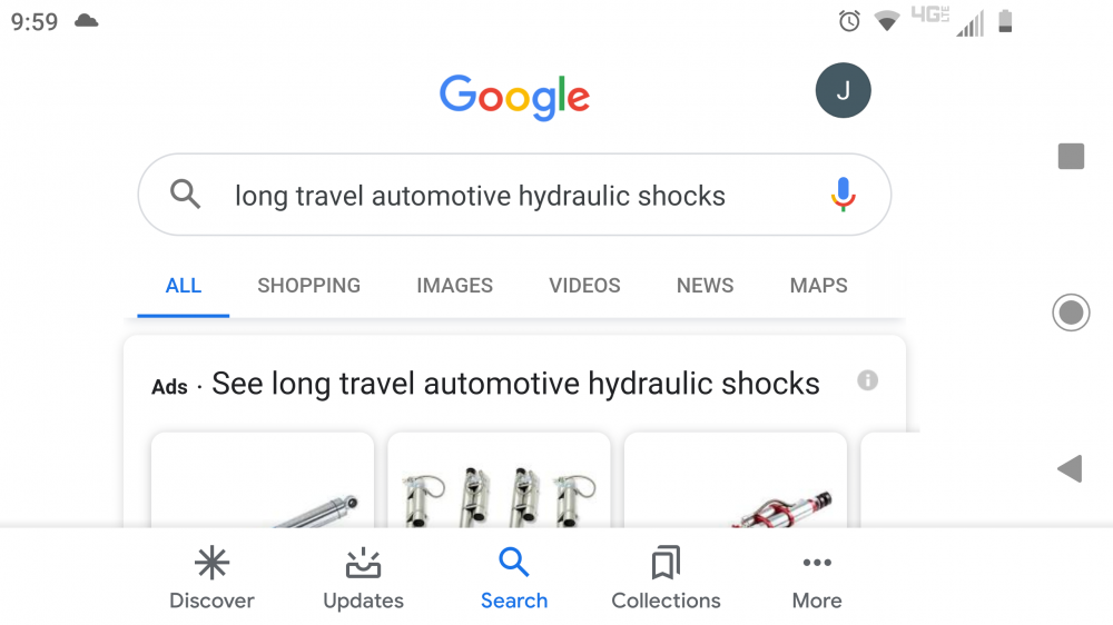

ok in all fairness i never thought to type in "automotive" in the text, my bad and thank you.
