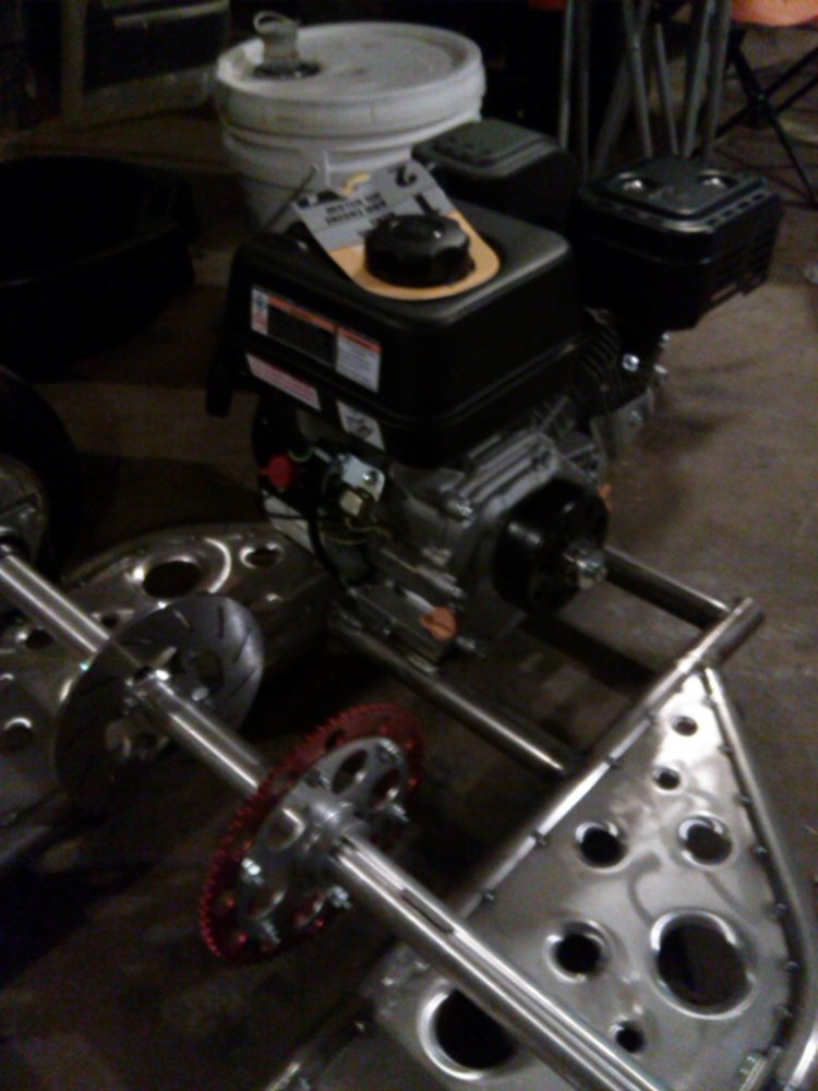

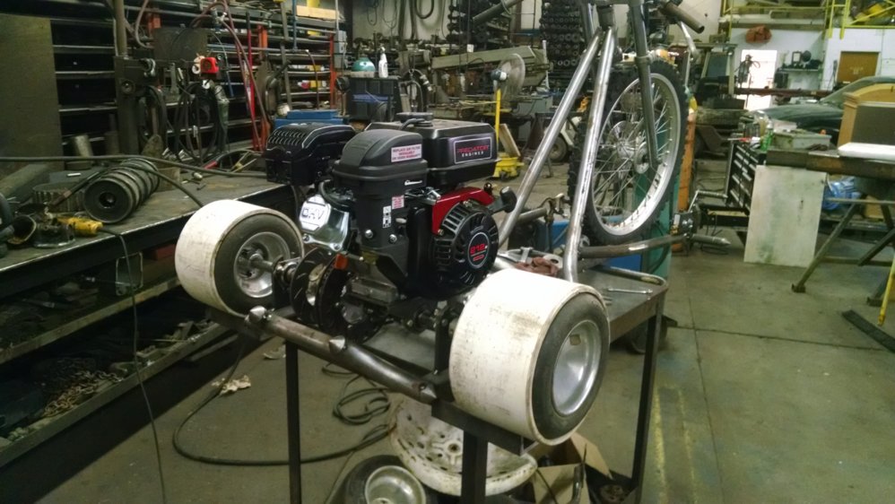

I am goin to use a different set of handle bars, I need to go get a motor and then I have to get it over to @kyleg336 to do my brake mounts and seat mounts. I also picked up some gussets for the axle mounts and ordered some buttweld endcaps for the frame and the foot rests. After saying all that needs to be done, it is officially a roller!!

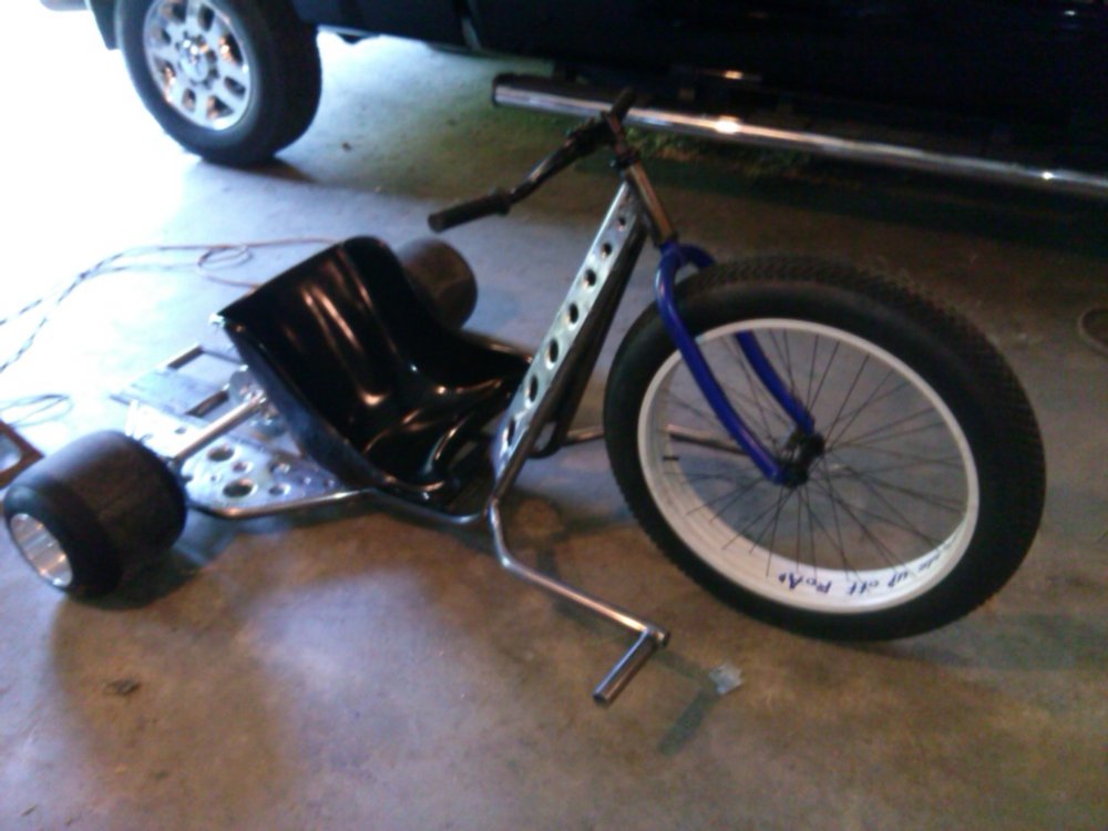

Since Infamous 1 has been waiting on parts. I been working on mine so here a few pics. It is going to be awesome to get them both up and running.

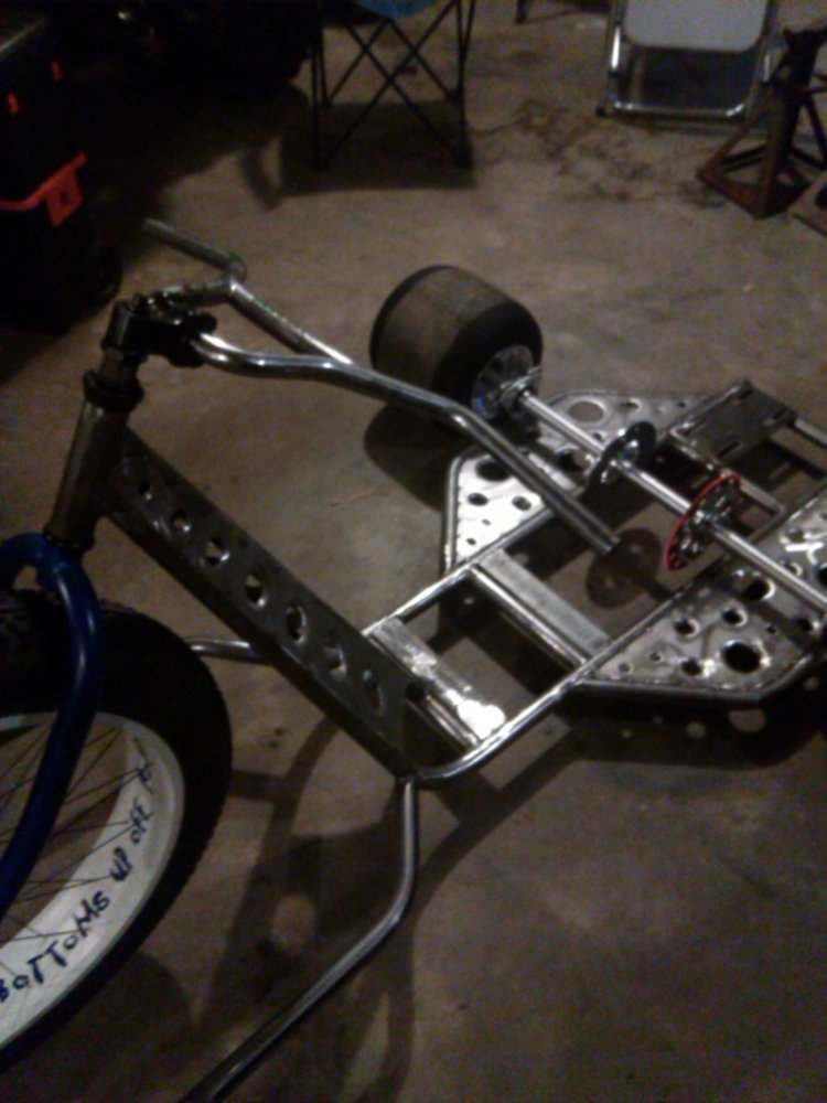

Got the new bars on, gives me more of a laid back seat angle, which I will need whilst pimpin this unit. Will be a little while on updates now got to work on the buggy this weekend!!

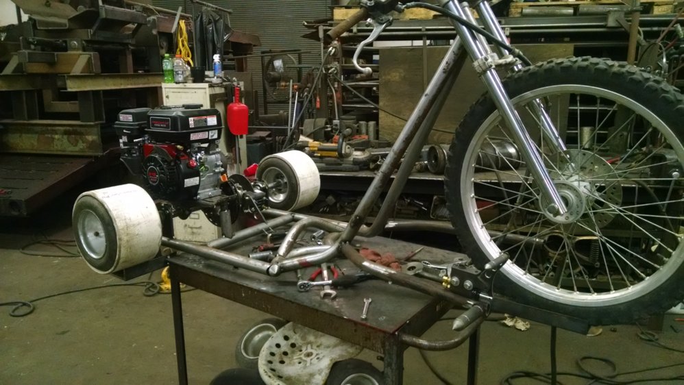

Well I did pick up the 6.5 "hemi pn60363" motor I was jonsin for from harbor freight saturday and sit it back there for mock-up. I also had my master fabricator check out some seat mounting options, brake caliper/master positions and a few other welding touches I wanted this past weekend, so as soon as I get on his schedule It will be torn back down and headed to powdercoaters. Now here is a blurry crappy cell pic!!

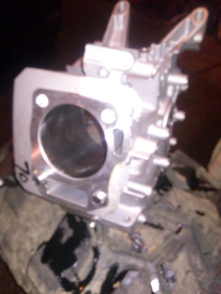

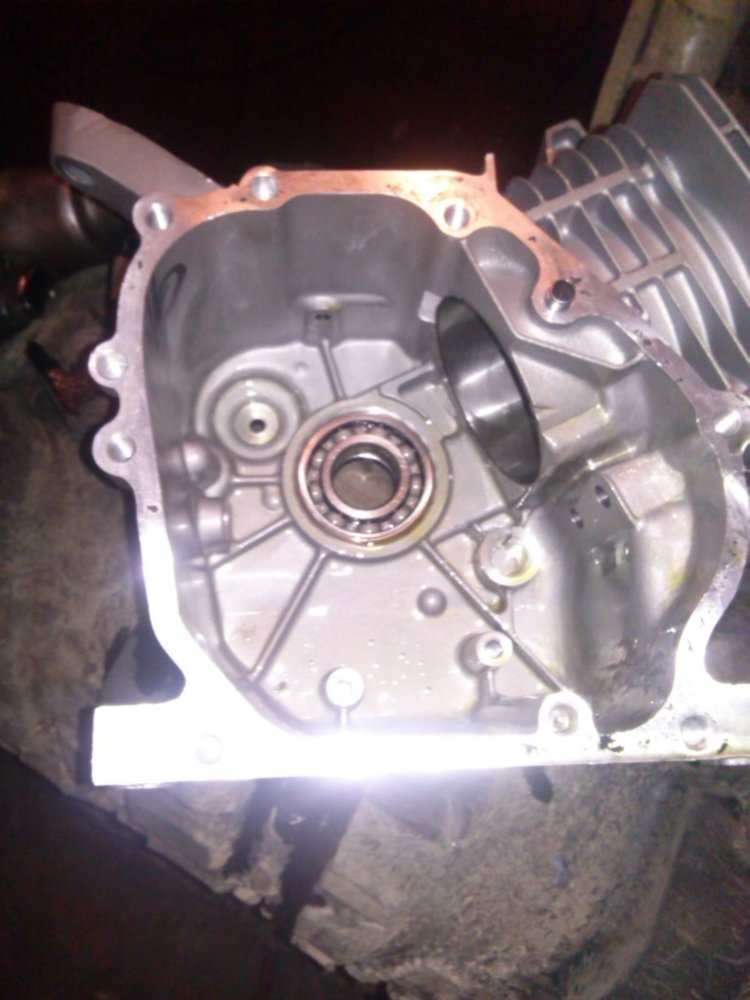

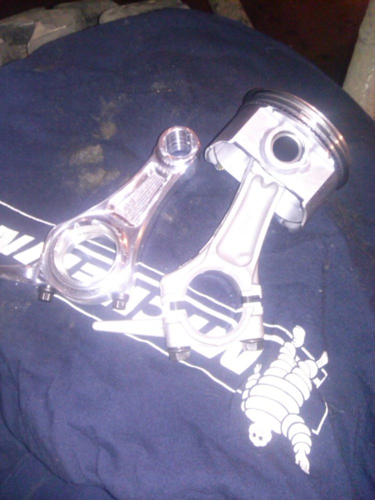

I painted the block and sized the new rod to the crank and polished the crank, planning on building the short block tonight. Will then check my clearances to maybe shave a little more off the head, those combustion chambers are huge on the hemi 212 cc.
Im seriously considering building one of these. Been looking for an excuse to buy a bender and this fits the bill along with my '54 and some changes to the Jeep I need to do. Think I might try a dirtbike motor on it, wonder if a 450 will be too much?
Block looks good man, cant wait to see the chassis PC'd. Any decision on color yet?
