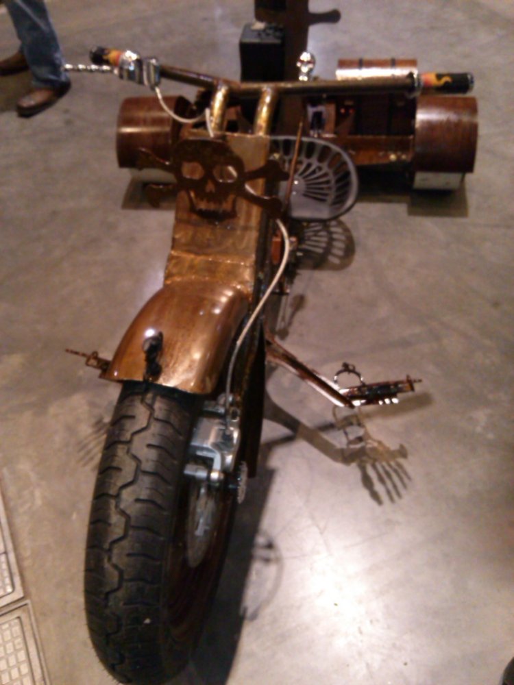

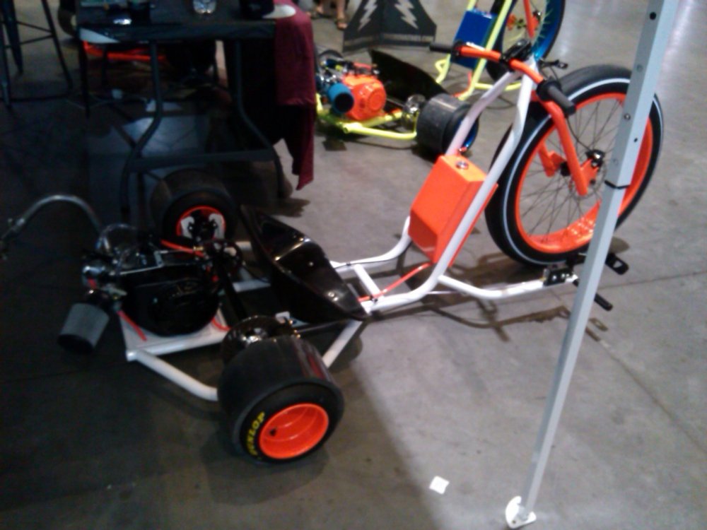

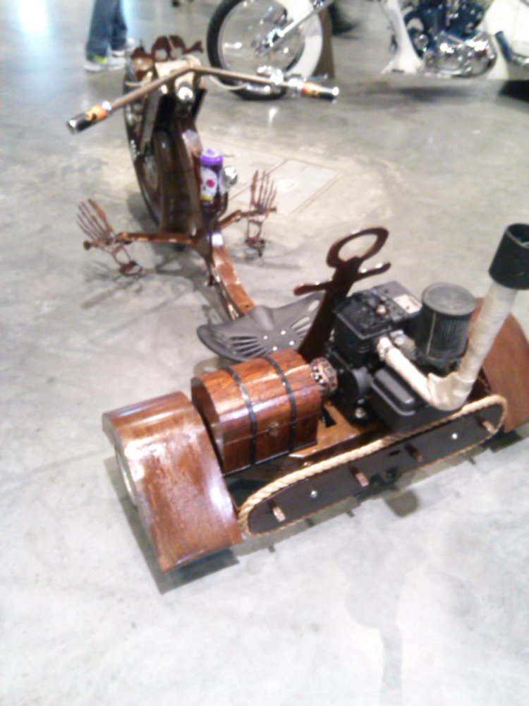

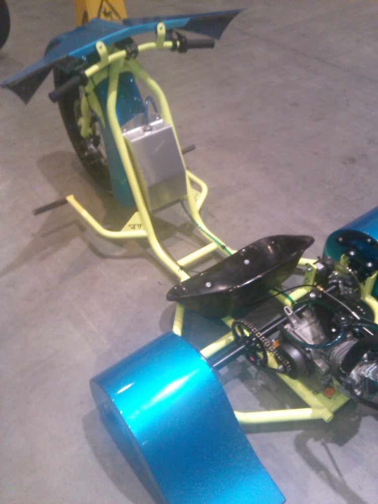

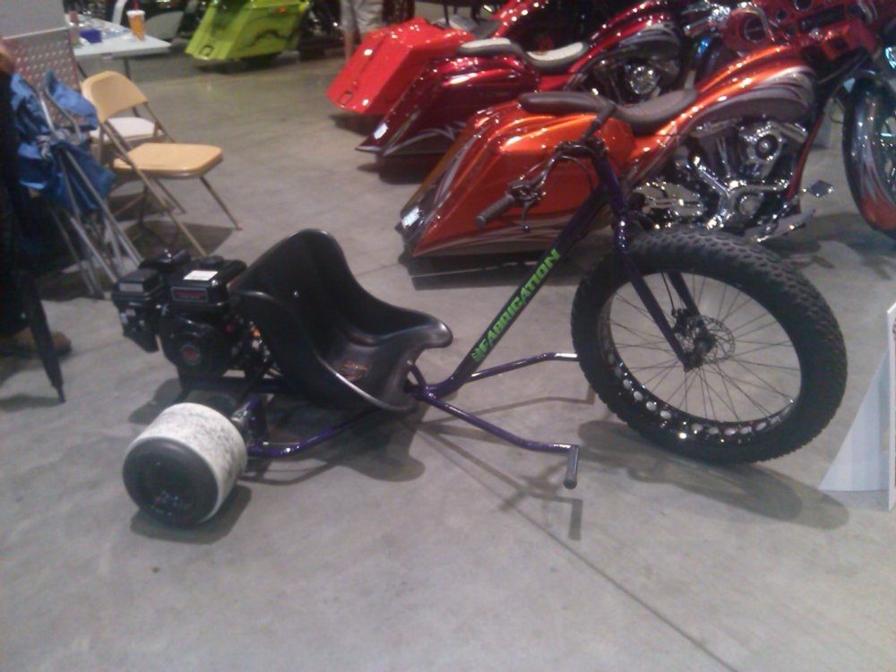

We " me and infamous1 " went to the Ray Price Expo at the Convention Center today. There were a few Drift Trike " Manufactures " in attendance and the prices they were quoting were insane. One guy had a $2500 starting price and you could get over 5K with ease. They looked cool but I would think someone could beat that price and still make some serious change. Just too bad I'm old and stupid.....
Hey where did yall source the axle/tires?
BMI Karting sells a kit for the rear, that's where I purchased mine. I think you could do better hooking up with a cart racer and buying their "outdated" stuff to build a new one. I would like to find a source for the fronts, I think it sucks to buy a new bike just for the tire and forks. I really enjoyed talking to some of the builders at the expo and garnered some ideas also. The SFD guys are cool, talked trikes with me (complimented me on my build, probly felt sorry for me) and even gave my little one a cool sticker. I recommend these guys for anybody wanting a RTR they have a quality product.

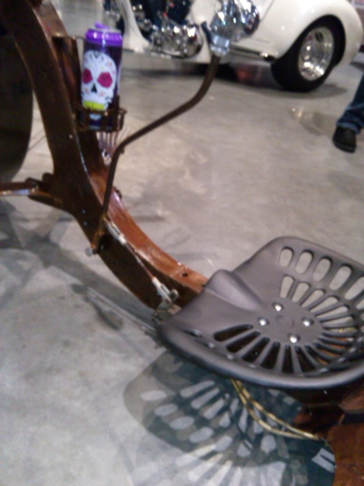

Saw this on the book of faces....

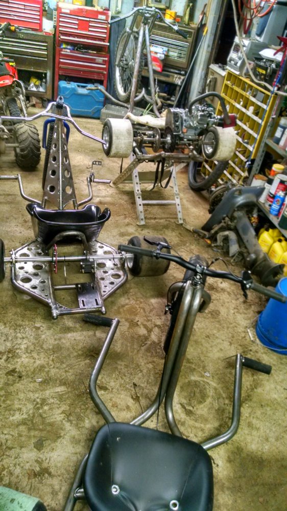

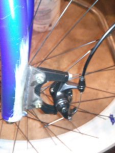

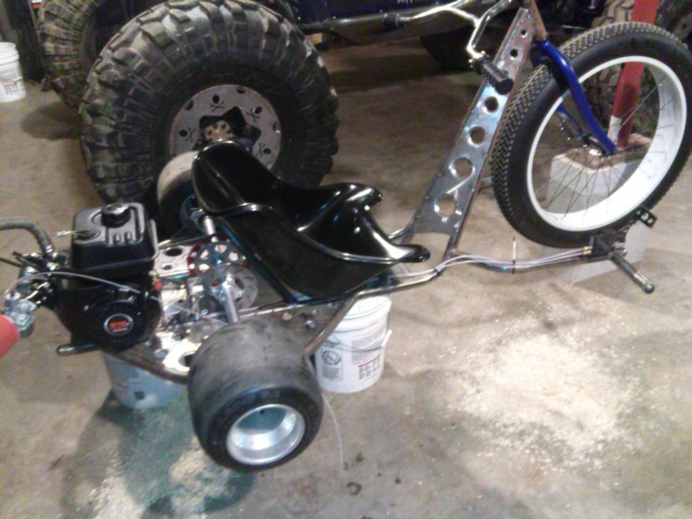

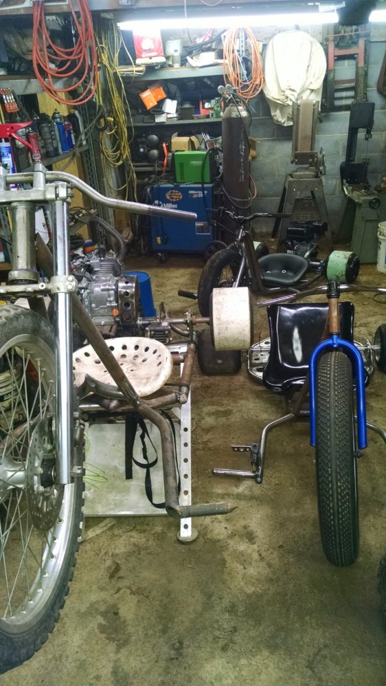

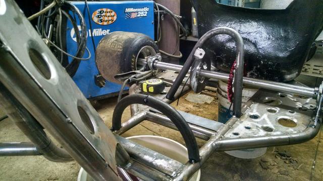

Picked it up this past saturday, first class fab work all the way from @kyleg336. I mounted the engine last nite and started mockup for cable lengths and whatnot. I plan on taking the front wheel to the bike shop today to have the disc brake hub laced. I can actually see the wrec.........I mean light at the end of the tunnel.

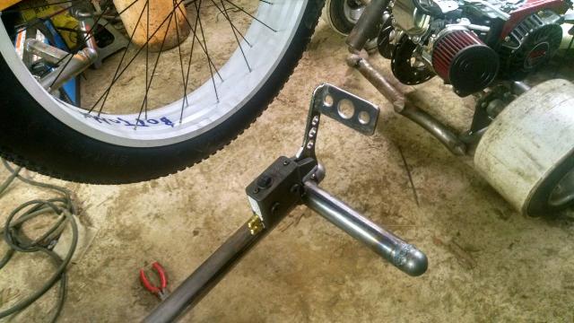

Some updates.

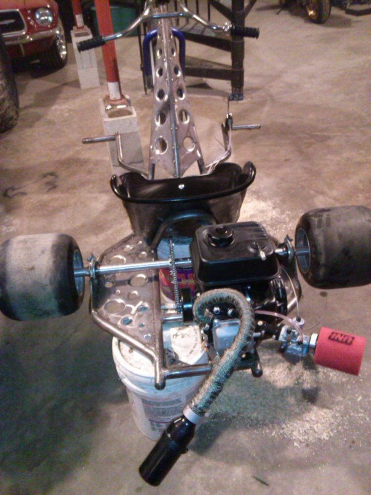

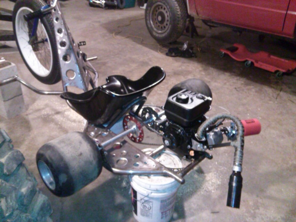

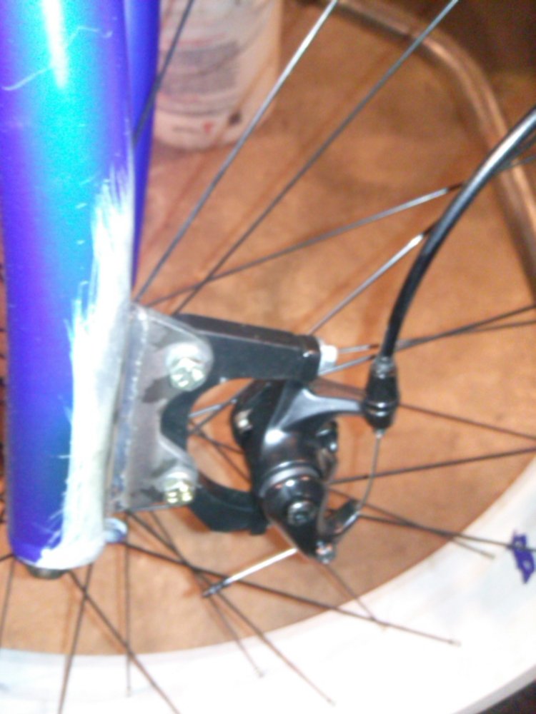

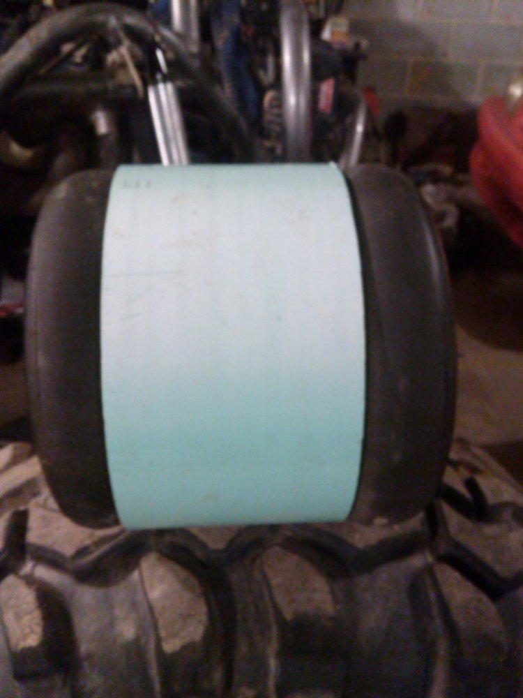

I broke the engine in on the stand last night, turns up hard and fast with a slightly choppy idle. I think I will be satisfied with the power and with the muffler its not "too" loud.It does make a cool blue "cone" at the tip under hard free pulls with minimal popping. I also took the front hub and rim over to Pittsboro Bicycles, Eddie is a cool dude and seems to know his stuff on bicycles, we shall see. Waiting on the throttle cable and some wider PVC sleeves (one on it now is too narrow and pavement contacts the tire also) and I may do a little drifting.

well got it moving under its own power, rode it in the yard and then Emma (my 8 y/o) convinced me to turn it loose in the shop LOL, she is not a very good videographer and actually heckled me at one point. It still has a little tuning left and needs front brakes but it is driftable at this point.

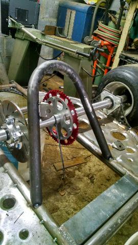

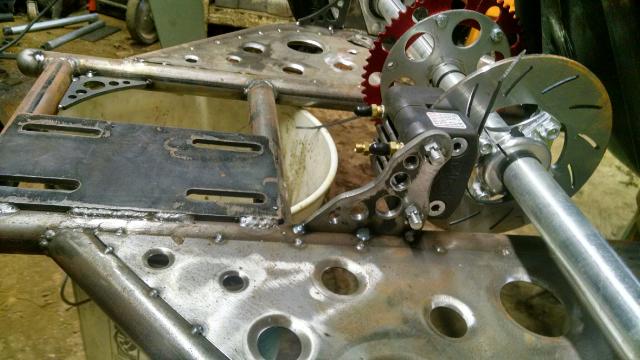

Well no actual updates but I did just get a text from the bike shop and my disc brake front wheel is ready. I found out with as much distance as I had between the rear axle mounts that i was getting a fair amount of flex, enough to slip the chain off under hard accel. I plan on adding at least one more axle support and mounting the catch can and it should be ready for powder and to be considered complete.
