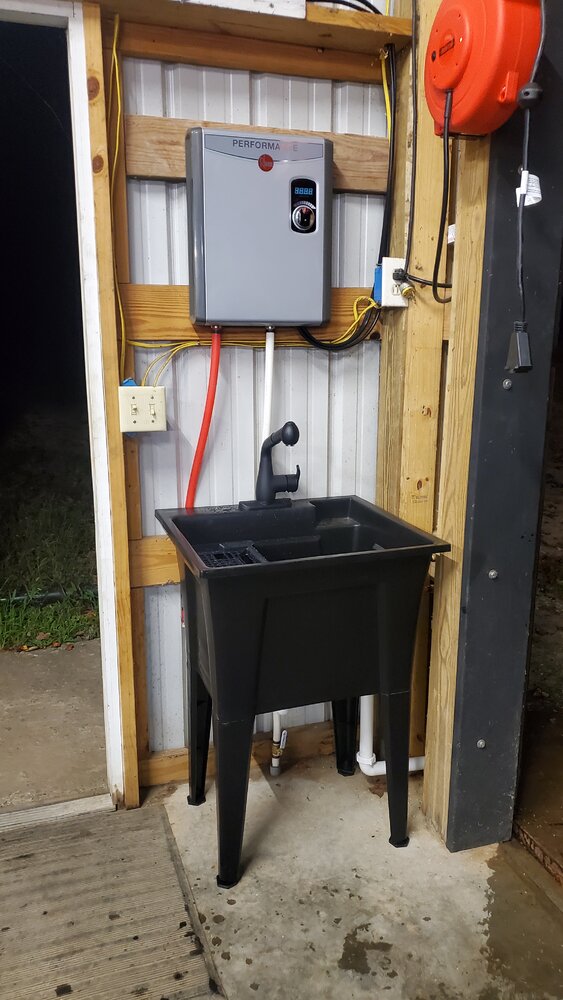

One of the best things I've done to the shop was adding this tankless electric heater.

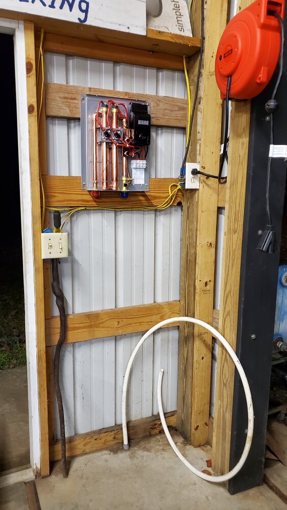

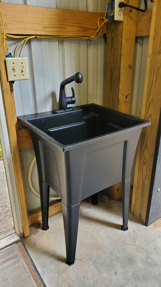

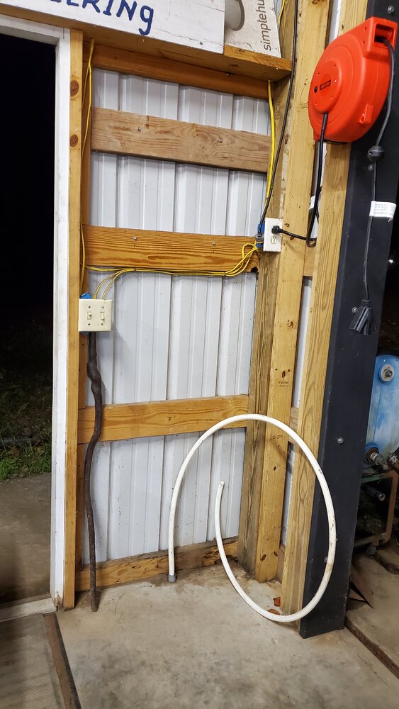

Added some nice touches to the shop this week. I've had a water line run down there for probably 6-7 years, but never had anything to connected it to. Finally decided to change that. View attachment 400562View attachment 400563View attachment 400564View attachment 400567View attachment 400568
It's nice to have, but also kinda weird being able to wash hands and drink water down there.

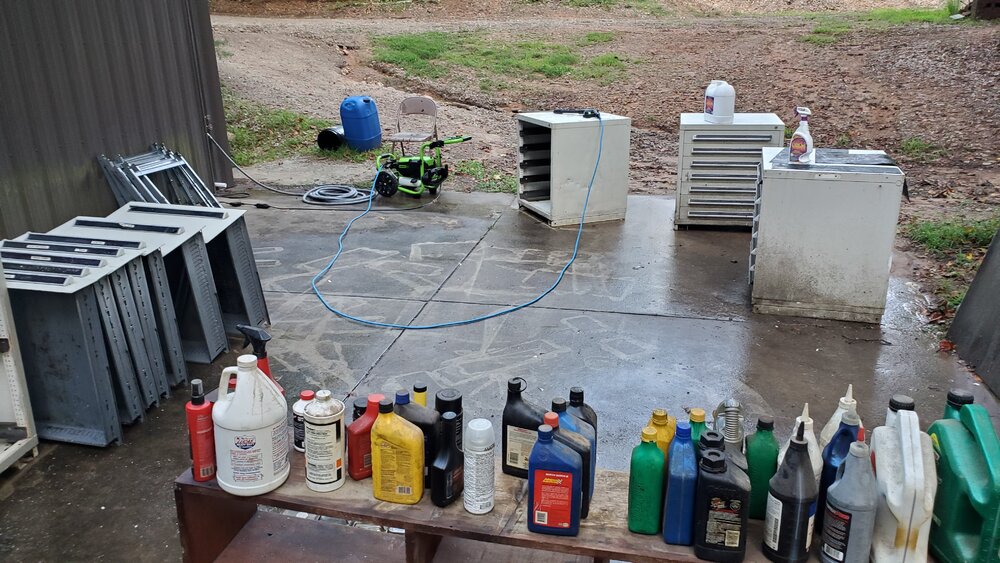

One of the biggest reasons for the tankless was the very intermittent usage, but also so I could wash equipment and shop stuff with the pressure washer and not be limited by a small tank. Put that to the test today, and worked great at 120deg for nearly 3hrs of tedious washing. View attachment 400569
And also getting a small electric pressure washer that didn't outflow the 2-3gpm of the heater. I've washed more stuff down there in the past 6 months than I have in the past 6 years up at the house.
