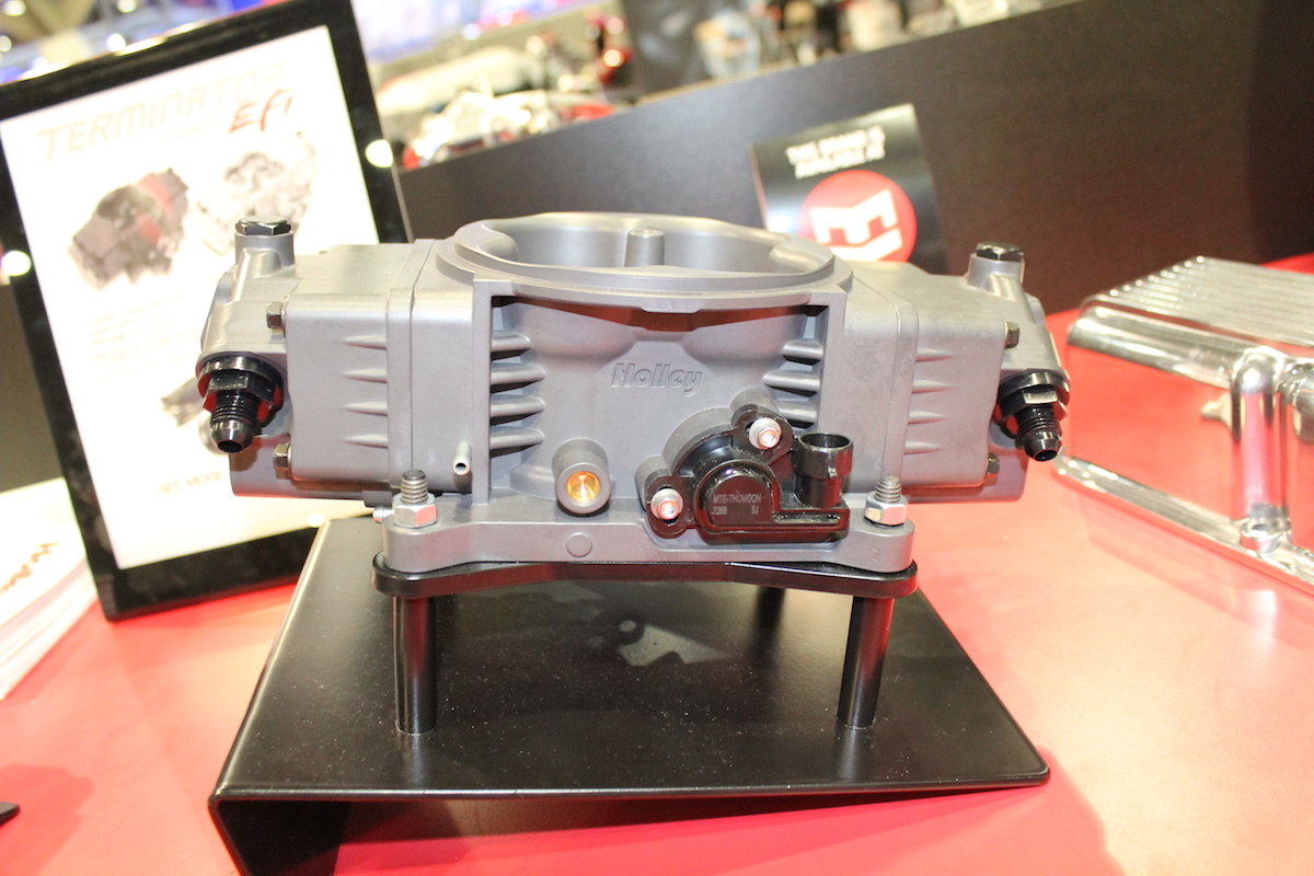

I knew it was only a matter of time before someone made a completely sleeper EFI system that looks like a carb. Holley did it, and it's really cool looking.
