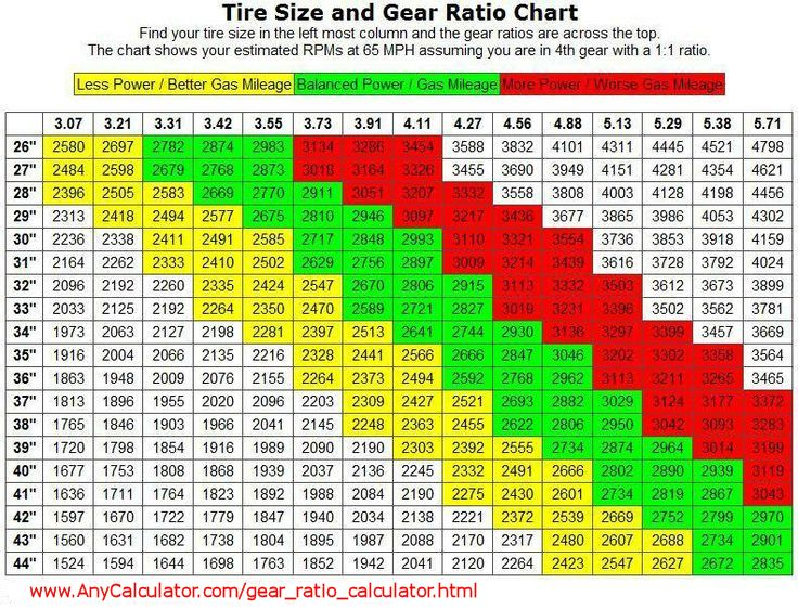

In case you don't understand. regardless of your engine. Your gearing ratio is in respect to your tire size.
I can swap an LS7 into a jeep with 5.13 or 3.07 gears and 70 inch tires and it will drive like a pig in either situation. And then now size the RPM range to the engine power band you're targeting.
For 35in tires on a brick, id seriously consider 3.73 to 4.10 gears with an LS swap on true 35s. If you want first gear on that ax15 to be usable, and sacrifice some power (then whats the point of a LS swap...), then maybe 3.55 gears. Or instead of regear, then resize the tires to hit the desired RPM range
Muscle car or Resto-Mod LS swaps tend to shoot for 2000-2100 RPM cruising speed at 65 MPH, while truck and SUV guys shoot a tad higher around 2200-2300. Jeep bricks love to be in the ~2550 RPM - not excessive but a smidge high.
Well what I do understand for a fact in real world experience is that TJ on 35s with 3.08 gears 6spd auto with 4:1 first gear is faster than I ever could want a short wheelbase jeep to boogie on down the road.., thats real world behind the wheel talking not what some chart says. That chart has truth for what rpm you want at certain speed but who cares when you've got over 400hp in 4k lb jeep that breaks traction at slight throttle...4.10/4.56 would make it pop wheelies going from 3.08 and in the rain would be stupendous...as if it's not hard enough already when wet. Hey, customer is more than satisfied as am I so that's all that matters.
Grim jeeper has a good calculator. If you plan on street driving, get a combo that puts you around 1750 - 2500 at 70 for most motors to be efficient and not lug or overrev. Especially with a 4.0 they do not like anywhere near 3000 rpm. The transfer case should be where you get your low from, not necessarily the trans or final drive. Sm420 with 6.55:1 still has a 2:1 transfer case in stock applications but only 1:1 on the high side so it would need a low numerical diff to cruise on the highway but with a compound of 13.1 itā€™ll crawl with a low number diff. while an ax15 np231 is around 10 compound range and needs a lower gearing (high numerical) to crawl but with 0.79:1 overdrive it will cruise with a higher numerical diff. Bypassing 1st is not a big deal on the trans, Iā€™d be more worried about being able to cruise at 65-70 and any granny would help in the rocks.
Saying x gearing vs a tire size is leaving out some very important variables (trans and t case) that have a huge impact on drivability

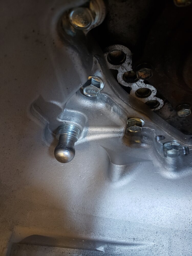

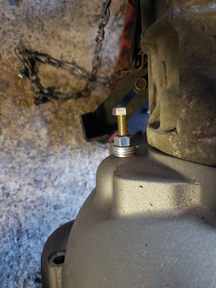

Any of you who's used the quickdraw bellhousing can shed some light on the pivot ball install/ adjustment please? No instructions came with it, company hasn't responded in a week now and thats what I lack in install, thank you
It came with a big long bolt that goes in from backside of new bellhousing with a bunch of washers that says its for pivot ball but no input an installation. Thank you
might want to post pics of what your're talking about. Is it for the slave cylinder pushrod?

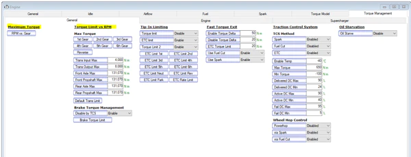

Yes those 6L80 will have that. Just like that same engine in the tahoe i had, had it. Youre basing the entirety of your 'viewpoint' on this solely on your first gear experience? Did you ever get out of first gear? You understand how steep 4:1 is right? Compared to final drive 1:1?

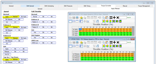

But anyways. Sounds like a really bad TCM tune. Some threw some generic banks file at it i bet. With the right TC slip and torque management, you would not be experience any kind of "first gear lurch", just like the stock tahoe does not with a 6.2 engine...
still need some help with this if anyone has an idea
Do you do tuning? If so, I have another customer with an LJ and the same Gen V 2018 powertrain but he's on Tons/40s/etc and he want every bit of power and proper shifting he can get...so if you do remote tuning, I have HP Tuners so let me know if your interested
Post up pics of what you got

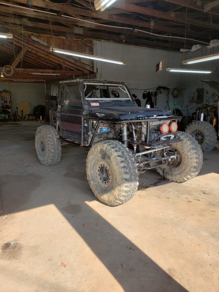

I will when I get the trans back out of it. Right now I jumped onto samy buggy....oh the joy of multi tasking 4-5jobs at the same time lol
Post pictures of the Sami buggy
I figured you'd be interested lol. It's a forum member, You've probably seen it on here. I'll get some pics up soon (if they don't get removed LMBO)

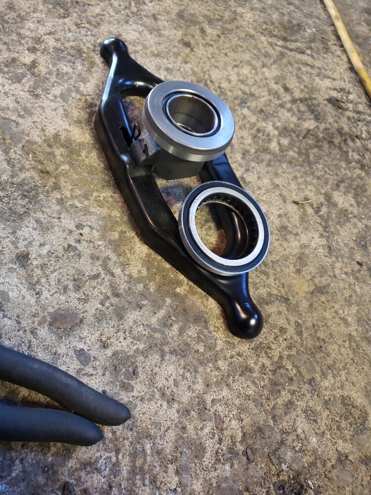

Just realized the clutch kit for the ls came with this bearing...but the Quickdrawbrand bellhousing came with the shift fork/ pilot bearing and throw out bearing so what is this little bearing for?
And @chris_heres pics of the pivot ball setup..you ever installed one like this. Thanks guys!
That's two different kinds of throw out bearings.
