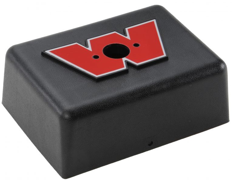

I took on a small project a little while back where I rebuilt a Warn 8074 winch. I got everything painted and sealed up. The winch did not come with any of the electrical components needed to operate it. So I built a tray and attach the solenoids to it. Ran some wires and large cables and now she works perfectly. My problem is that the wiring is now exposed. Since I had to fabricate the tray and wiring I'm now in a pickle to finish this thing off. I don't believe a replacement Warn plastic cover piece will work with my custom tray so I'm stuck figuring out what to do.
One idea that keeps popping up is to build my own plastic box with the dimensions that fit my tray. The problem is I have no idea if this is even possible. It's not like I own a 3D printer or injection molding machine. Would any of you have an idea on how to accomplish this? I don't want to glue pieces together to make this work. Maybe fiberglass resin and a mold?
Here's what I'm talking about:
http://www.quadratec.com/products/92199_00.htm
How about some sheet HDPE and the harbor freight plastic welder? Or ABS and acetone. You can use the shavings to make a filler glue that would leave you with material to blend on the corners.
the Warn cover is an injection molded ABS probably about 1/8" thick material. Are you handy enough with Wood to make a block that could be vac formed?
If you can make a block of wood and sand the edges and corners out, and supply a piece of plastic, I can Vac form it for you. I may even have a scrap of PVC that I could form it with. But ABS is definitely more durable.

How about kydex. I think you can heat it with a heat gun and bend it. Its the stuff holsters are made of if your not familiar with it.
Abs bends pretty easily with a heat gun or butane torch. Might could fab up a box of sort with some bends and silicone the open edges to make it water tight

My first idea was to go to Lowes and find something like this:
http://www.lowes.com/pd_238217-53911-2CKU_4294653960__?productId=3142209&Ns=p_product_qty_sales_dollar|1&pl=1&currentURL=?Ns=p_product_qty_sales_dollar|1&facetInfo=
It looks to be roughly the size of the Warn box. Would be worth a trip to Lowes or Home Depot to look at their electrical department and see what ideas they can give you. Bring the solenoid pack with you and fit it inside the box.
How big is the solenoid pack? There's a bunch of waterproof project boxes like this one:
http://www.allelectronics.com/make-a-store/item/cse-18139/junction-box-175-x-175-x-125mm/1.html
Depending on what dimensions you need to make it fit, drill a couple holes for wires and voila!
Kydex is a good option and will be easy to use. If you can use a milling machine or know someone with a cnc router or mill, glue togehter a stack of pvc lumber and mill it out to that same shape.
I have a buddy with a 3D printer. If you know the dimensions (or better yet, can provide a CAD model) I can ask him to price it.

Radio Shack carries project boxes that would work for this.
I did not know this. I'll check into it.
edit: I looked into it. There is a possibility there and it's only $7.
I would be curious to know.
The radio snatch boxes probably won't hold up in the weather. They're usually fairly thin and brittle, and likely won't have any UV protection. Worth a shot at that price, though!
