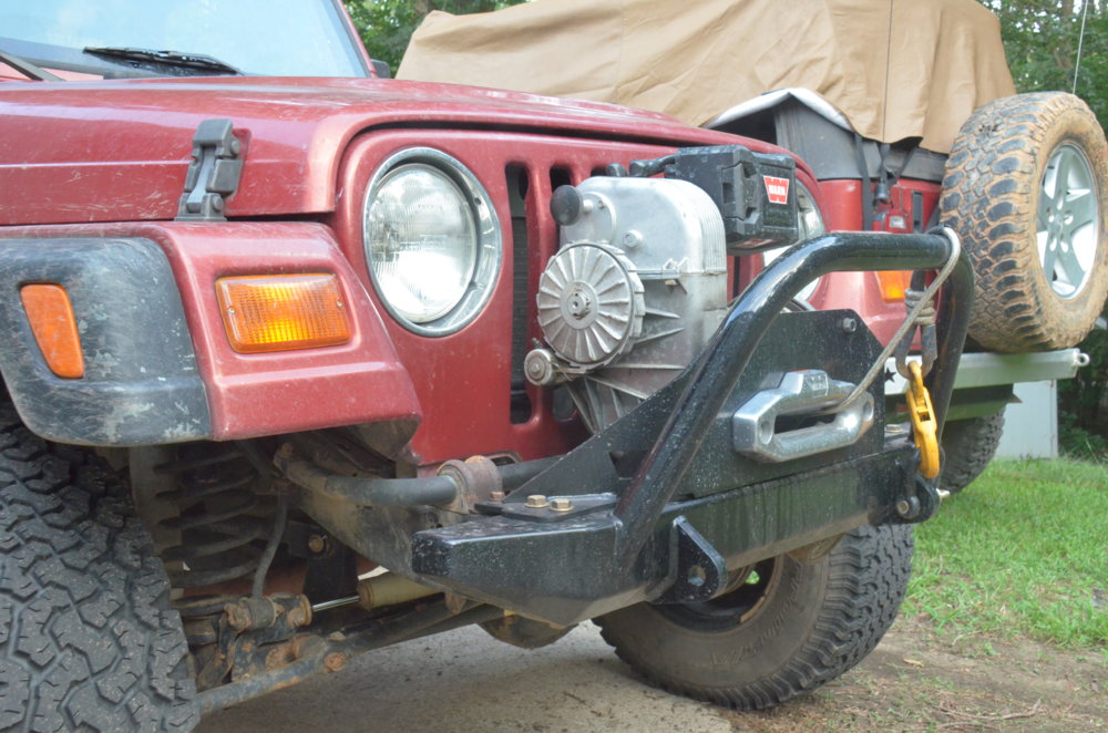

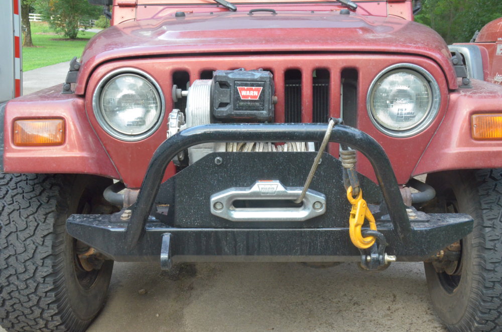

Back in the fall, we noticed @CasterTroy had a pretty nice pair of bumpers on his TJ. They were a matching set from Rusty's Offroad. It turns out the front "prerunner" hoop option perfectly clears the 8274 mount. It's actually one of the few aftermarket TJ bumpers out there that fits with the standard Warn 8274 bracket. And the hoop gives some extra protection to the solenoid pack and the top of the winch, so it's less likely we'll break the top of the winch casing off.

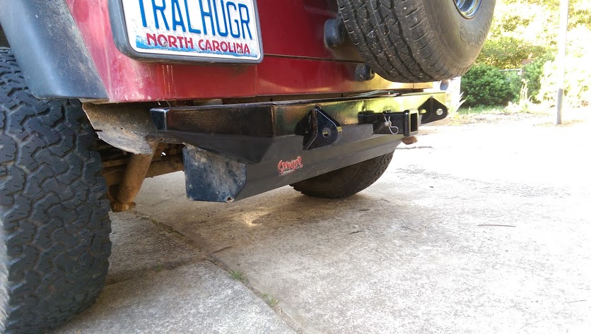

The rear bumper was a real pain in the ass.

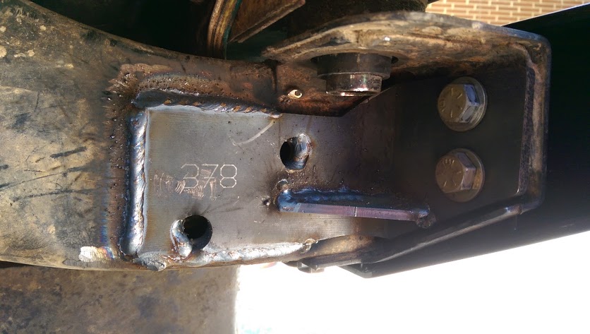

It bolts through the four normal holes that the stock bumper does, but then it adds two holes on each side inboard of the frame rails. For whatever reason, I couldn't get any of them to line up. It took a lot of die grinder time to get something that worked..
I also had a pair of TJ bumper reinforcement brackets from Barnes 4wd laying around. So I invited my buddy @mcutler over and asked him to weld that shit up.
It wasn't his best work.

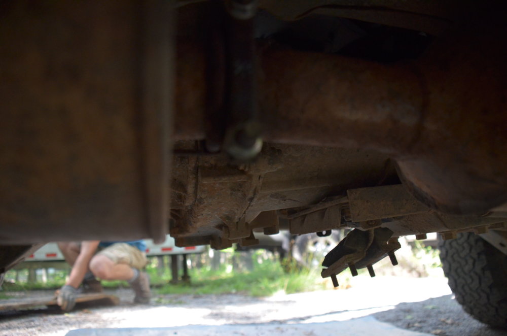

After waiting in line for something like three fawking hours, I finally got my turn to do it behind the wheel of @trailhugger 's Jeep. The V notch starts with a couple of stumps on the right and some pointy rocks in the middle. I pop over the top and... belly out. No worries. I have spent lots of time surfing on a TJ skid plate. I back up and hit it a little harder. This time, I'm greeted with the distinct vibration of something motor-related rubbing on something chassis-related.
F me.

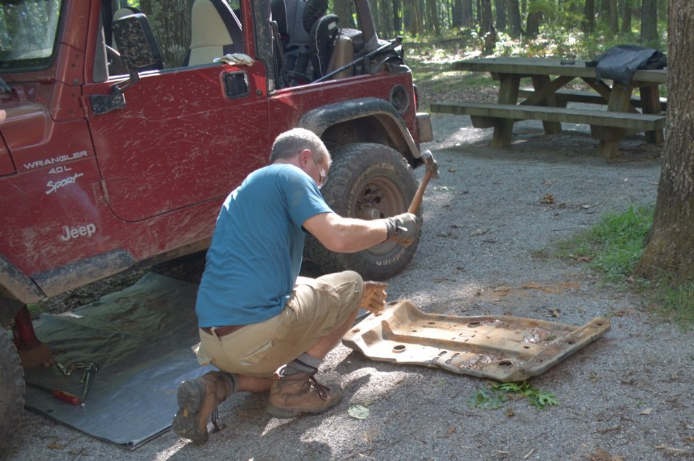

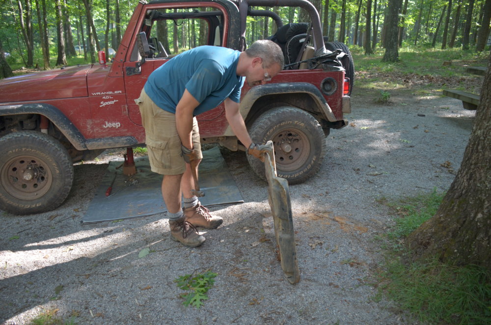

I back up, check the belly, and find out that I've kinked the front lip of the belly skid into the bottom of the transmission. I spend the rest of the day listening to the transmission bang on the skid, while riding winch rope and taking the easy lines, instead of impressing the ladies with my mad skills.
Back at camp, I get to fix my mistakes so that Mama can drive her junk back to NC on Monday.

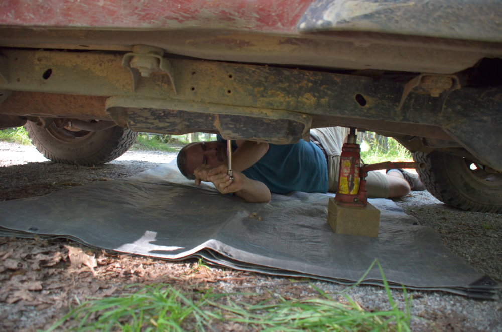

This'll just be a minute:

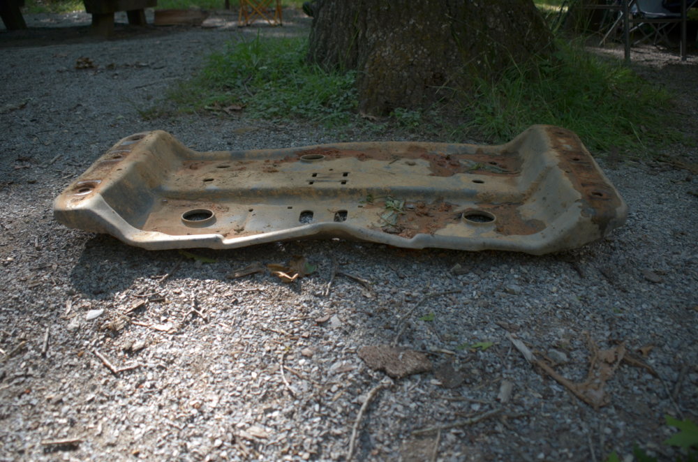

I really don't see what the big deal is:
I'm sure that's not important:
A ball peen fixes all. The good news is that my hammer-swinging couldn't be heard over @CasterTroy 's generator:
Good as new.
