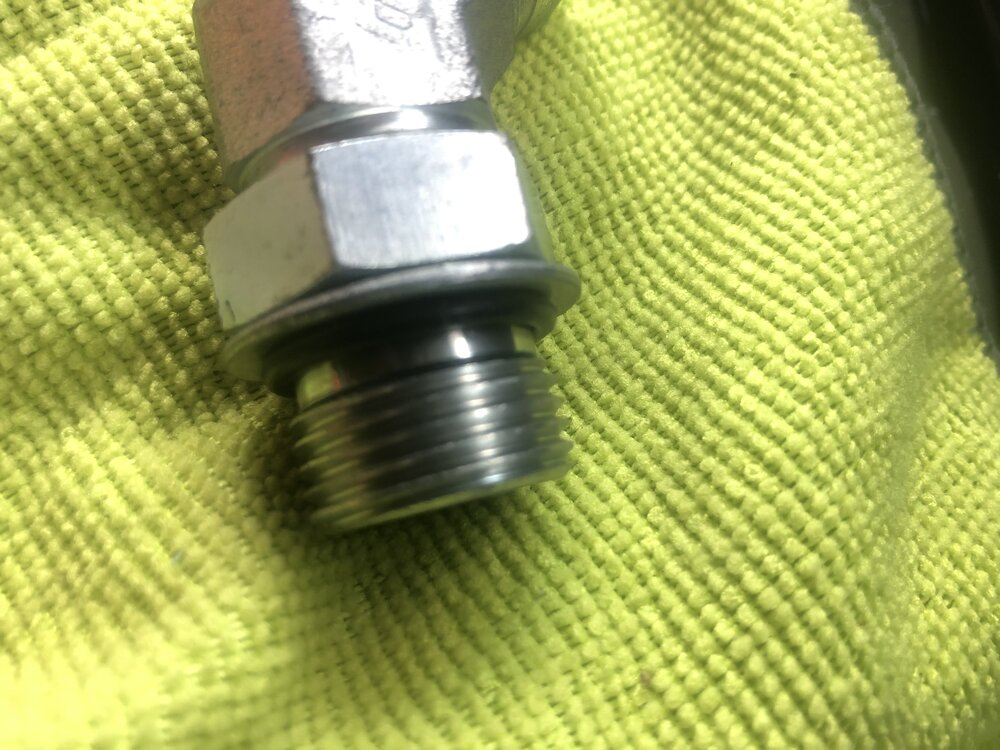

Normal Hardware store stuff won’t last long enough in a hydraulic application, using the correct seals for an o-ring face seal will probably cure your issue, but if at all possible, replace the fittings as well, the washer that presses the seal could be distorted, you may not see it, and that’s all it needs is the ununiform fit to blow out.
Your fitting look like this ?

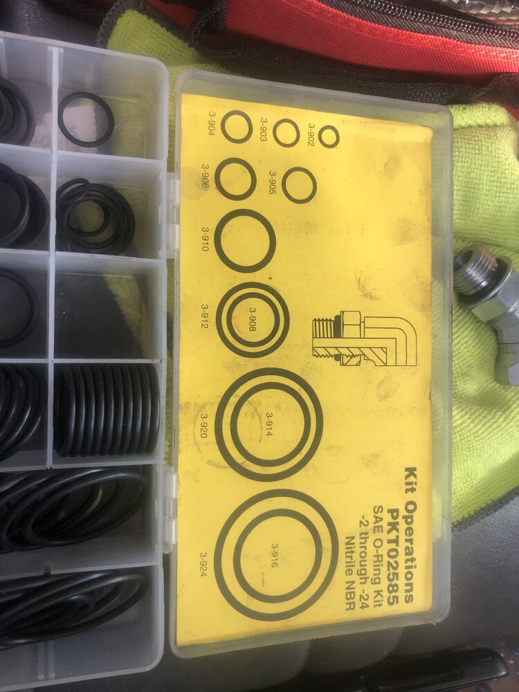

Go to your hydraulic shop and get a kit like this. They are a higher durometer rubber than standard oring kits
