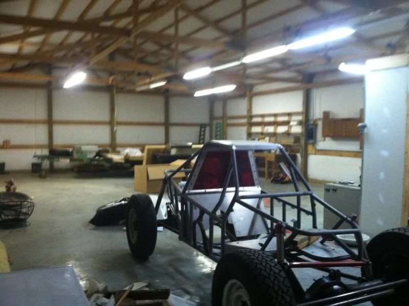

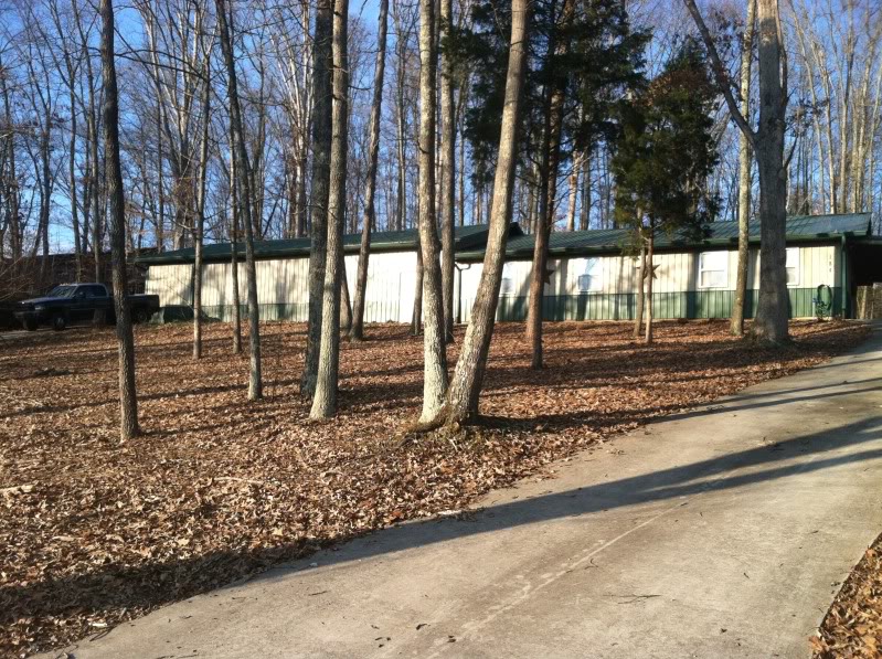

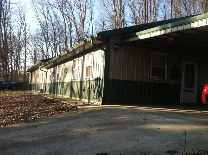

It's a 30'x100' pole barn style building. 30'x45' is living area with 2 (possibly 3) bedrooms, 1 bath, full kitchen, and living room. The shop area is 30'x55' with 10' eaves, ideally I would like taller, but I can deal with it.
You sure its 30' wide? To me that looks like more than 30' of space on the width, but I could be wrong.
Yeah, I guess the ceiling height is messing with my perspective.
