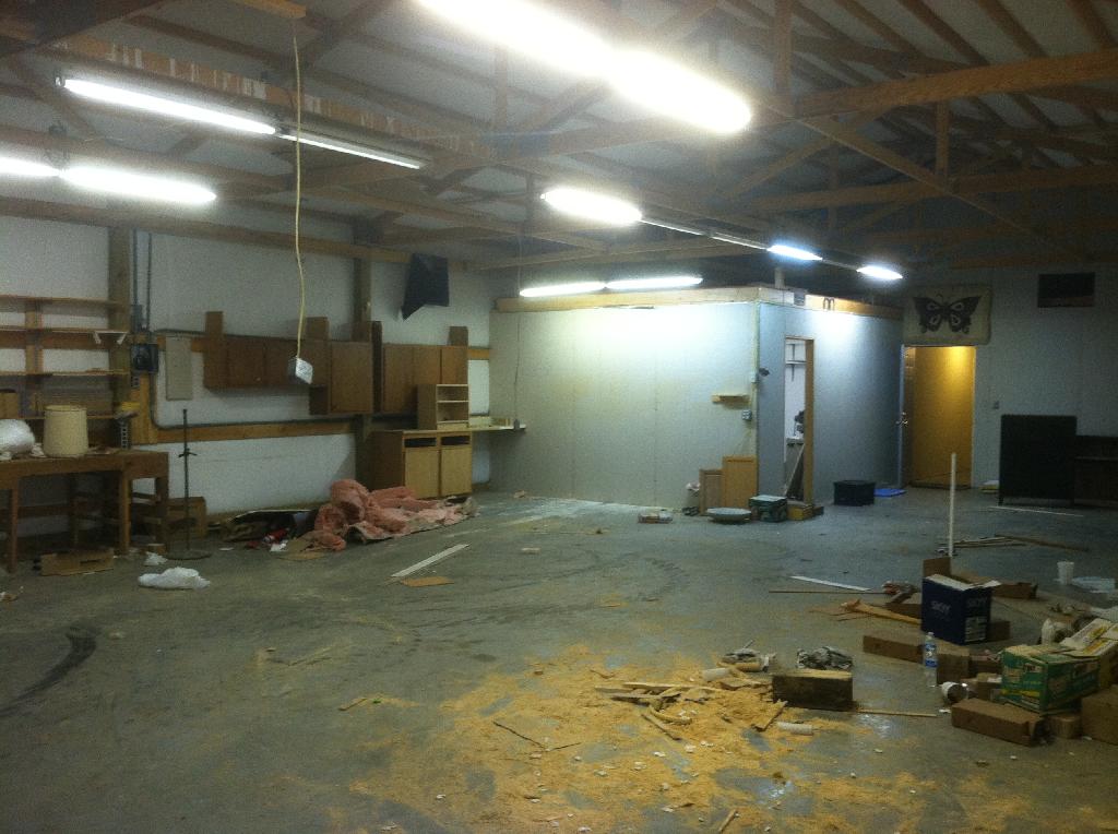

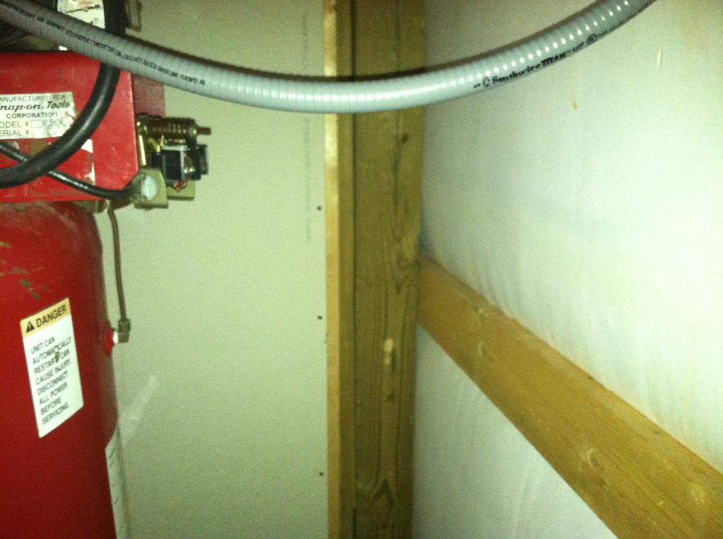

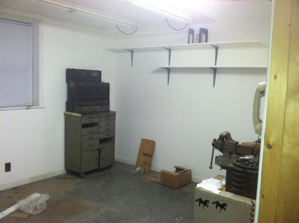

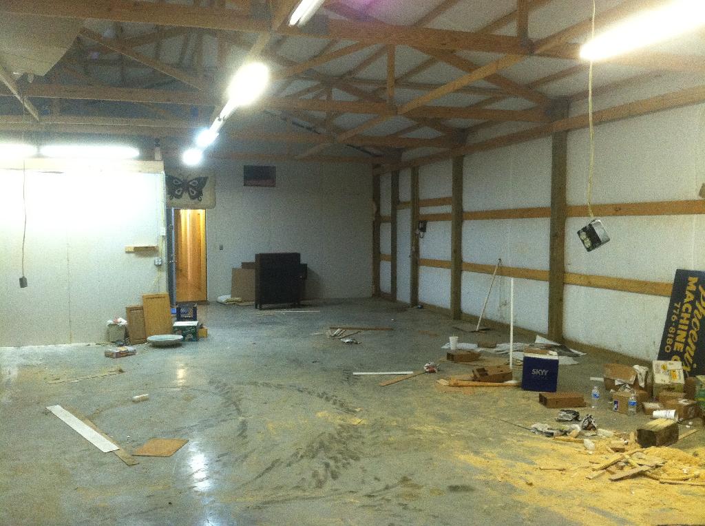

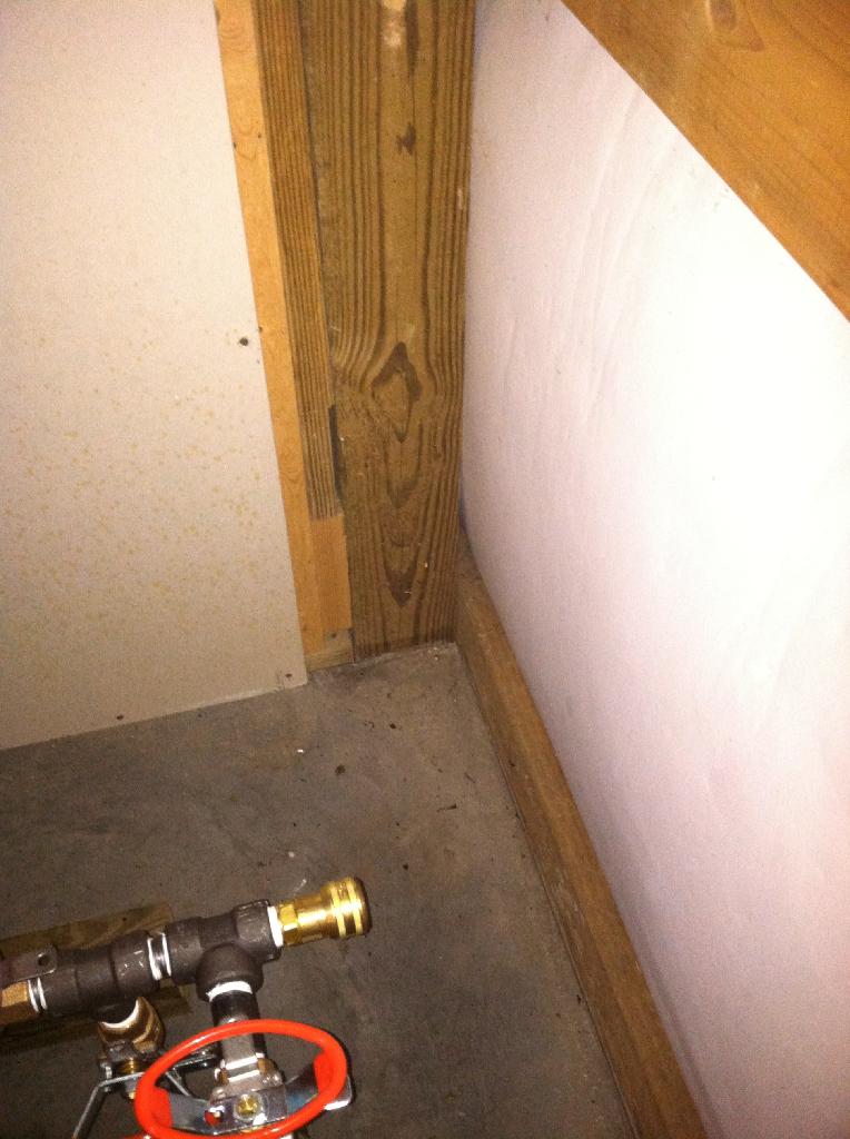

@Hokie_YJ : That's badass! Will you take some more pics for me? Particularly, inside the shop and looking back towards the house. Maybe some showing how well the framed walls meet up to the insides of the building. Are the floors framed up or just like a slab house and flooring on the concrete? Is there anything above the house? Attic space or a loft or anything?
Here's a few pics I took when I was doing the walkthrough before I bought it. I can get some better pics. Ignore the mess, and the awesome butterfly rug on the wall.

It's just like a slab home with the floors on the concrete. Actually the living room, hallway, and my bedroom are still just concrete. It may not be pretty and fancy, but neither am I.
There is an attic area above the house part. It has lights, but it's not floored. I may eventually rip some sheets of plywood and floor part OT it. The little opening to the right above the door in the pics goes into the attic. The eave height of the building changes at the wall between the house and shop. The house is 8' and the shop is 10'.
