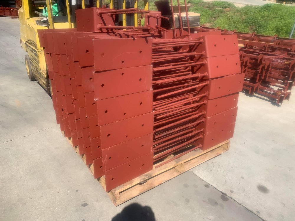

R&R also makes/sells these wet set collars that dwarf the simpson collars for not much more money...

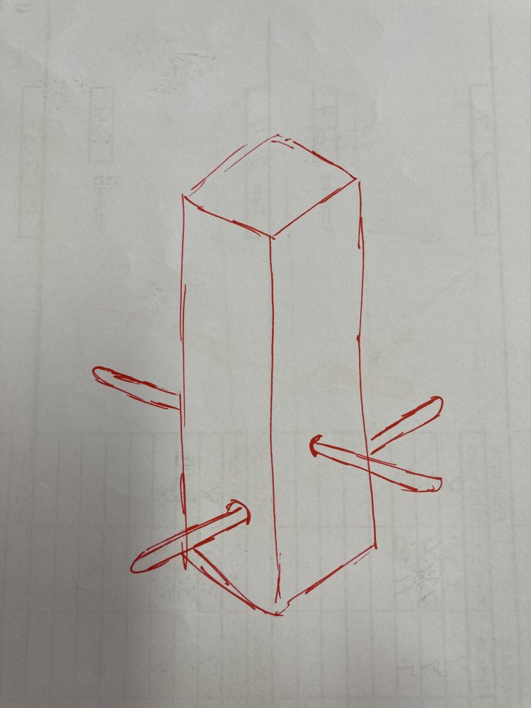

Excuse the crude drawing, drill holes and run bar through. Set pole and then pour concrete around it. I am more concerned with the poles twisting when they dry out but would also help keep them
From pulling out
From pulling out
