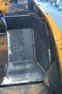

Cj5's are known for having no leg room, so we decided to do a little massaging on the fender wells. I was able to make room to move the seats back an extra 6 inches or so if needed. I was also gonna leave the fuel tank under the drivers seat but the customer decided to go with one of the spun aluminum fuel cells in the back so when that comes in I'll shoot a few pics of that all mounted up..
Before
After.... Still got a little more grinding to do but you get the Idea.
