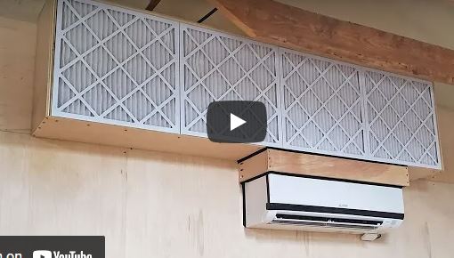

To your and Troy's point. I wonder if adding filtering material would change the life expectancy of the equipment? I know that the fan would have to work harder to pull air through.
Im thinking, what if you built box around the indoor unit that was essentially just air filters?
