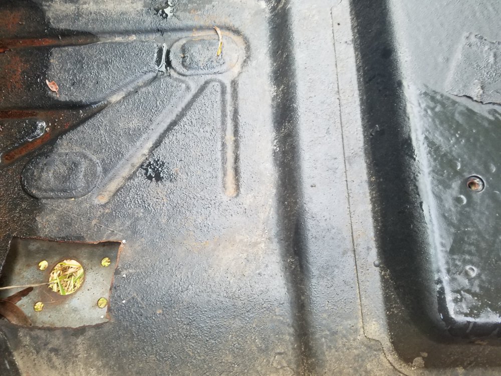

The texture is entirely up to you. If you just roll it on it will be very smooth. You have to wait a few minutes for it to begin to dry and then roll it with a dry roller to get texture. I cant comment on it's durability much other than i have pulled the roll cage in and out a few times and has not chipped, gouged, or scratched. Sitting out in the weather for over a year has had no effect on it. I have also plasma-cut through it and the coating around the cut has not peeled or anything like that.
kind of a crappy picture but hopefully you can see the texture in the floor pan and smoothness under the seat and the hole I cut through it. It has not rusted through like it looks just a bunch of grinding dust and media from the blaster. @jeepinmatt
