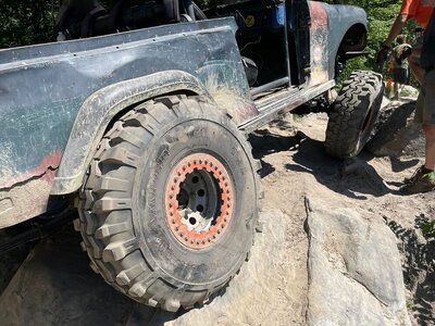

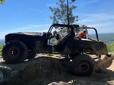

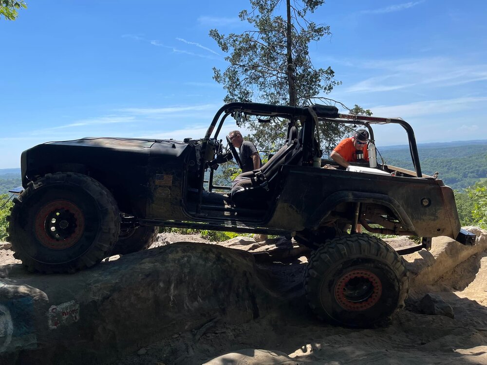

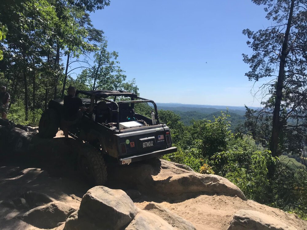

The majority of pics from the shakedown...
It's working well, like a whole new world with some decent sized tires and ground clearance.

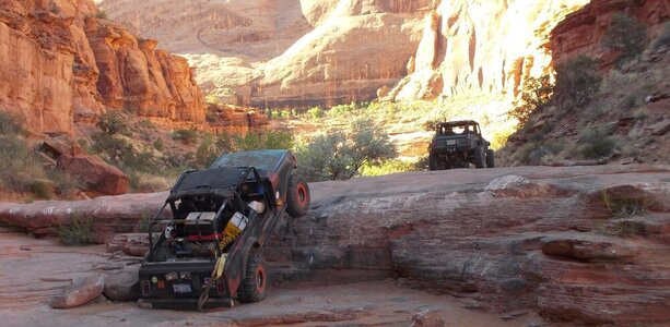

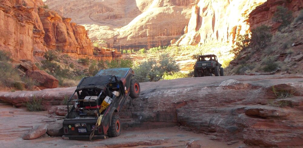

Like what brother? Have a few zillion from the past 21 years (all on 33"s) 🤭, but here's a couple of my favs...
Inarguably, one of the BEST days, of the BEST weeks I've ever had wheeling... Moab 2017 in Pritchett Canyon

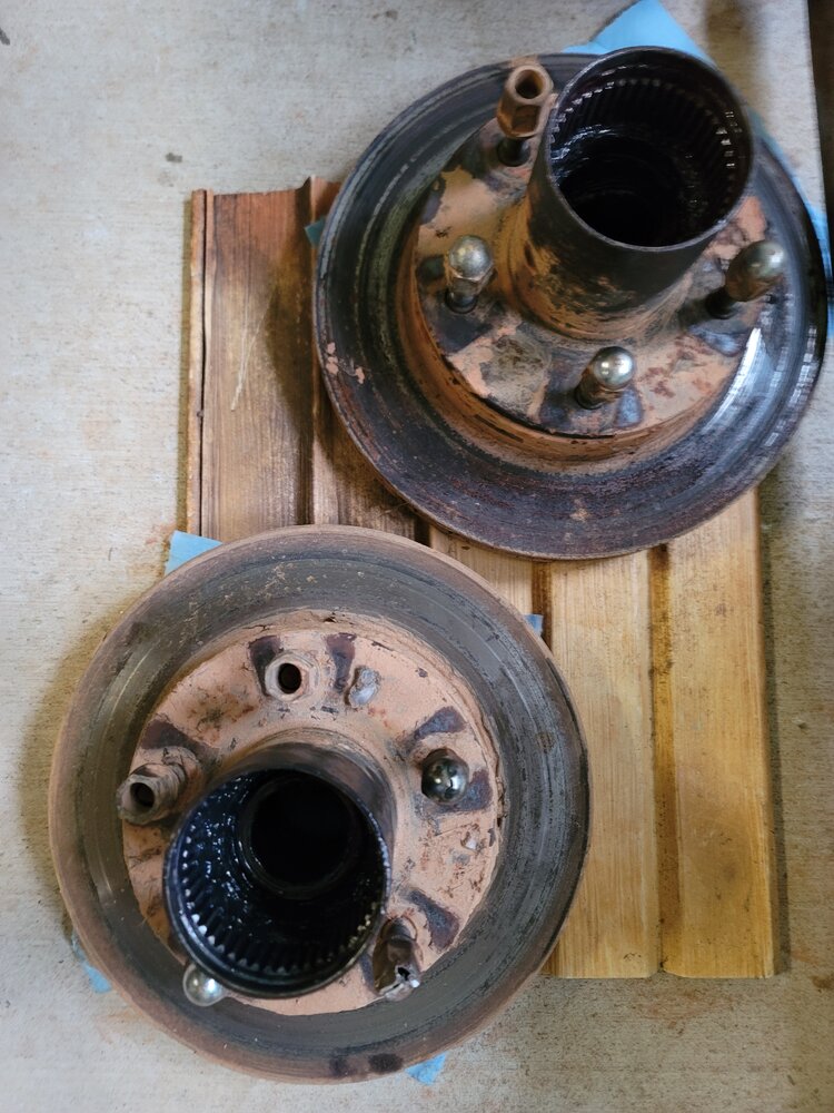

Finally found a pair of Ford hubs locally (rotors are smoked). Need to get them cleaned up, so the inner bearings can be used to size turning the OG Waggy spindles (apparently "large bearing") and order new rotors/studs...
You need the small bearing spindles? To convert jeep/ Chevy to ford outers (D44)...
I have a set here if we find a way to get them to you
While it may come to that, my understanding is the only difference in the spindles (large vs. small bearing) is the OD where the inner bearing rides, correct?
If so, have 3-4 options for getting mine cut down a bit... otherwise will see what I can do to take you up on that set!
I dunno if the seal seat is different or not. But yes the inner bearing is the main difference
There could be that 🤣
What would you be asking for these small bearing spindles? (feel free to PM if better)
If the transport is needed, I can pick them up from @Black Bear during the week and drop them off when I’m in Claudville one weekend

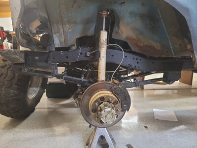

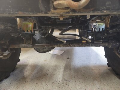

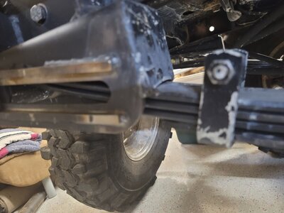

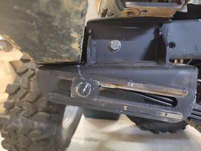

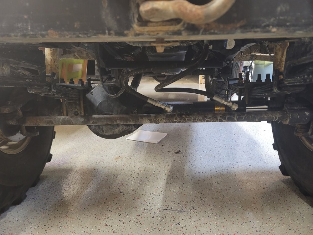

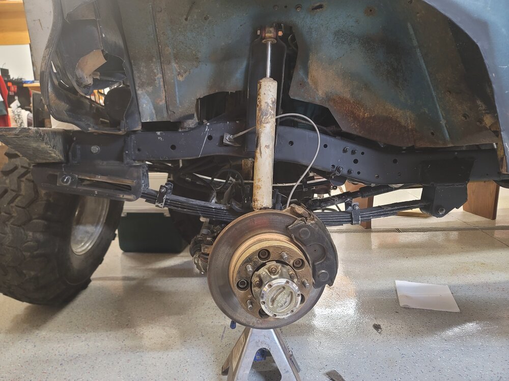

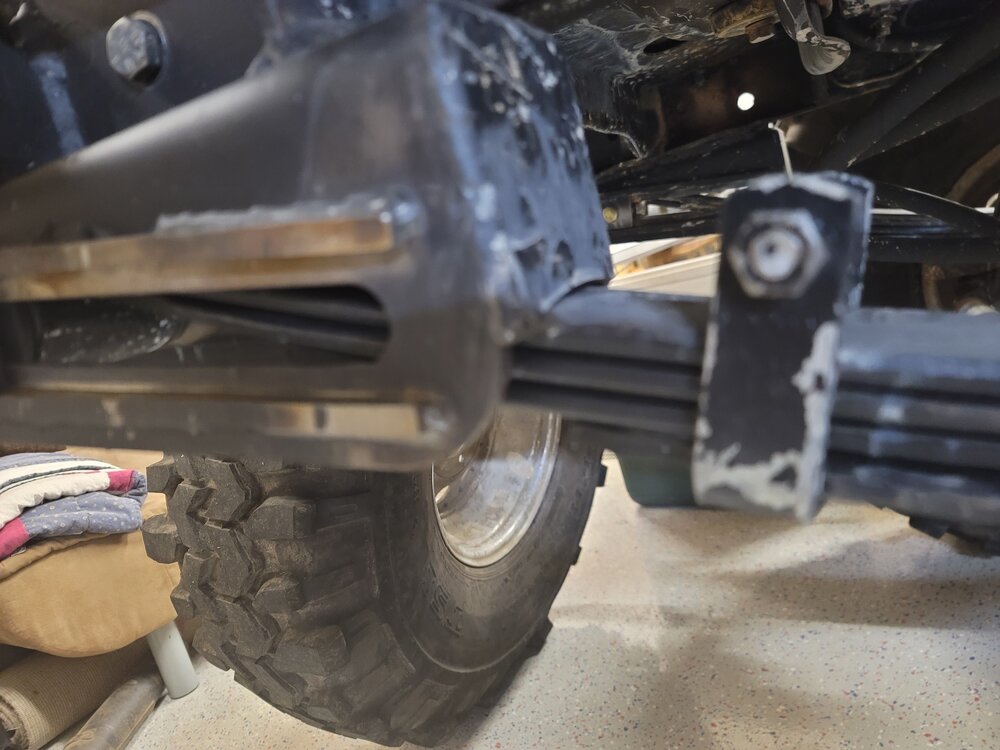

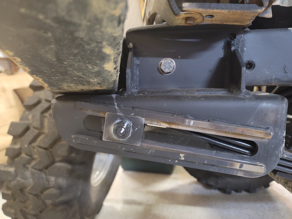

I'd love to see more pics of the front with the leaf sliders and how the steering is packaged, how much space you have for uptravel, etc.
Good or bad, uptravel is in the 4"-4.5" range... the spring would be inverted/shock bottomed at that point. Down travel is in the 6"7" range.
Astute viewers will notice the backend of the slider is close to/touching the leaf and needs to be clearanced a bit before the Veterans Ride 🤫
AND while it *looks* like there's not enough travel left in the slider, I measured eye-to-eye FLAT length 20× and added 3/4" before they were burnt, with 2" left currently.
Steering placement is OK (vs good/great given the hi-steer arms aligned perfectly with the leafs 🙄) but it's fairly protected and works effortlessly.

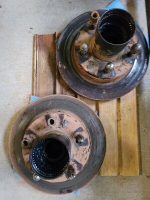

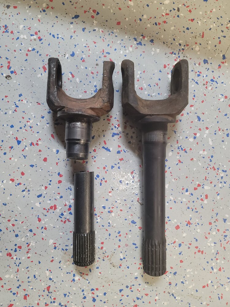

Tonight was replacing the D30(Scout44) Cromo that was writing checks it's arse couldn't cash! (pictured with 19spline 1/2-ton cromo livery)
