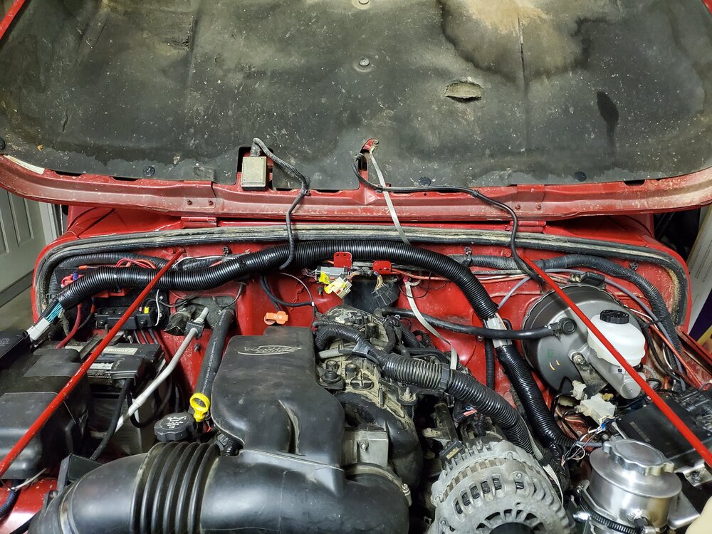

It was registered, titled and insured in NC. Some of the process was complicated, some of it was easy, but it passed all inspections with the LS1 in it.

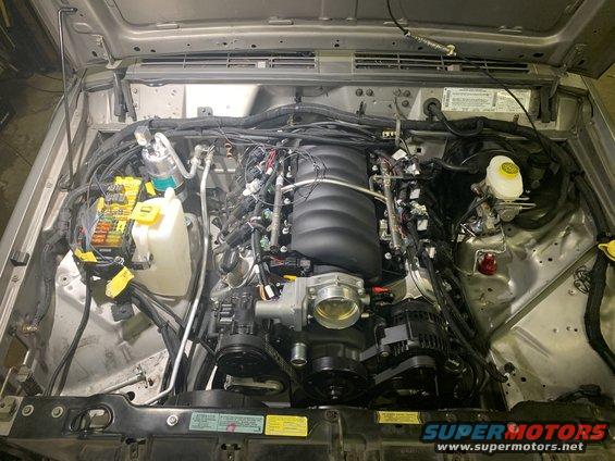

Hmmmmm, I have a 2000 XJ that I am putting an LS in and am almost done. Will keep you posted on any issues I get when I get my tag. I already titled it in my name but no tag. I used the Holley Terminator X Max software. I removed all the factory computers and wiring so no OBD2 port. I live in Alamance county we only do safety inspections.
