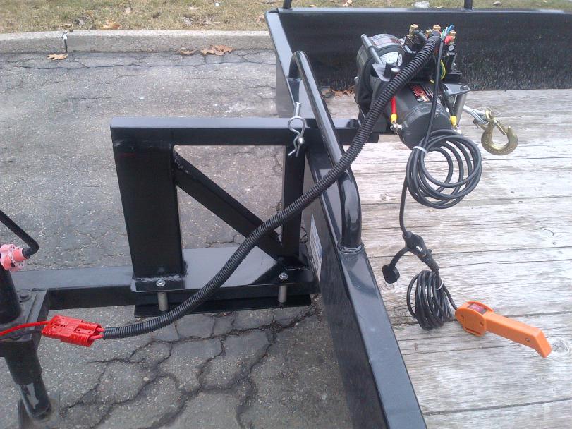

This is a crappy picture but this is something like I am thinking. This way the winch is not always on the trailer. Only probably I have is I have a 5 ton jack welded right to the center of the front of the trailer (on the outside), so this type of mounting won't work for me.

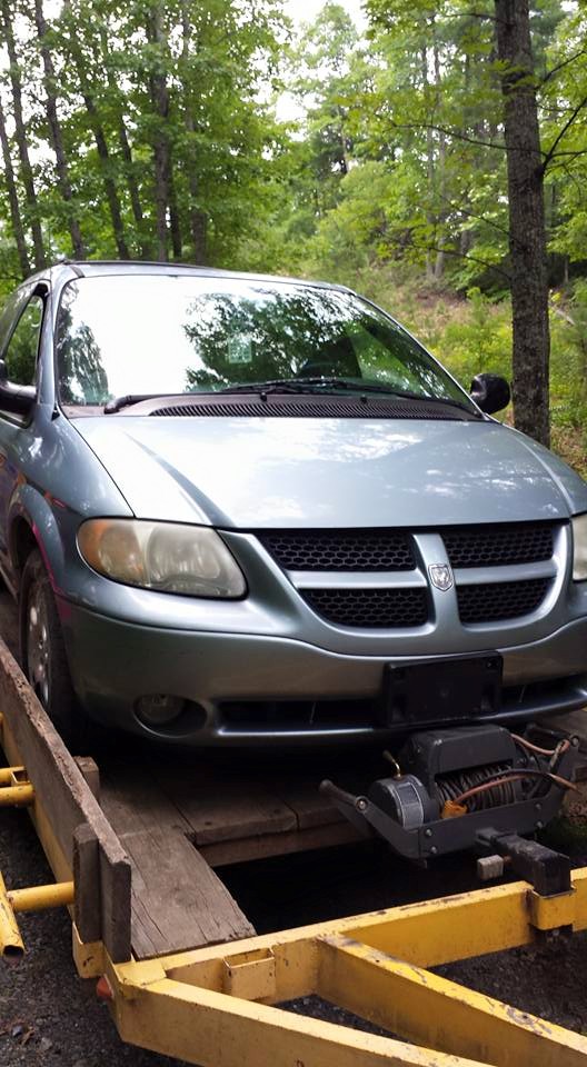

Good point, didn't think about a car, was just thinking about my jeep.
this
What if you make the winch mount on a post and weld a receiver tube vertically at the front of the trailer. Think of a hidden gooseneck ball when the winch is removed.
