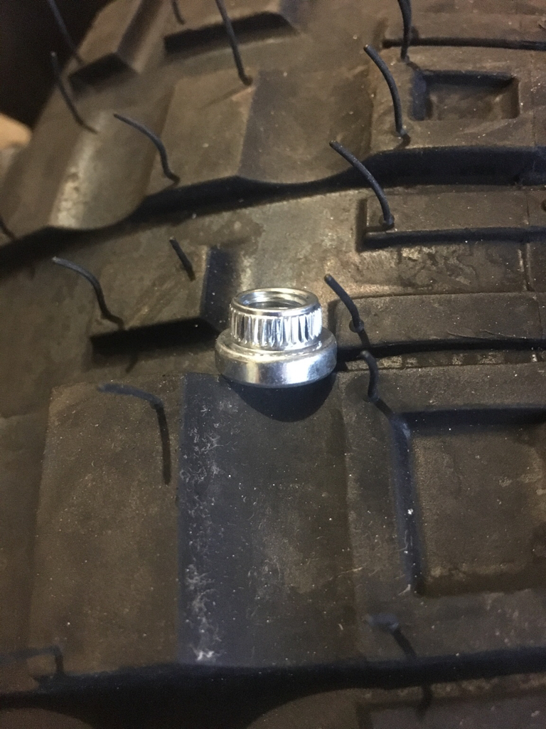

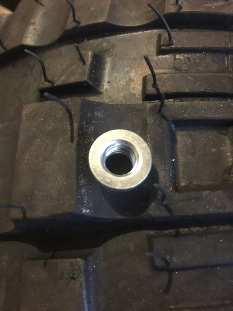

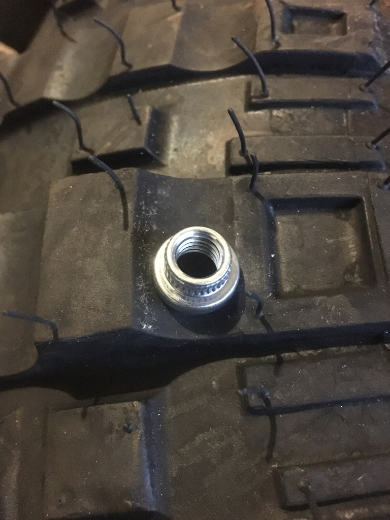

Just found two of these in the envelope that the bolts came in (two per wheel). Are these for screw on valve stems? Are these to lock in two of the bolts?
-Deleted-
EDIT: Nope, they're spare inserts for the 32 threaded holes in the wheel. And yes, they're a press-in part, looks like they're likely a PEM part. If that's the case, they're probably made in Winston-Salem by Penn Engineering (I use a lot of PEM parts), which is the best out there and just happen to be an NC company.
Ahh, cool, so nothing I need to install now?
You can get a full set (per wheel) for $15 from the wheel manufacturer, that's how I found out what they are. They're listed in the accessories area on their site.
