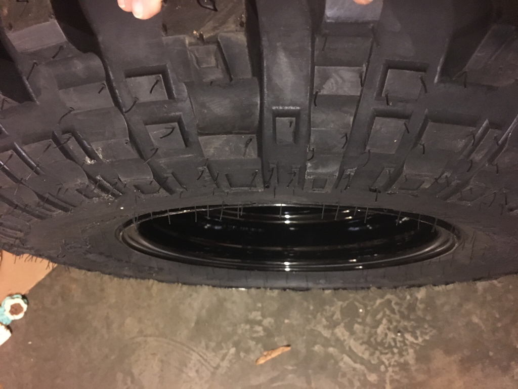

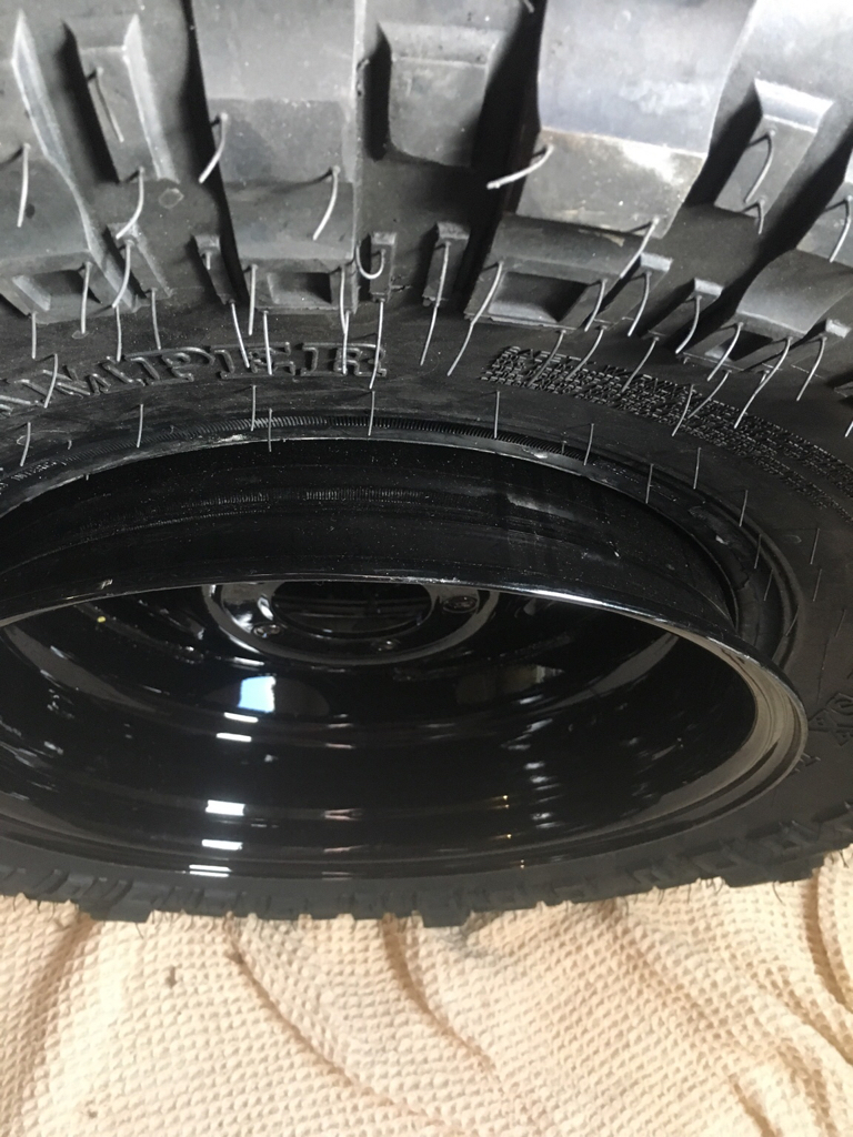

Ok, ok, ok, I may dumber than a box of rocks but I need help. I am trying to mount tires on my very first set of bead lock wheels and I need help. I got the inner bead on the wheel, and then I started to question myself. I decided I needed to get the outer bead on the wheel too, but now I am thinking I messed up.

Here is where I am right now, tire is inside both lips of the tire
Pull the outer part of the tire over the lip of the wheel.
Yes, pinches. The lack of a proper bead profile on that outside edge (because it pinches the bead instead) is what makes them not DOT legal and therefore not street legal.

The beadlock does pinch the bead. You will need to pull the outer bead back off and center it on the lip of the wheel and then bolt down the outer beadlock ring.
Thanks guys, I should have gone with my first instinct, now to try and pull the front bead back off

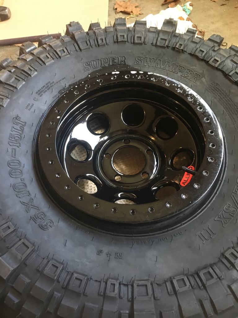

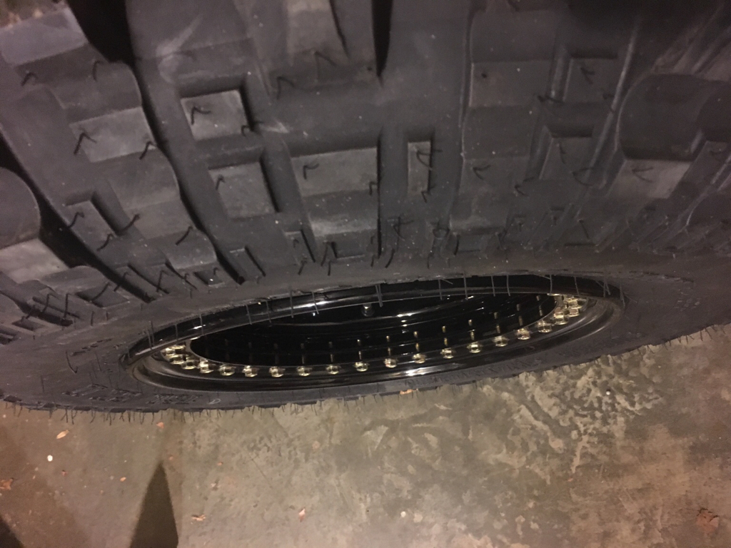

Yeah I thought they were flat rings on the first post. Very nice! Now I get to see how those tires will work before I need to buy new ones. :) Can you get a side view of the tire on the wheel. Curious how much the sidewall pokes out.
This is at 7psi and obviously bot on the jeep yet.
