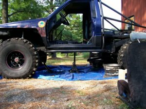

well since I dual cased my rig I've been bothered b/c when I cut my second shifter "square" it was all crooked. As small as this sounds it has been driving me nuts LOL. here's a pic of my day and what I did to fix it. Will finish tomorrow.
not even square...lol
my exhaust fell off? maybe?
that's better :D
hahahaha
BWAHHAAHAHAHHAHA

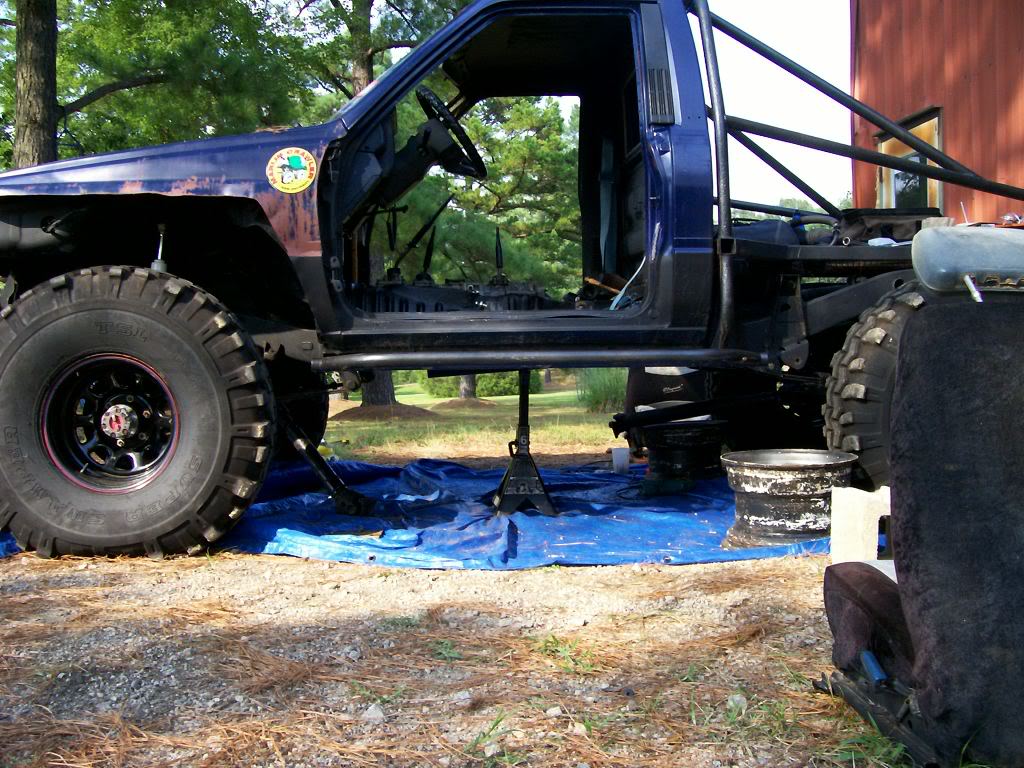

spent most of the day measuring and trying to conjure "how" to do this under the reg. cab space constraints. this should work just fine. I'll finish it asap with some more bracing and sheetmetal. updates soon I hope.
thanks, I need some vynil yota seats. no harnesses I just want to relocate the lower seat belt mount.
I have a lot more sheet metal welding to do but it is wheelable right now. :driver:
Man that thing looks great. I've been thinking of doing that kind of floor job on my runner. Did you just flat plate with bushings on the stock yota mount minus the molded rubber like some of the formula toy guys? I'm running the front range offroad hy clearance member with my cases against the bottom of the floor board, it made massive amounts of clearance over stock, but I like your rig better. I'm doing a dual case install for a friend using marlin adapter and a allpro XXX crossmember with the parking brake kit. I'm putting 5 inch springs with 38s on it but it already has a 3 inch body that he is keeping so I can really shove the crossmember up on it. I really think it is going to sit way to high but it's not my ride.
I have a 3 inch spring lift and inch shackle lift on my runner (with a 1 inch axle move fwd) how much do you have to clear the 38's? I couldn't clear my ram and hy steer setup with any less lift. my 38's measure 35.5 ish with 8-9 psi on 8 inch wheels. Anyway props man that thing looks great.
my susp. setup is about 3.5" lift total by RUF with skymfg. hanger (axle 3.5" forward) and marlin 4.5" shackles. and 04' tacoma doublecab rear springs minus the o/l + a 2.5" long AAL.
I am running the SKYMFG dual case skidplate with some homemade spacers I made
fenderwells are tubbed back to the body mounts and wheels are 2.5" BS 15x8's.
thanks for the compliments and your rig sounds pretty sweet btw. shoot me some pics via pm if you can.
