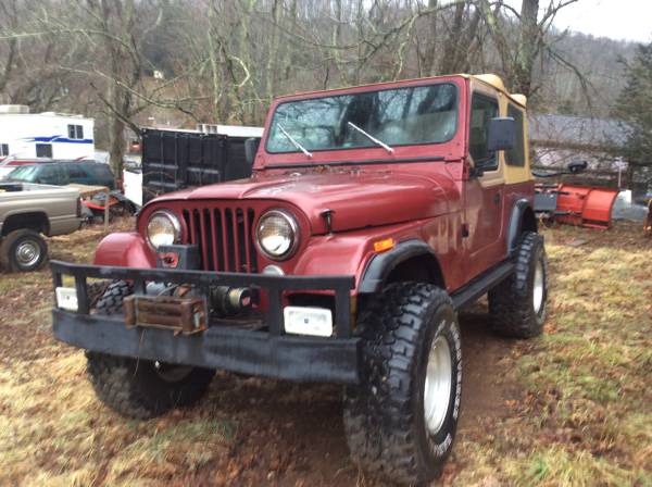

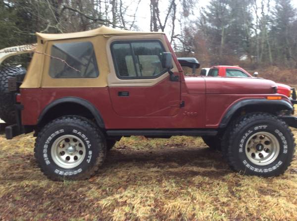

Picked up this CJ-7 as a project.
The Good:
AMC 304
Manual Gear Box: 4 Speed
35" Tires
Custom Front & Rear Bumpers
Custom Running Boards
Limited slip rear
Front diff is locked (not sure how yet...)
The not so good:
Hardly ran when purchased
No Parking Brake
Ratty Seats
Battery not Charging
Winch not working
Temperature gauge not working
Fuel gauge not working
Interior dash lights not working
Rear axle bent (did not find this out till later)
Interesting lift kit
and the list goes on...

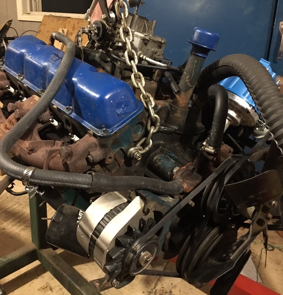

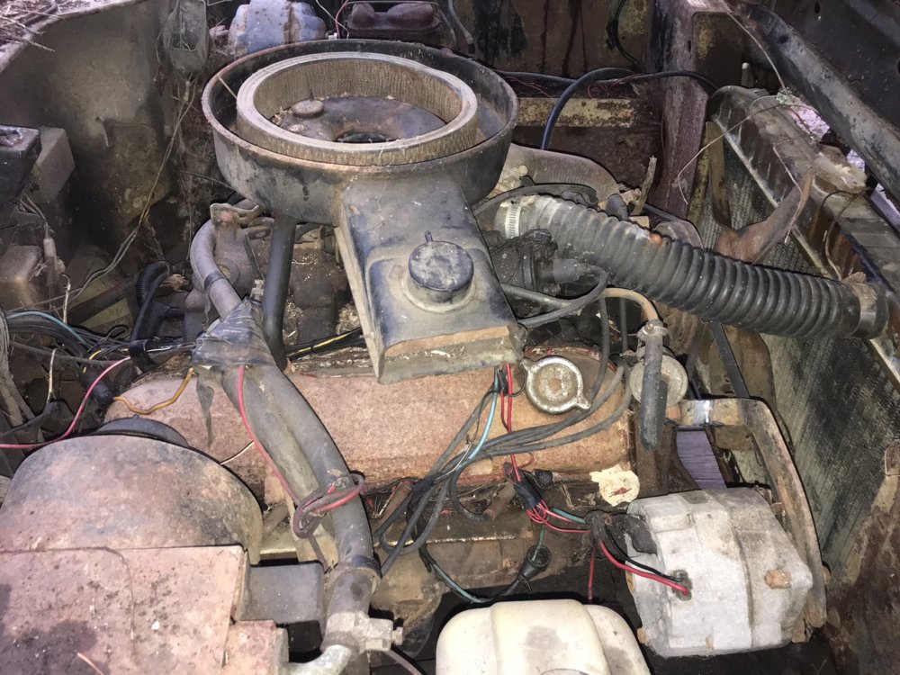

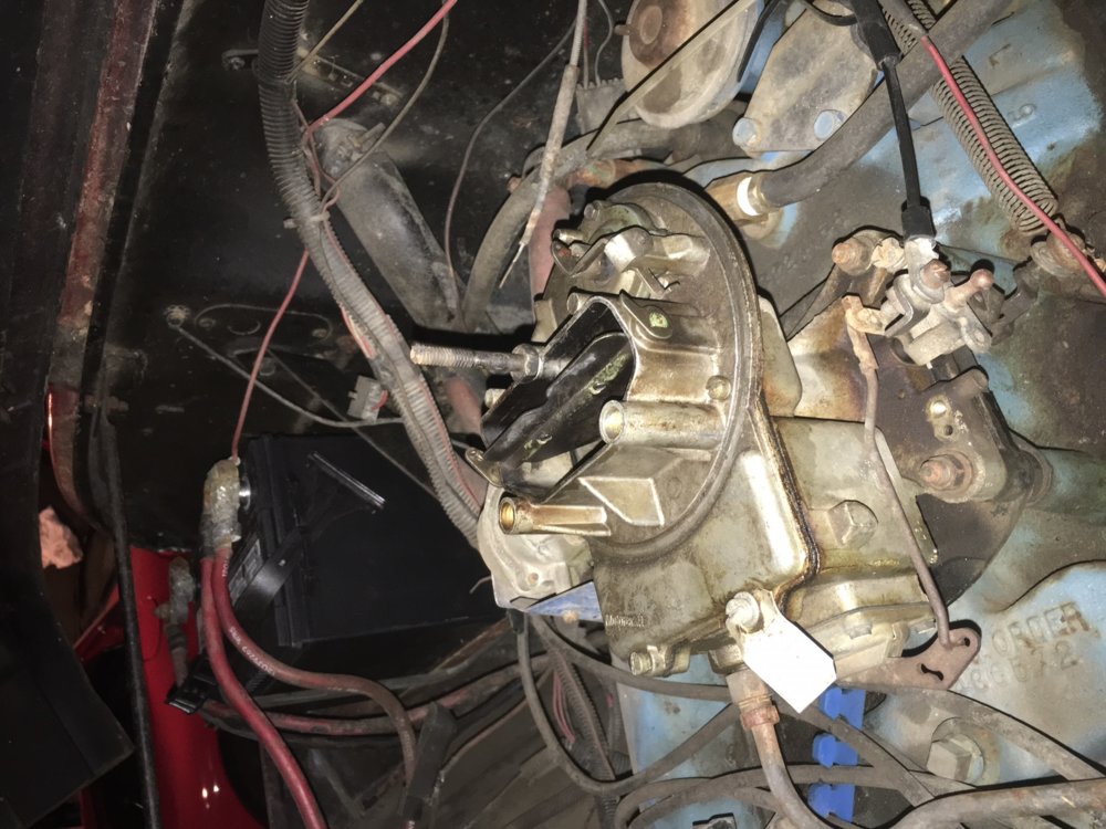

One of the first things to fix was the carburetor.
Off to the friendly folks at NAPA. They found the correct rebuild kit
I have never had much luck with a carburetors, but this one came out ok.
At least now the jeep would run.

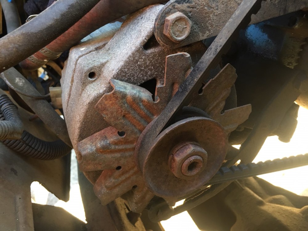

The new battery would not stay charged.
Old Alternator
A new alternator, some new wires, new connectors, etc.
Now the CJ is running and the charging system is working.

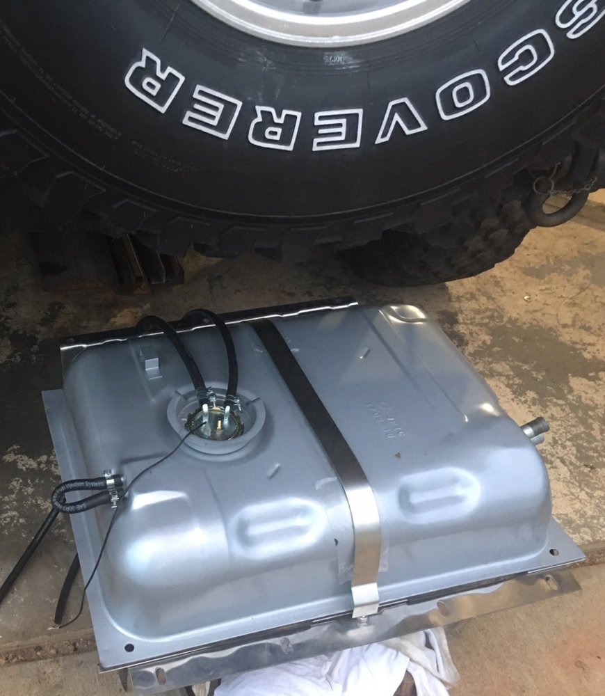

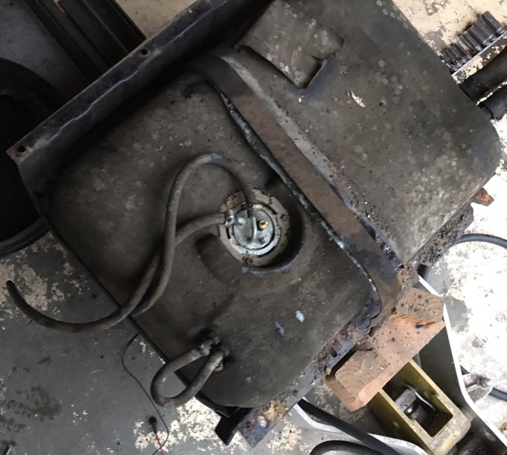

Returning home, it was noticed that the fuel was leaking around the tank.
An old ATV jack works really well to lower a gas tank...
Time for a new tank and a SS rock guard along with all new hoses and clamps
Man these jeeps love to chew up cash...

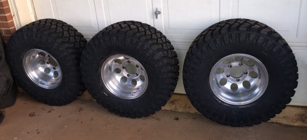

Talking with my local tire guy, Jason, about the 35's on the jeep.
We agreed that the 35's were OK for the street, but not for the trail.
Found a used set of rims. They were pretty nasty and needed a bunch of elbow grease to get them cleaned up...
Jason had a great deal on some off road 33's

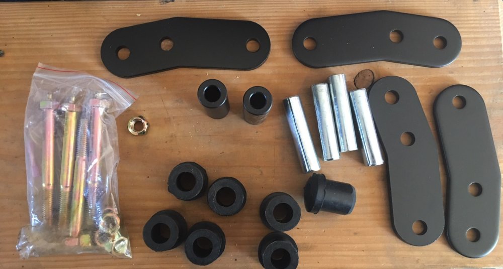

One day I was looking at the CJ and the right rear tire seemed to be a little off.
Maybe new bushings, shackles and shocks are needed...
We after all that work... some was still off...

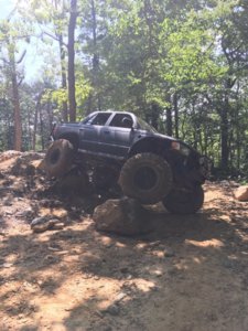

My son & I met Jason and his crowd early that Saturday morning. Jason's rig is this crazy beast.
That should have been a clue to what was to come later.

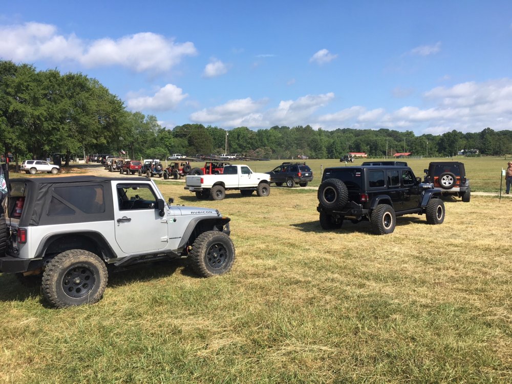

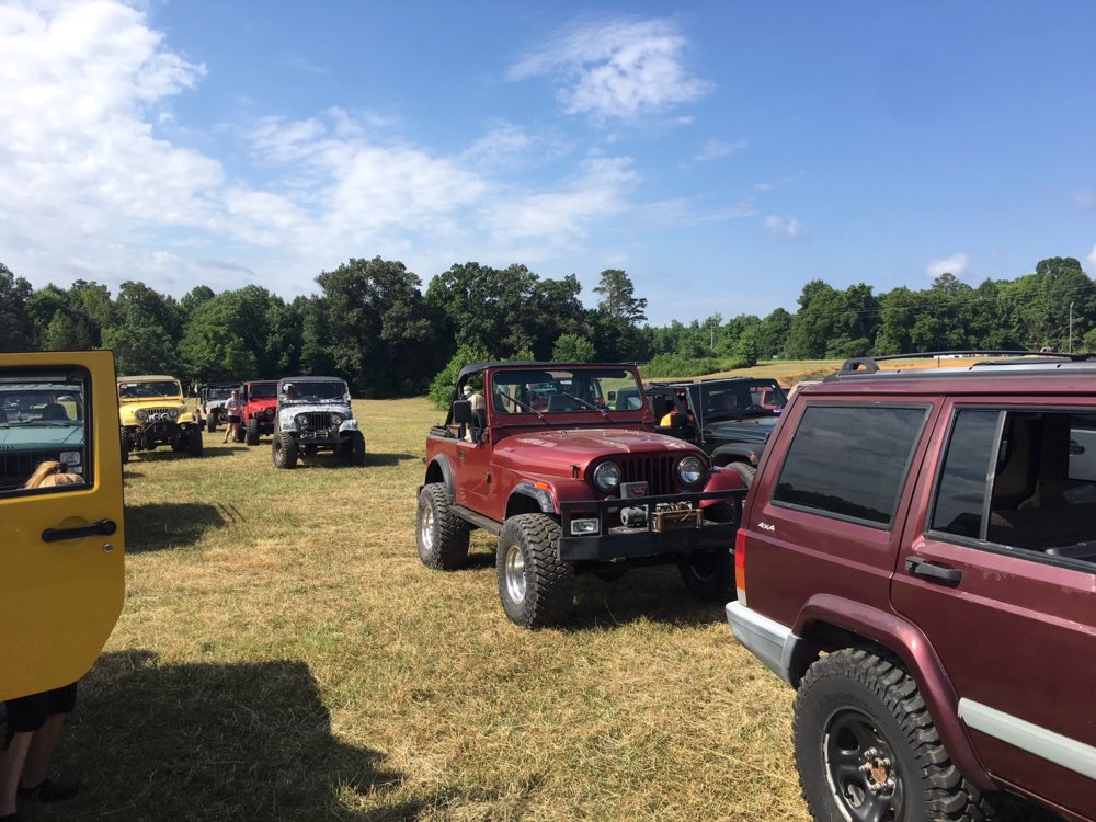

As we pulled into the starting area for the event, it was hard to image so many 4x4 vehicles of all shapes and sizes.
Jason said we should line up for the medium trails. I thought, sure, sounds good.
Of course I did not have a clue as to what was ahead.
So far, everything was great. The folks I met at the event were very nice.

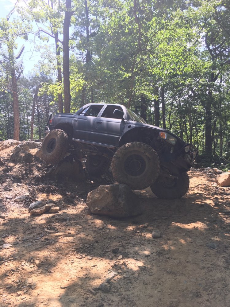

At the top, Jason found a rock to play with...

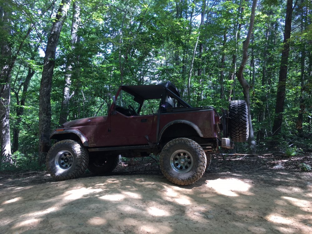

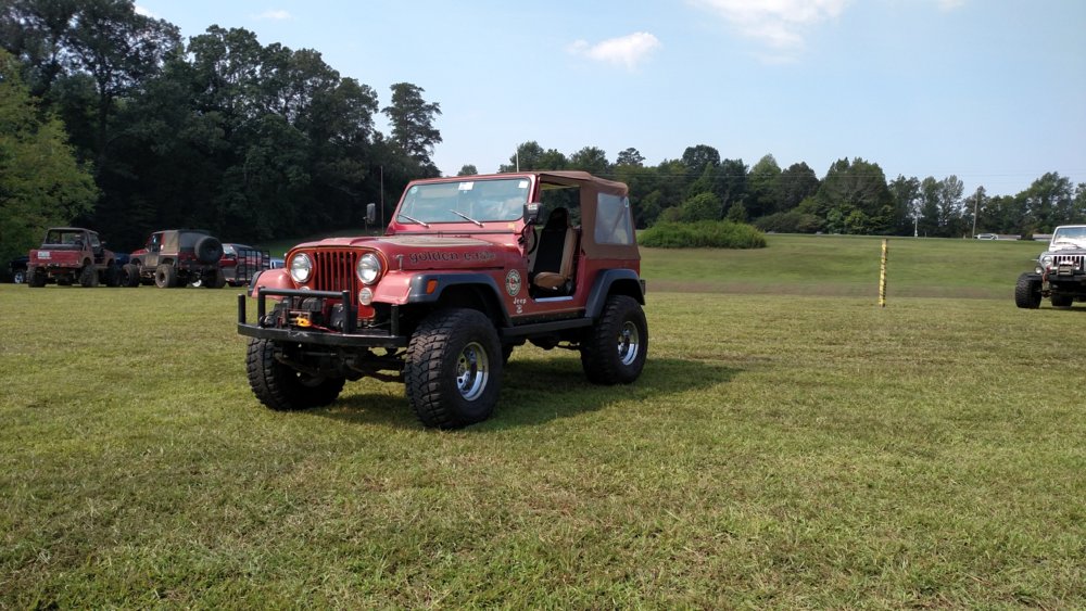

Glad you had a Great time. I saw your CJ there, as I "like" the colors, just didn't get to meet you. I ran with a different group. Jason is a great guy, & very knowledgeable! He's done work for me, in the past. As for your ratio's, & even engine, you probably know it's all been swapped in. Nothing wrong with that, I'm running the Same set up, in my 79. Jeep did offer several different ratio T-18 s. Some like mine are 6.32 low, but they had a 5 something too. Jeeps Love, Money$$$

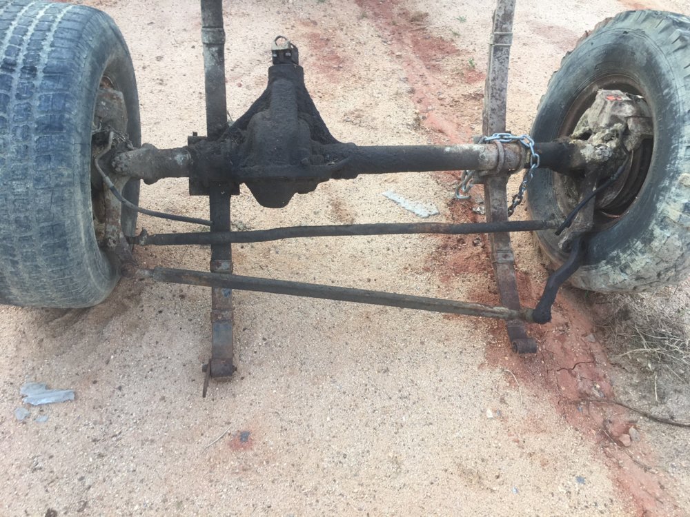

After Uwharrie, one of things I wanted for the Jeep was Dana 44's from a Scout.
Though not as tuff as Dana 60's, I don't plan on going crazy with this CJ.

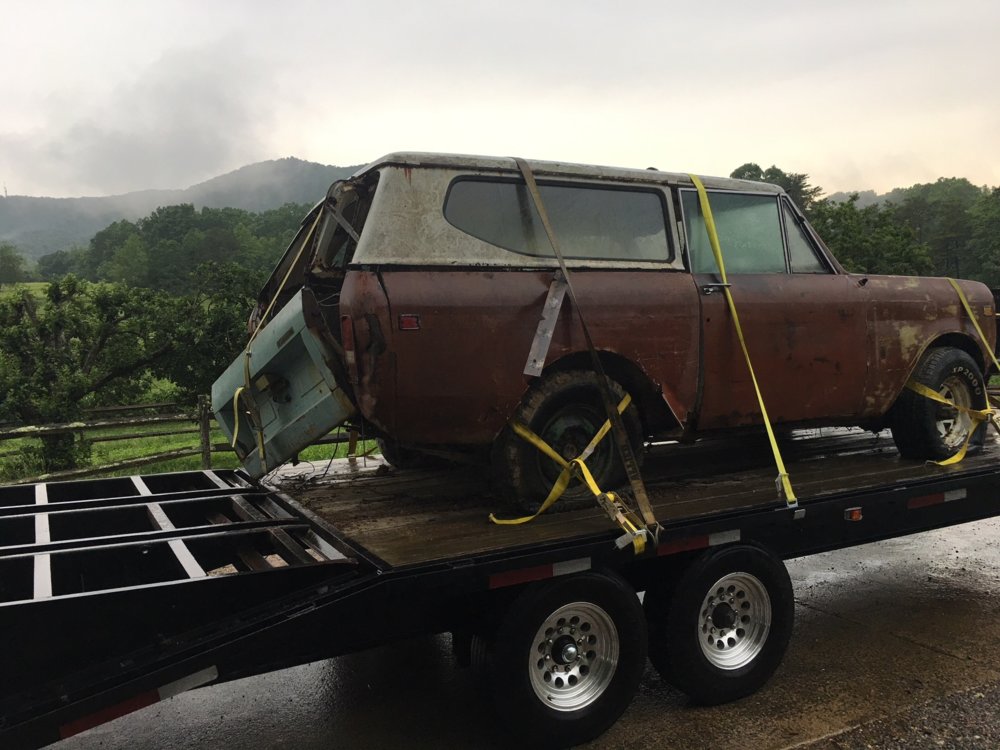

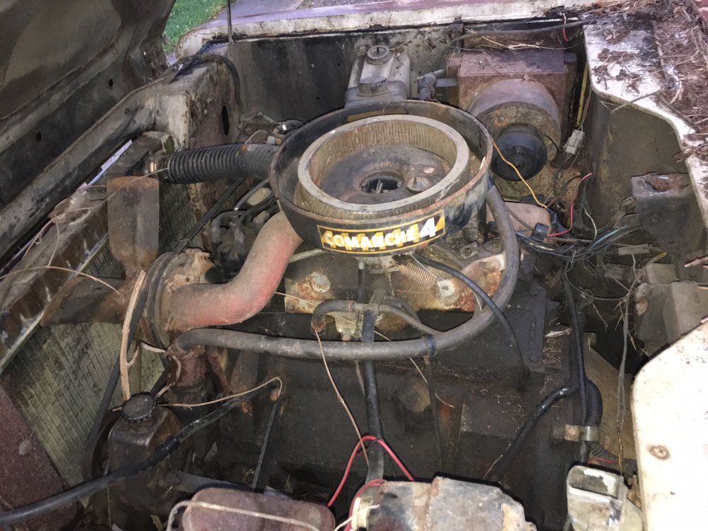

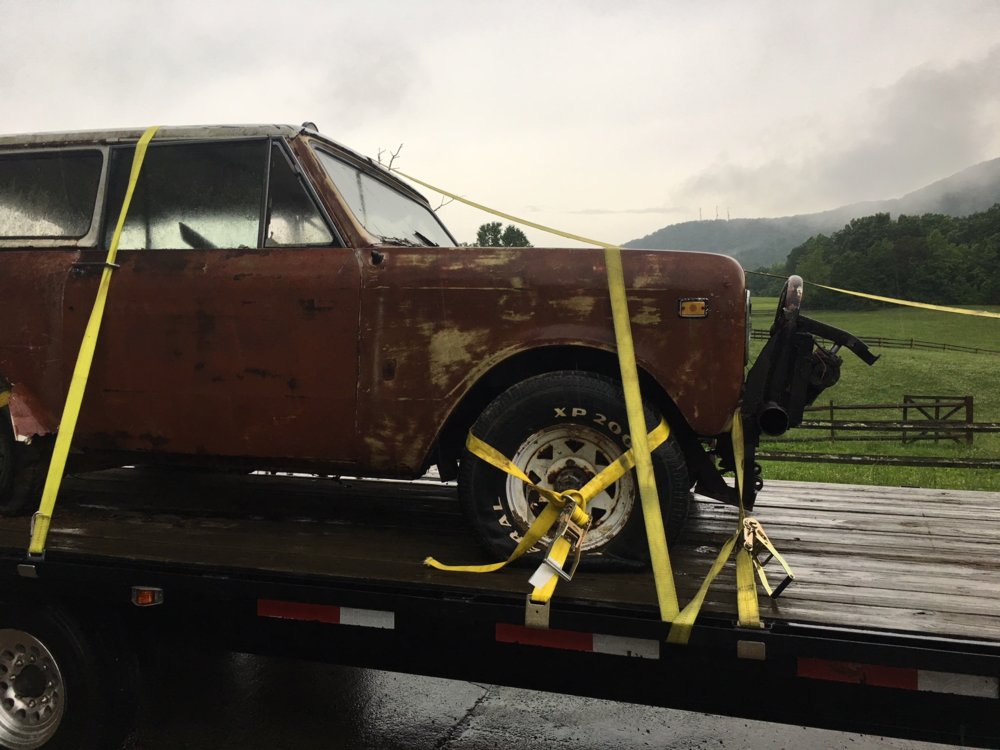

Found a very rusty Scout with a 196 motor that had not been run in ~20 years.
Not much left except the drive drain and a home made snow plow setup.
The frame seems to be in good shape though.
Learned that a 196 is 1/2 of a 392 motor. It is a 3.2 liter 4 cylinder motor. Crazy
When taking out the axles, found out they have 4.09 gears in them, as far as I can tell.
Now I have to figure out the best knuckle, steering linkage, hub assemblies to put into these axles.

I'll be at Potts! Lucky You on the 360! I'll soon be working on one. You should do a LOT of research on using the Scout axles. Can be done, but Not your best bet! Aluminum heads? No. Holly? A Big NO! Fuel injection? The new wave!

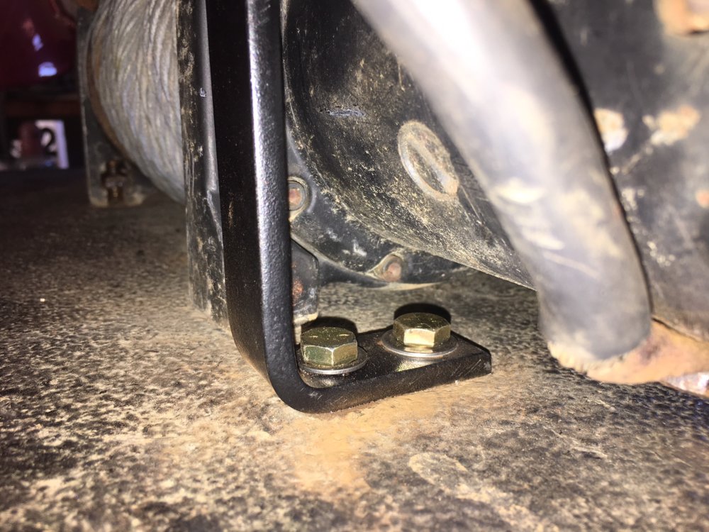

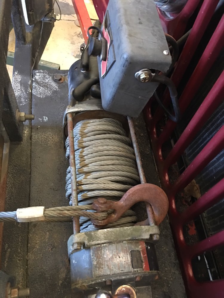

Did some work on the winch.
The winch did not come with the remote. Picked up a new remote; however, the winch would not work.
Found out the motor would work, but the solenoid relays were not engaging even when I applied 12 VDC directly to the relay terminals
About decided to purchase a new set of relays when I read that the coils for the relays are grounded through the case
Grounded the case that the solenoids mounts to and all the relays started to work.
Cleaned up the ground connections, tapped some holes so the ground connection would be better and all is good :D
That process took way longer than it should... but a heck of a lot cheaper than a new winch.

Buy a whole self learning fuel injection kit. Take the old carb off, put fuel injection on hook up 2-5 wires, set your parameters with the hand held and your done. Most are under a grand now. And stupid simple to use. Waggy axles would be a better option In my opinion, you can get narrow or wide and have a lot more aftermarket support than scout axles (they have it but scout stuff is money).
Wonder if I could use the scout 4.09 gears on a set of waggy axles??
I've got a bunch of research to do...
Don't mind going away from the Scout axles. I like the width, just a little wider than a stock wide CJ axle.
Based on my first trial experience, it was easier to get through stuff with a relatively narrow CJ, Just my $0.015 worth.
It depends on how hard you want to wheel it. There will be a time that it’s better to have wider axles.
@McCracken did have some j-10 axles idk if he has either of them now
Waggy axles are pretty much a bolt in less moving front spring perches if you keep same spring width and wheel bolt pattern. If I remember correctly, scout front axles are 0 caster and will have be shimmed or knuckles rotated in order to have drivability.
