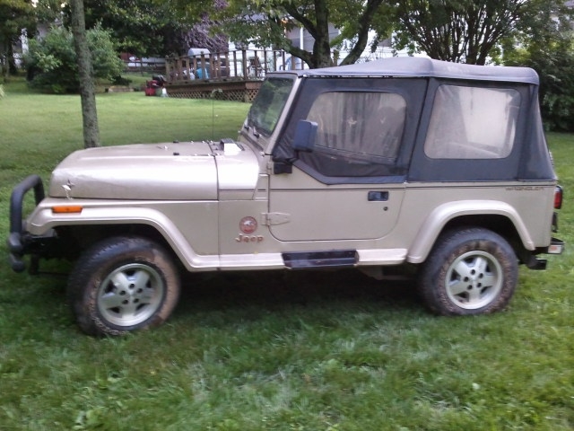

I sold my built yj once this little man came into the picture
because I knew that I wanted to have a more versatile family, camping, streetable jeep that I could drive to the mountains, beach, and to the trails that actually had a backseat!
I picked this up 2 blocks from my house!
147k on the clock, a brand new top and busted D35. I wish it wasn’t the exact color as my last build but for the price, I could not pass it up!

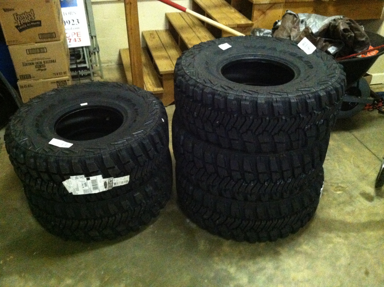

New 35” MTRs on 15x8 3.75 backspaced steelies

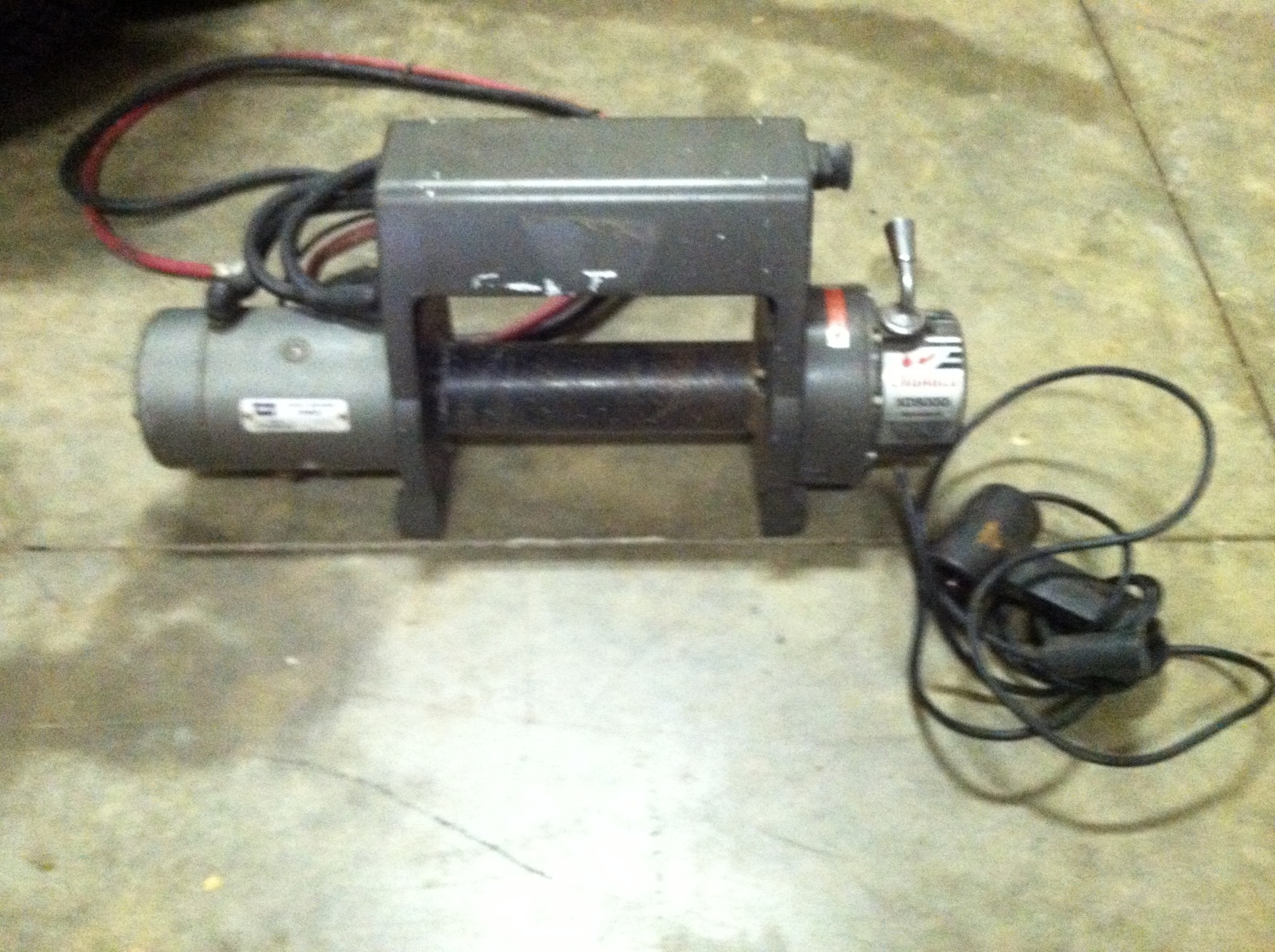

Warn XD9000 from another project.

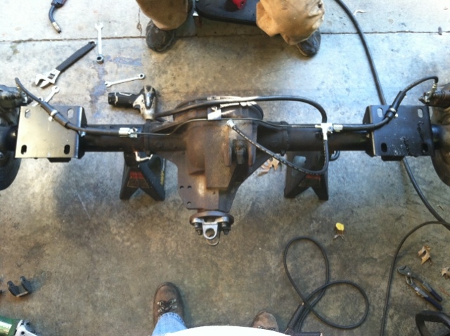

The rear axle is in, bolted up, and ready to go minus hooking up the shocks to the lower mounts. Front axle is in as well. I have to hook up the front brake lines and bleed everything. I still need to install the front driveshaft, front shocks, and still waiting on the rear driveshaft to arrive. A few small things such as bumpstops, etc and it should be ready for wheels and tires and A LOT of fender trimming!
Pics to follow.
I am still looking for a bolt on winch mount. Something simple yet effective. Any input?

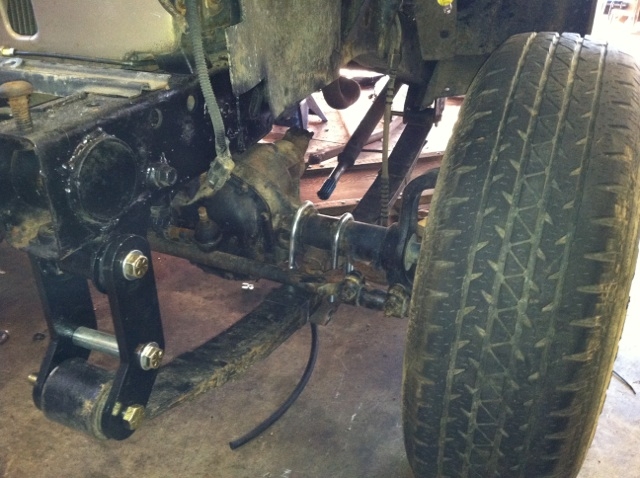

Really happy with how this turned out. Also spent a little more on good hangers and went with Ruffstuffs Deaver SUA Full Kit Spring Hangers.

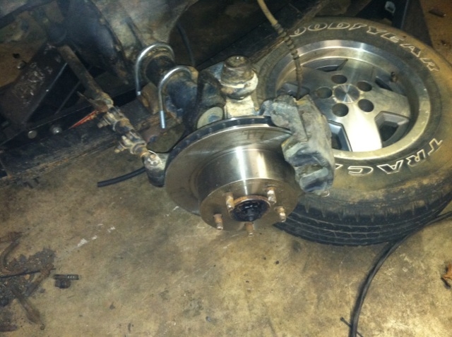

I did all new pads and rotors while the front axle was out!

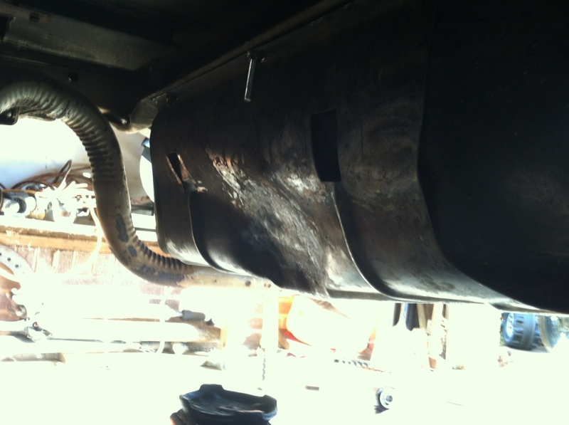

We had to massage the gas tank to clear the diff with the 2" stretch and the low stance! We just dropped the skid, heated it, and forced it back in.

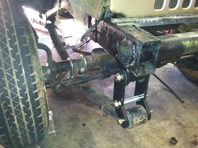

Waggys and shackles in!

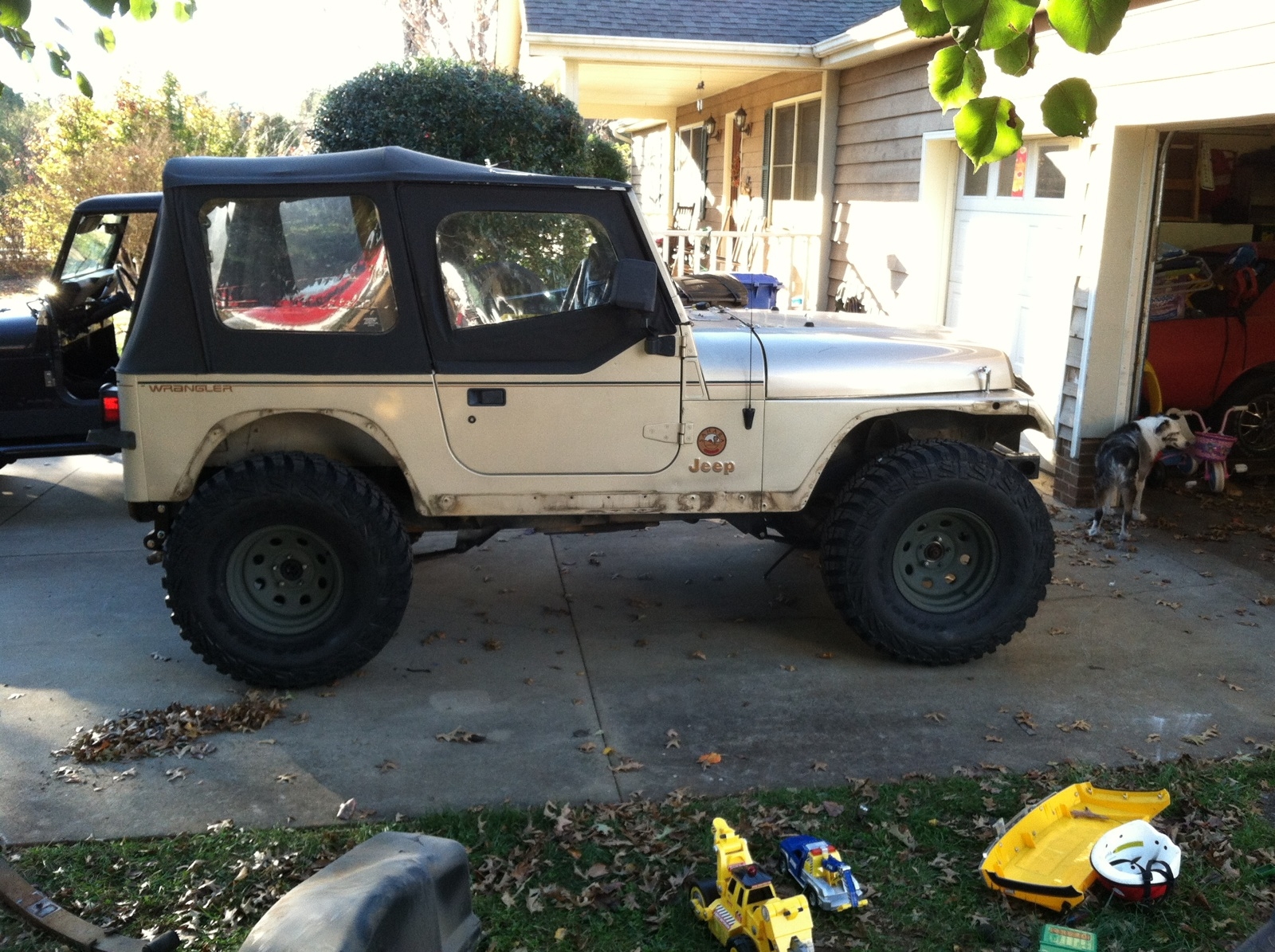

Anyone have any ideas on how I should cut the front fenders? I dont really want to do a flatfender because I do not think it looks right with a d30 and 35s but it may be my only option. I have also seen guys run tj flares and cut them to fit the diameter of the tire. Im just not sure I want flares
It looks well used but it has actually only had about 2 pulls on it since it was bought and has been stored since. I am hoping it will spool right up! sorry for the cell phone pics!

It ended up with a wheelbase of 98" and its only 19.75" to the frame. LOW!! Still needs shocks mounted, rock rails, winch plate, winch mounted, and bumps but getting there. We had an issue with the rotors and brakes that we are still sorting out. Thanks Michael for catching what our tired eyes couldn't!
Not a problem chad. I love the stance.
