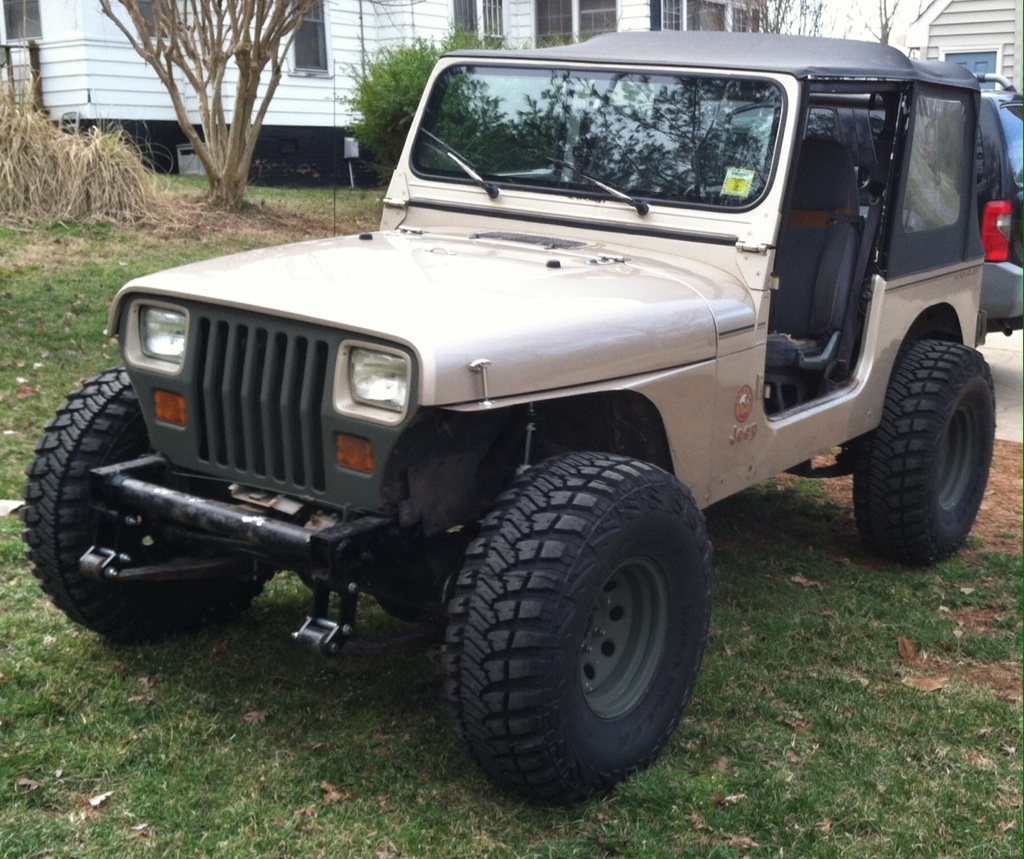

As for a cheap effective winch plate it's hard to beat a Harbor Freight one...that's what I put on my YJ and it fit great. I trimmed maybe a half inch off both sides to make it clean but it bolted right up.
We were able to take the jeep for its first hot lap around the neighborhood. Shout out to csudman for trimming the fenders and for letting me use his place to build this thing! I still have to mount the shocks and bumpstops but it should be done Sunday!

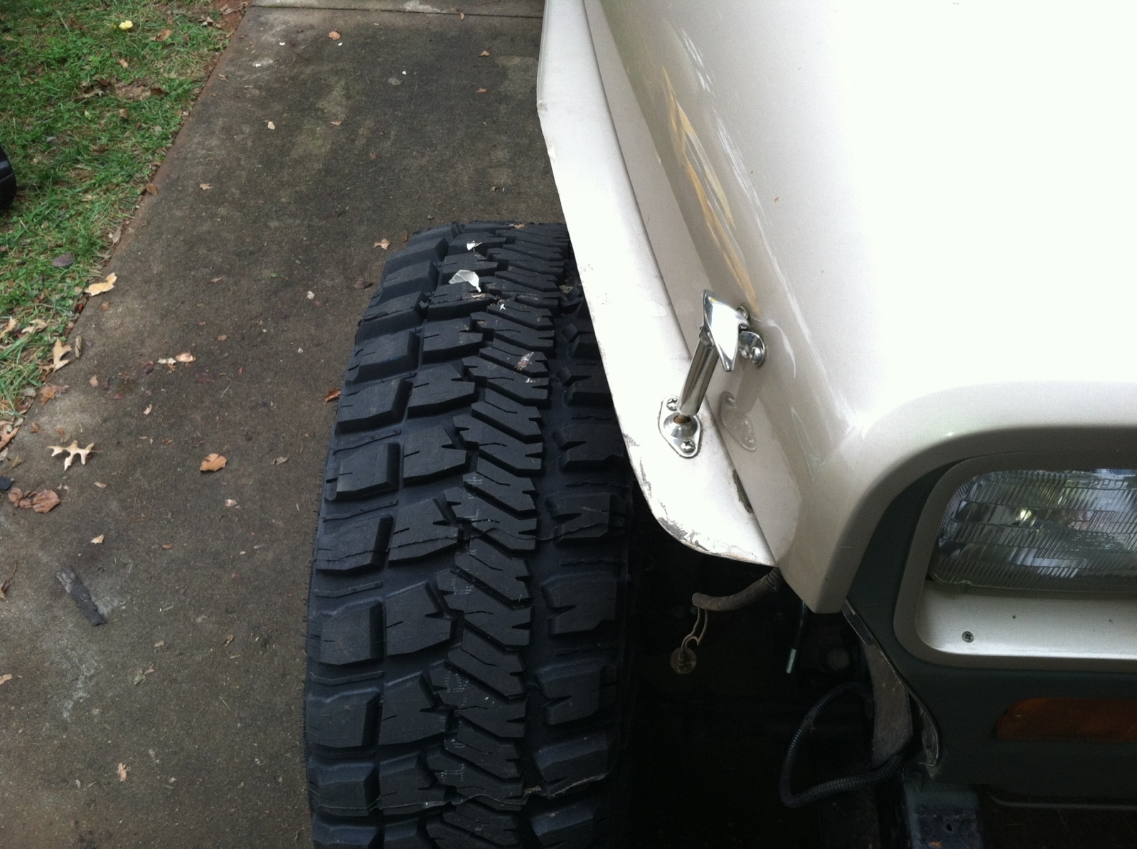

Fenders turn on perfect!

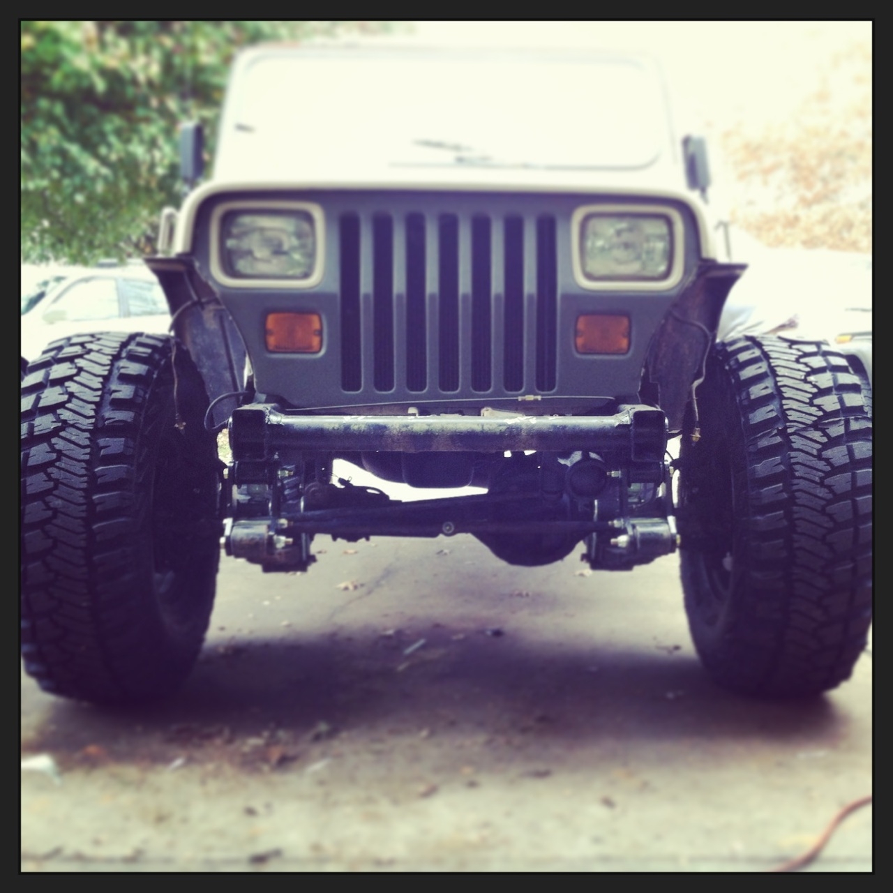

This thing is almost done, finally. I have to replace the front brake lines because they are no where near long enough as well as redoing the front bumps!

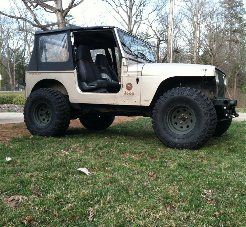

Drove the jeep home last night and it runs out great. I still have a few things to finish but overall very happy with it. Also, the tires were internally balanced and they run out great even on cheap steel wheels!! This was a concern of mine. I still have to get my winch mounted and some cable for it, rock sliders, and by wheeling season I will have the rear locked. I am thinking about leaving the front open for now just for reliability!

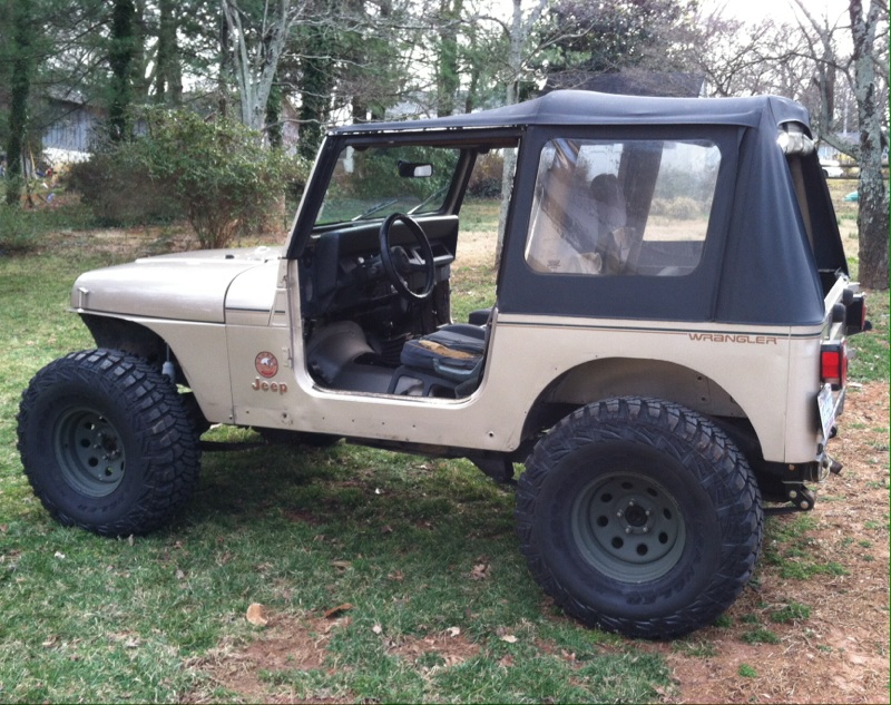

Got the jeep tagged this past Friday and got it out on the road. It rides and handles great with a little bump steer to work out. It needs a steering stablizer and alignment and should be good to go.
