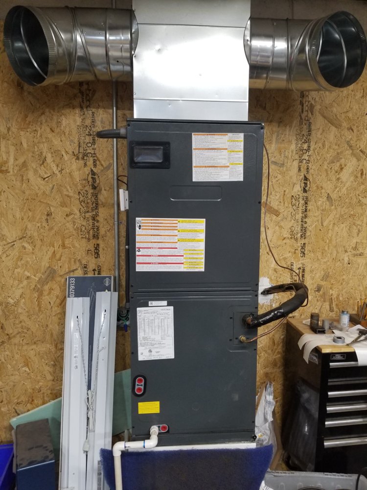

I have a 2 ton home package unit heat pump and a 2 ton window unit ac with electric strips that I run together on really hot or cold days. On moderate temp days (45-85) I can get by on one. They only run when I'm going out there, so I'll turn them on right after work then eat dinner to give them time to work. Highest electric bill ever was $150 for the shop on a separate meter. That was in January working 5 nights a week with them both running electric strips from 5 til 11pm for several weeks. Ac bill is usually less than $125 even in the heat of summer, that's with all the lights, welder, compressor, etc included. In about an hour they'll drop inside shop temp from 120+ to low 80s or bring it up from 30 or less to upper 50s, for the record I prefer mid 60s temp if I'm working.

This is exactly right, you'd be better off with a large fan. Or---for the price of a porta cool or spot cooler--install a regular split unit or package ac. The fact that I can leave machined pieces of steel laying around without oxidizing in a day is more than worth it for me.
This is how simple mine is, if I had a package unit laying around for nothing it would have been even easier.
