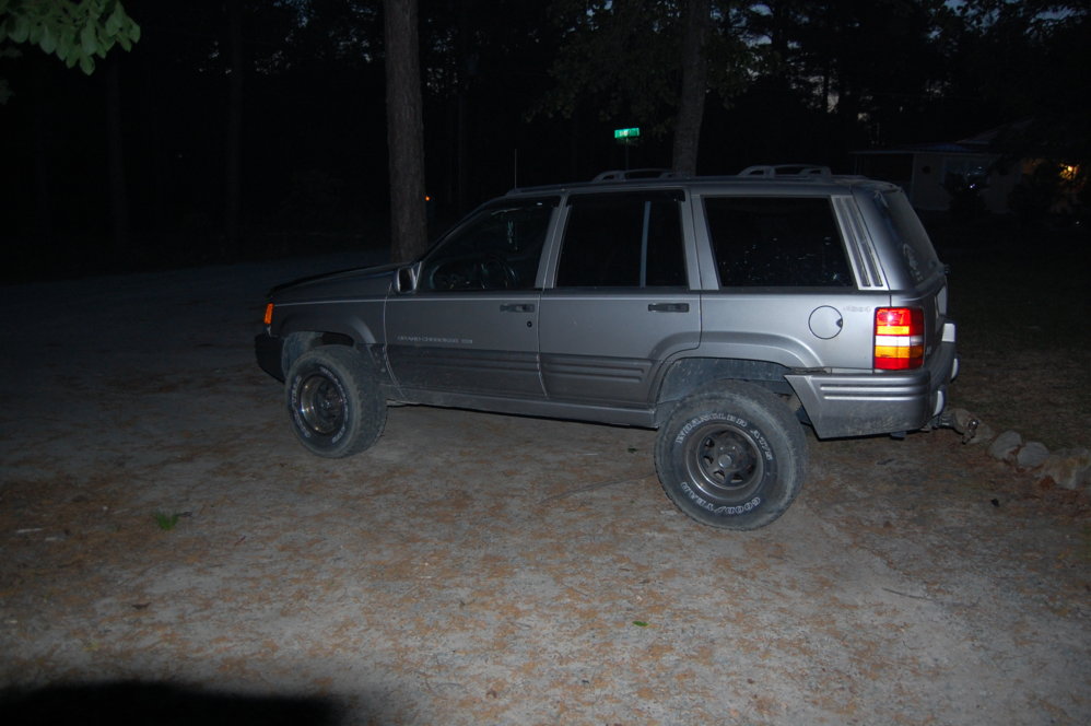

my yj the other Bi$%h

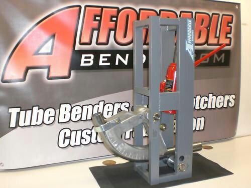

^^ I like that. Having the hydraulic would be sweet. I did all mine with a JD2 model 3 manual and a homemade bracket/slide-in pole concreted into the ground lol. Still thankful everyday I bought it though, but good gracious can it bring the suck when making more than a 60 degree bend! Good back and shoulder exersize! :lol:

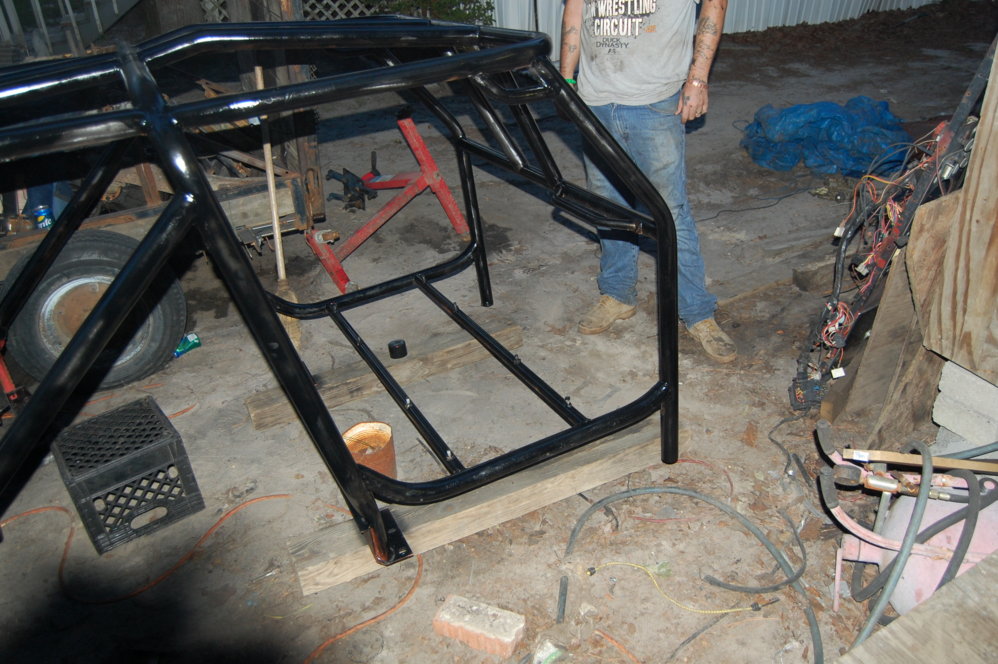

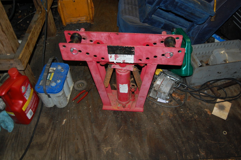

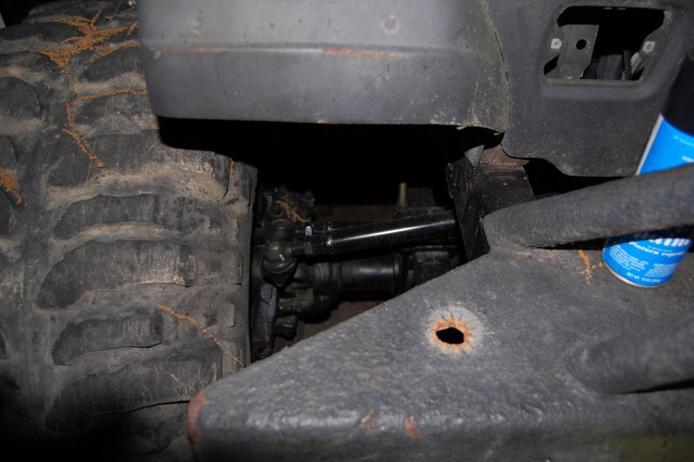

mine is hydraulic but im no pipe fitter. we got 3/4 of it done finish up this weekend. get the seats in they are tied to the cage but we ran out of wire

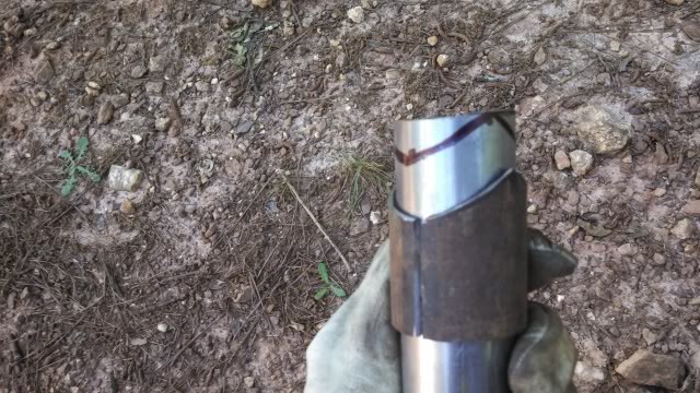

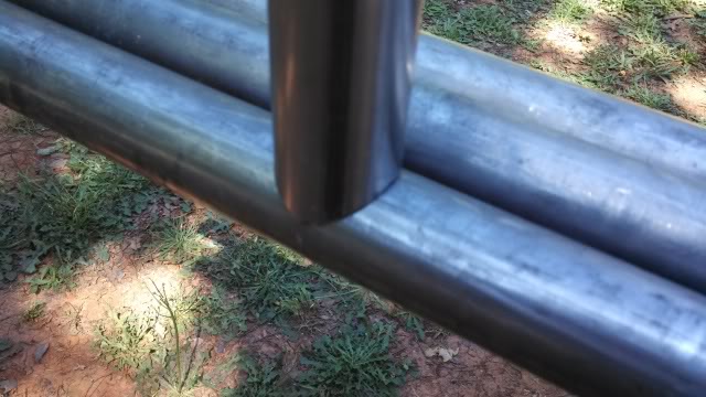

Nonsense! Let me show you an old indian trick I learned for notching tube. This is a scribe I made for myself out of 1.75 ID. Basically to adjoin two pieces of tube the same diameter together uses one formula, and you don't necissarily need a scribe to get a perfect notch. When you look down the end of a tube, visualize the four cardinal directions and mark them with a sharpie. Pick two opposing directions and measure down the tube exactly 3/4" both sides and mark it. Draw a straight line from each of those points to the neighboring points which will be at the edge of the tube. Cut out the triangles, clean up a few key areas with a grinder blade (think curvature) and you'll have a perfect notch every time. For angle joints you'll be dealing with percentages. Example: 45 degrees is 50% of 90. So in a 45 degree joint you would increase the depth of you notch by 50% and on the 135 degree side, decrease the depth by 50%. It takes some practice but not hard to get them perfect.

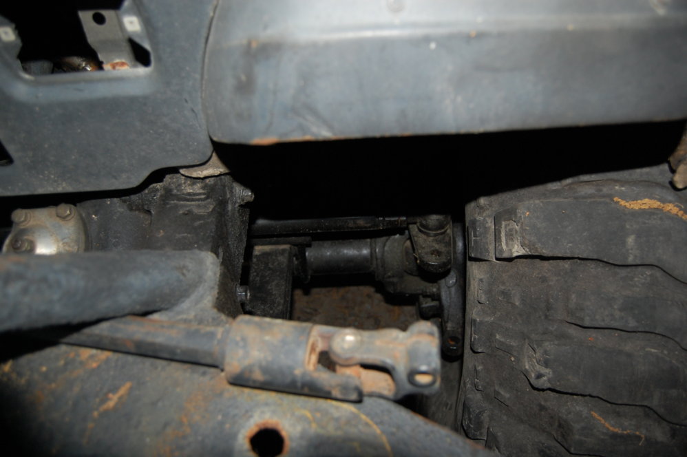

son just brought me 1 1/4 ton lug nuts and power steering pump brackets and the steering shaft for between the colume and the box

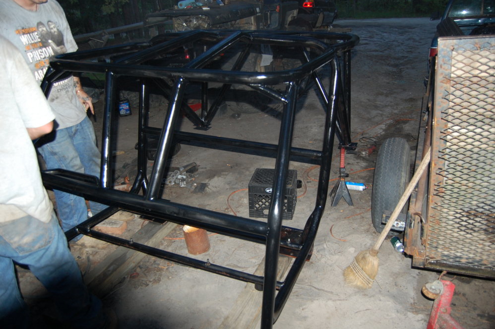

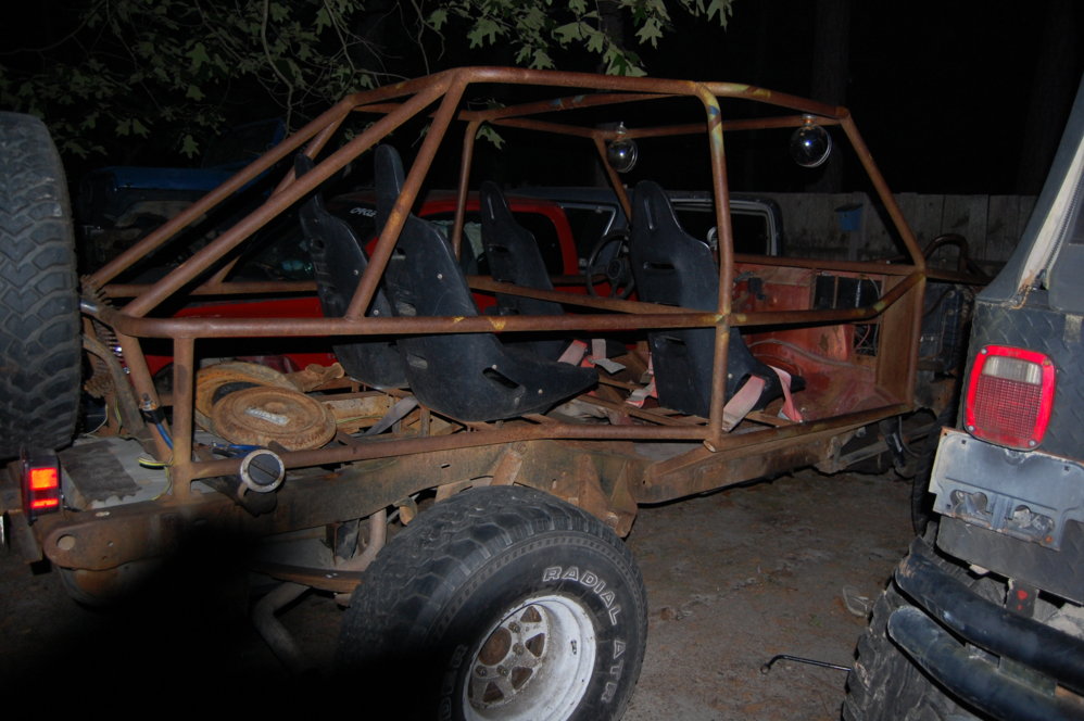

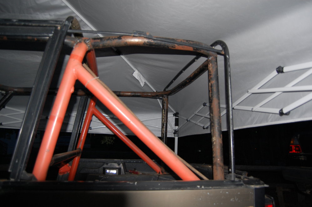

ok locker.headers.drive shafts,fuelcell all ordered or here going to finish roll bar tommorow and get my shocks on and build my bumpstops im ready think i mite drive it 2 weeks

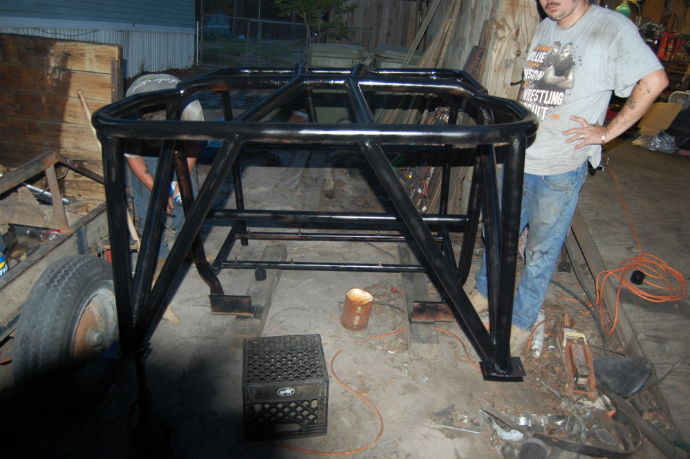

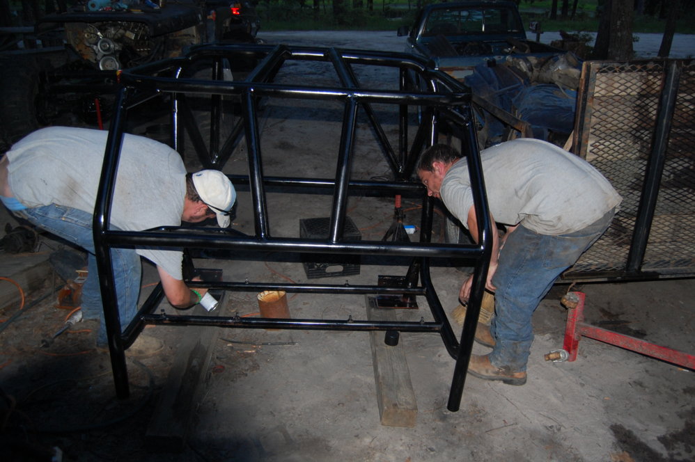

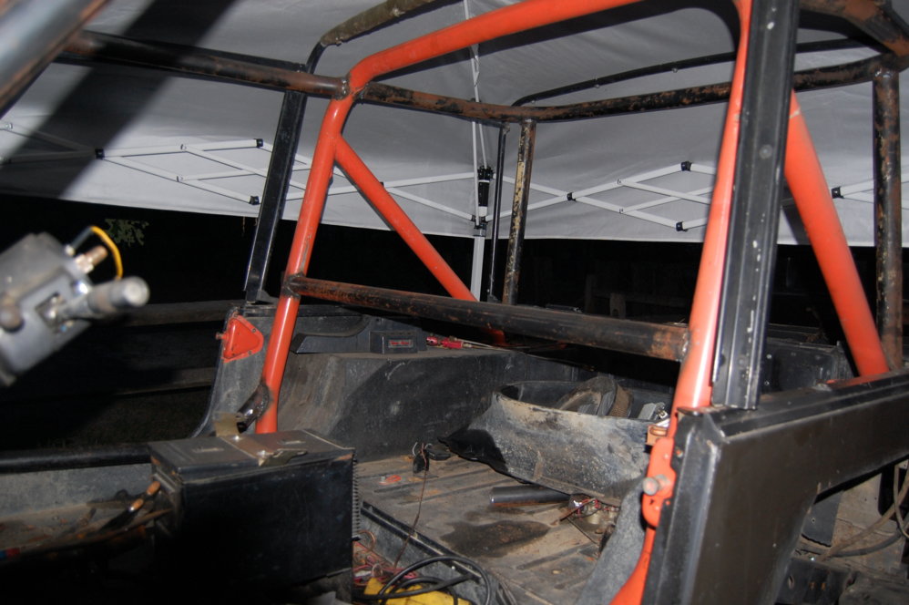

got the bars welded in for the seats to mount to and put the seats in only 8 small bars left to finish the roll bar will do that tommorrow and maybe get the shocks on
roll cage is all cut and tacked together so one more part done have to get the fuel cell in now drive shafts going to get done this week its coming together i mite drive it in 2 weeks
What's your plans for fuel delivery?
