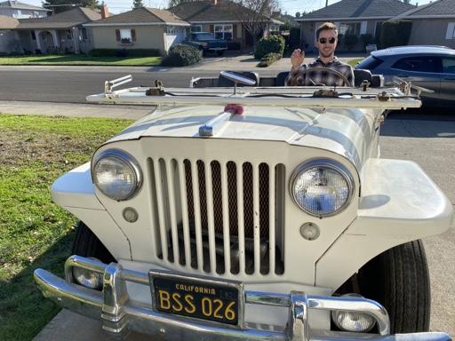

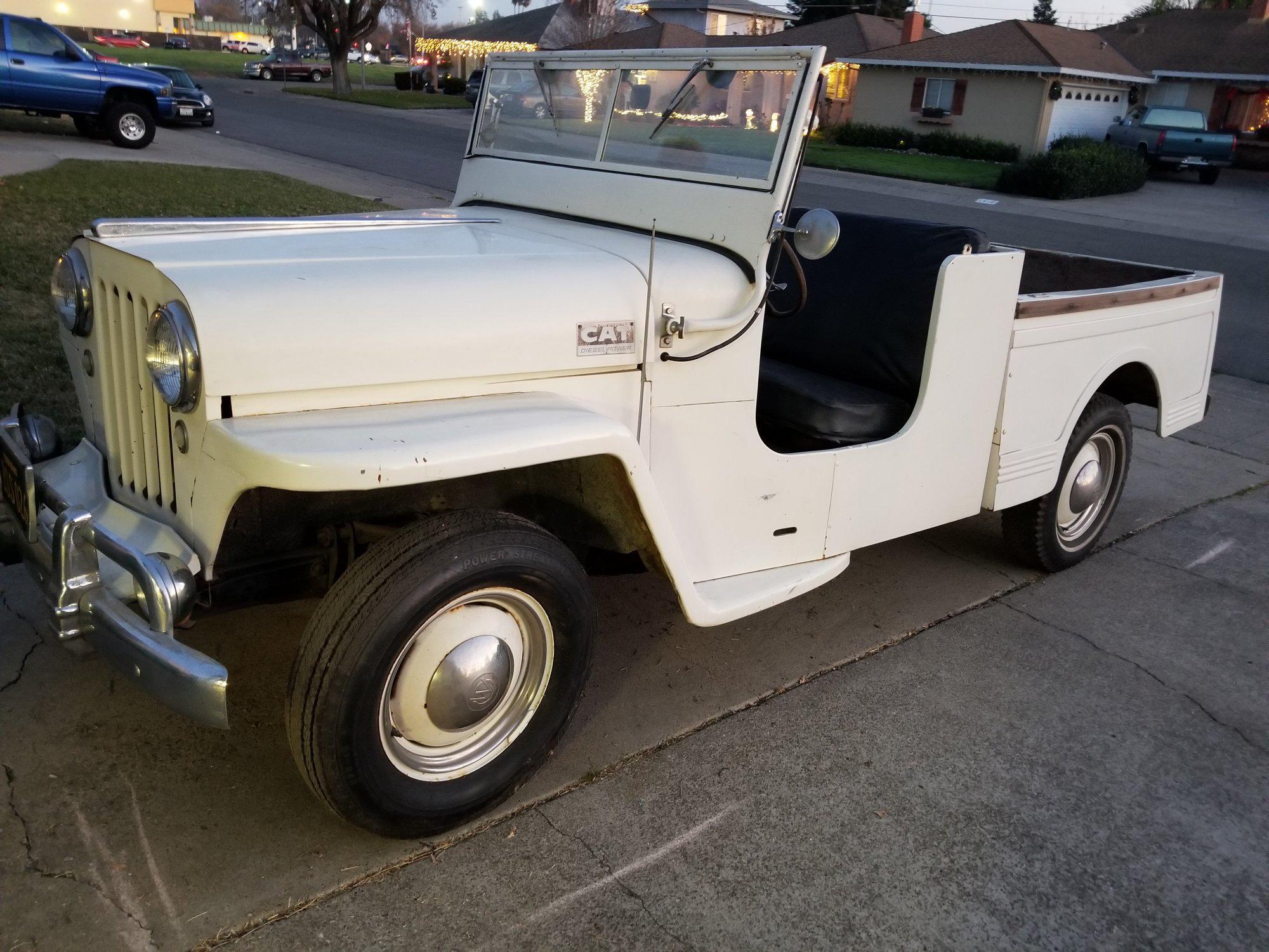

Saw this on another forum, guy bought it on a whim and is wondering what he bought.
Is this some kind of Frankenjeep or is it an actual factory model?
Was listed as a 47 CJ2.
It's cool, I'd drive it...
I'd bet on the cj2a being most of what was used, with a Willy's wagon providing a lot of body panels, A wheelbase measurement and check to make certain the frame hasn't been lengthened should confirm what base vehicles is under there.

That is an abomination! It is a '47-'49 Jeepster (VJ) front end Married to maybe the CJ tub and what looks to be a Willys wagon rear end
Edit: on second thought, that's probably the Wagon's front end also, they were the same
I think you had it right the first time.
Nailed it! That's exactly what I was going to say - I see a late 40s Jeepster front end with a CJ2a tub corners (closed off the tailgate area, of course), with a Willys wagon hacked and capped into a bed. Can't really judge by the pics to well, but looks to be the same wheelbase as a Willys wagon anyway.
Looks like some Cuban concoction. When did the grills have 10 slots? I know about the 9-slotters but 10? I’m no expert.
Yep, 10 slots...if you took the chrome trim off the front of the grille, there's 2 slots behind it (plus the 4 visible ones on each side of the trim). Does look like a Cubano job though, doesn't it?
