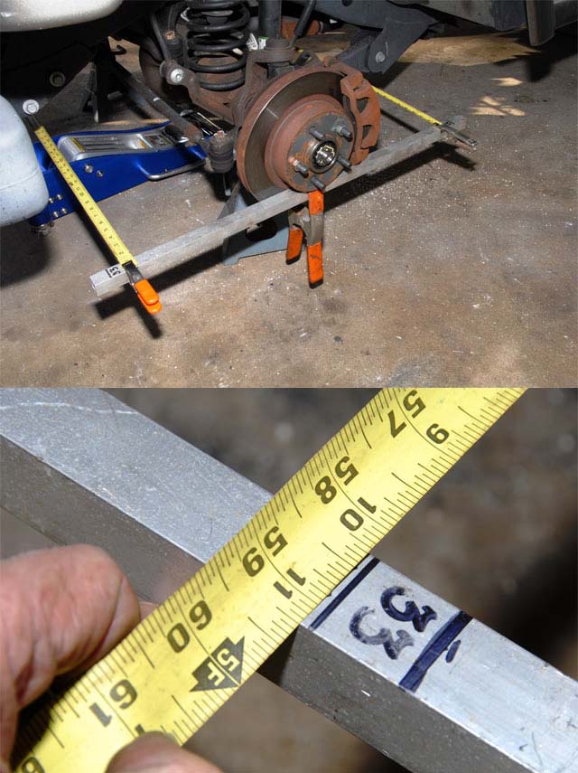

I have always heard about a chalk line and a tape measure but I have no clue about doing an alignment
Clay,
I had attempted an alignment a few times after redoing my steering. I tried all other methods besides the one below in the picture.
Either way I still found it hard to feel confident in my measurements. Spec is like 1/8" toe in. Possibly more for big tires. It takes two pairs of hands and a lot of careful prep to be accurate. I just ended up taking it to a offroad shop here in VA beach for $80 after I still had death wobble. A little wait and I had it back in spec. They said my home adjustment was still toe out o_O
I did set castor at home though. Mine is somewhere in between 5 and 6 degrees. Wheel still returns to center.
