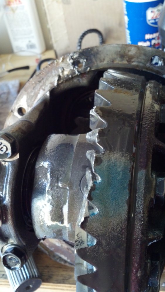

Yeah 5.29s are shit.
Thats why I ruined some ring gear teeth :rolleyes:
FYI 5.29s with probably 5,000 all offroad miles...a few even saw mud puddles and maybe over a gravel road or two.
Yep that pinion sure snapped off clean :rolleyes:
