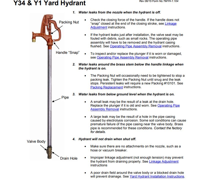

Just FYI, Non freeze yard hydrants are supposed to drain off the water to prevent freezing and bursting. Typically they should be installed with a 12" base of gravel (prefer #67 stone) for proper drainage. If it's just buried in dirt, it will clog the drain
Thanks for the reminder. The faucet I dug up had not been used in weeks. We have four in the yard and only use one. The previous owner installed them in 2004.
