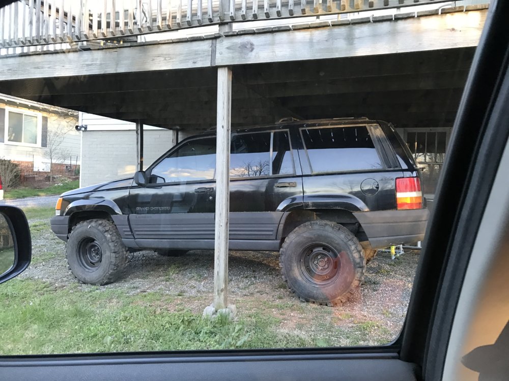

So I just purchased a 1996 Jeep Grand Cherokee with the 4.0L and I have a few questions. This is all new territory to me. It is currently sitting on stock springs with 2" spacers and 34x10.50x15 swampers. I identified the rear end to be a Dana 35 and I'm not quite sure of the front axle.
1. I don't plan on doing anything with the suspension until I install a long arm lift. Is there any freebie tips to improving the stock suspension until then?
2. Is the Dana 35 worth upgrading?
3. Are there any issues or weaknesses I should be aware of with this particular model?

I'm not experienced in the build on these, but within 24 hours you might be Really confused! You got a good Platform, & drivetrain/engine combo, other than the D35. I would expect the advise to be, save your $$ for something else. Don't spend on the 35. Welcome to the Forum! Your Also in a Great Area for support & builders!

So what's wrong with a Dana 35? easier to say what's not wrong. It breaks easy, easier if you put a locker in it. You break, and the axle will come out of the tube. Over all, honestly, it's just junk.
There are several upgrades you can do.
Chrysler 8.25
Ford 8.8
Dana 44
All can be found with your same gearing and lug pattern.(if it hasn't been changed)

I love ZJs (which is the two letter name of your particular model). If you plan to do long arms, then I would just leave everything as is until you decide which long arms you are going to install. As others have said, toss the D35. I ran a Ford 8.8 in the rear and a D44 in the front of both of my ZJs and they were on 35s, and I used every bit of the 5.2 and never had any issues with them. Be warned, 35-37 tires and long arms on a ZJ will get pricey to get it done right. Check out my build thread in my sig for some pics and some ideas and feel free to shoot me a PM if you have any specific questions.

@rodney eppes if he were to go lift first then axle swap to say an 8.8 he could use any number of different manufacturers bracket kit on the 8.8 and it will slide right in the place of that 35 with about nothing more than the ujoint flange adapter. Brake lines and even the ebrake cables bolted up direct. It's how it worked when I took out my 44A in my '97 ZJ.
If my memory serves me right, the drum brake D35 e brake will not be a direct bolt up to a disc 8.8, I used an ebrake kit for mine. If the OP has a disc D35, it may be OK (I know all the 44a were disc)
Mine does have the disc brakes. However, when I do the 8.8 axle swap I will more than likely change out the brake lines and e-brake cable for new parts since my zj sat for a long time.
