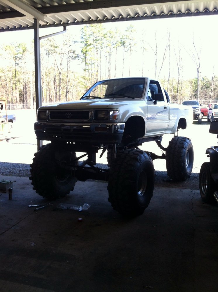

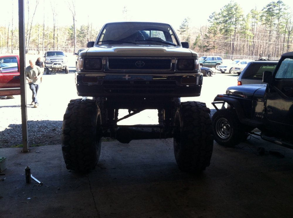

My alignment was checked at galloways I DONT HAVE A TRACK BAR... could that solve my problem???
Make sure I comprehend.
You have stock width, lifted toy leafs and no additional means preventing leaf flex ?
Correct?
If so then Yes. That could cause your problem.
The reason the problem showed up with the new tires is the increased rotational, un sprung mass increases the fulcrum force onto the leaves. At a certain point your leaves may be S shaping essentially.

heres some picks of the truck and steering. so if yall could say one solution possibly it would be needing a track bar???
