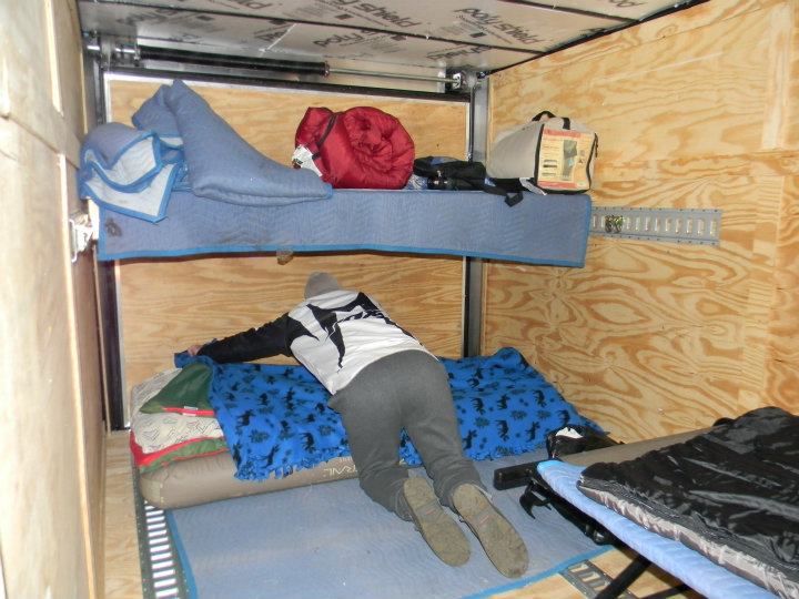

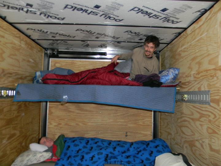

My 7x14 doubled as a cabin when we'd go somewhere overnight with the dirtbikes. I insulated mine fully and made bunk beds. I was perfectly comfortable in anything but summer. I sold it right before last summer when I was going to try out a portable AC unit, which I think would have been fine.

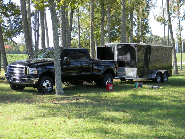

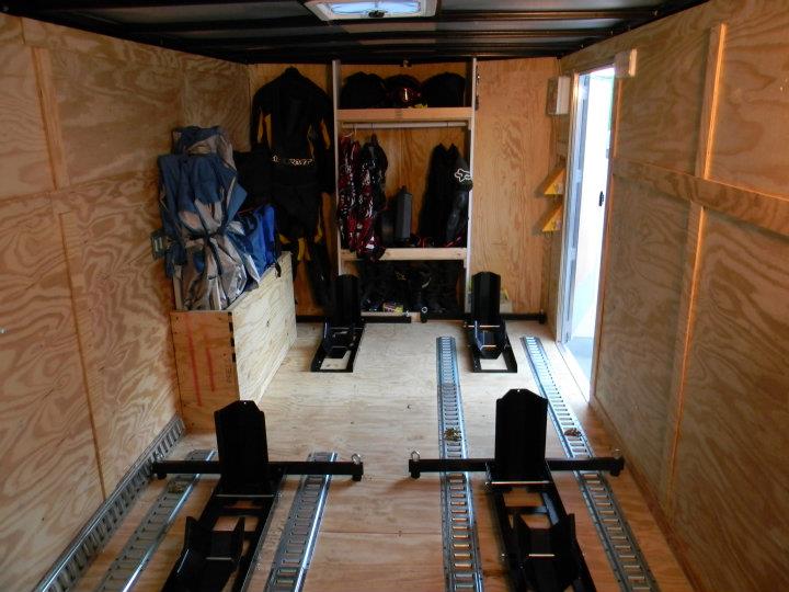

@HGSR Is the most recent hillbilly hilton creator. Hes got a pretty sweet setup for the family to take to the races.
Work and Play and MotoTech build some nice units, but the prices are up there. Unless you absolutely must have all the amenities, what CastorTroy posted is pretty handy. Plus the trailer still is able to be used for whatever else you may need.
