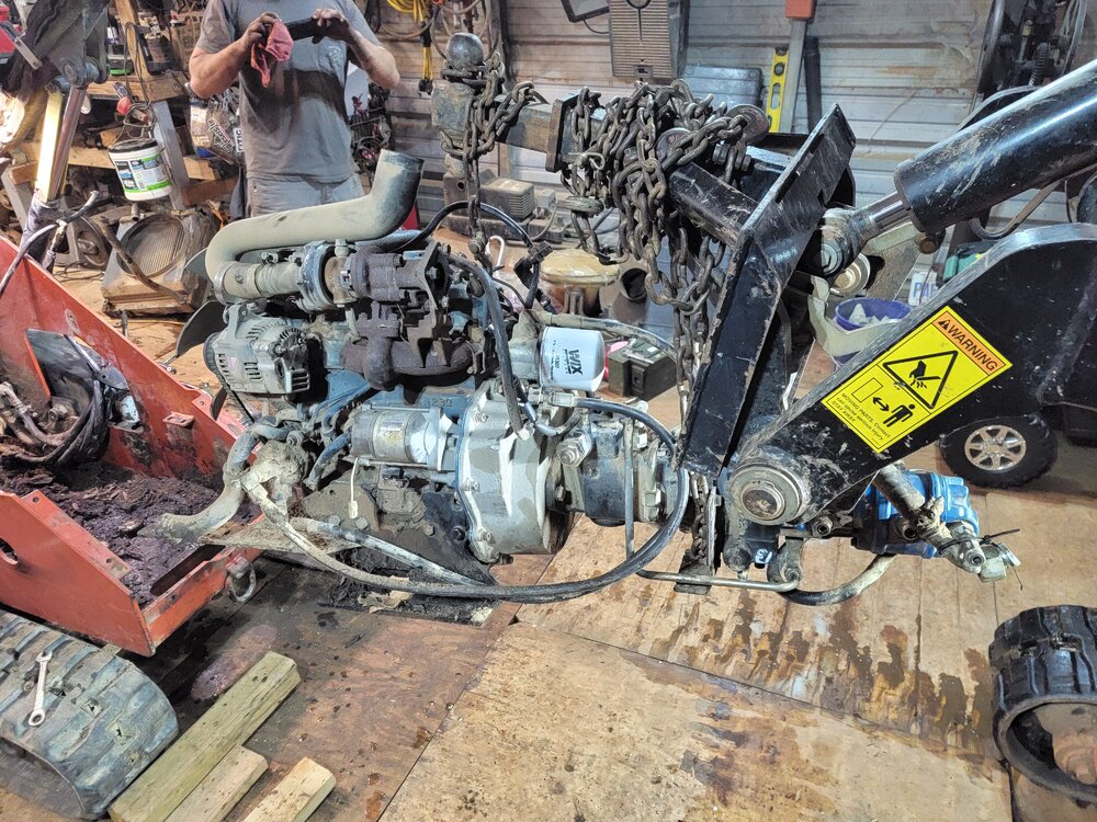

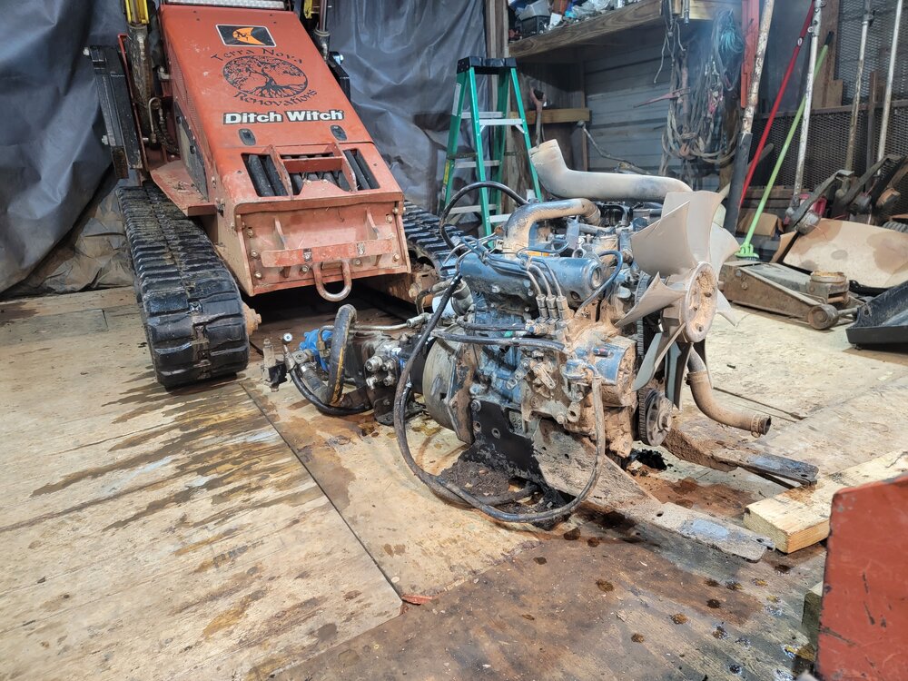

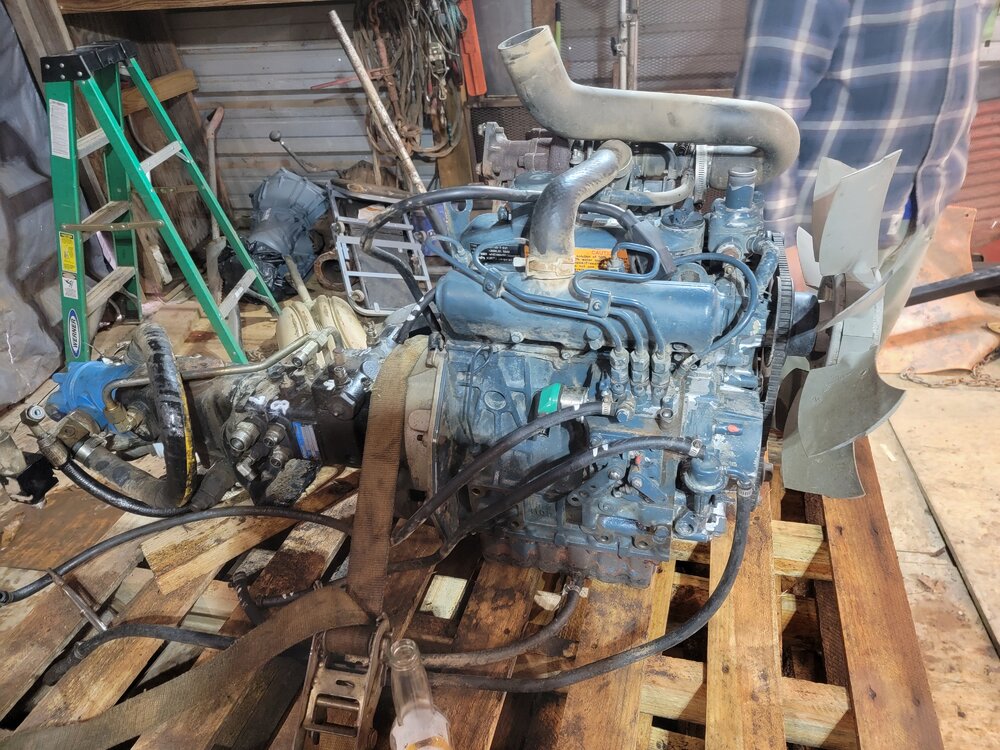

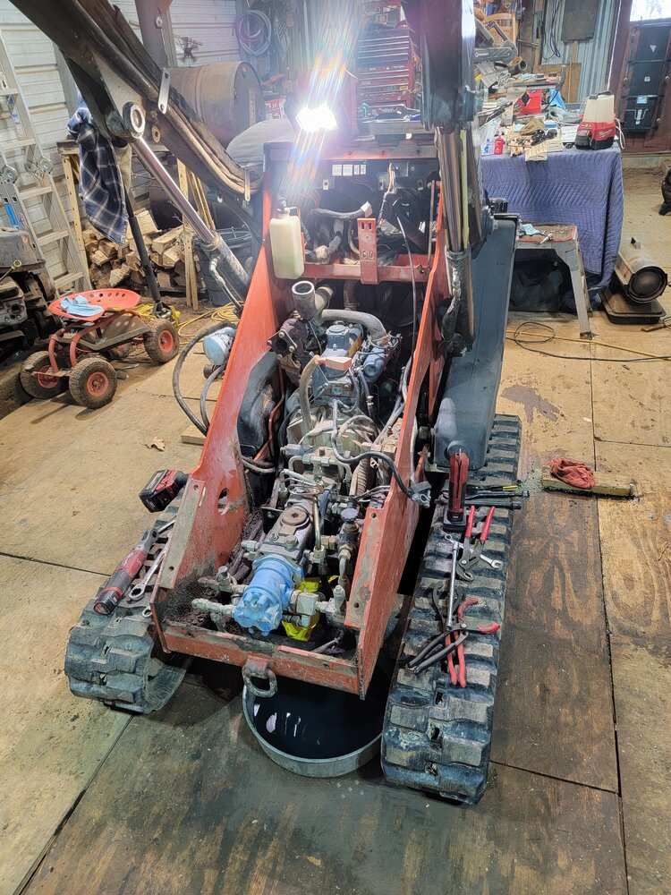

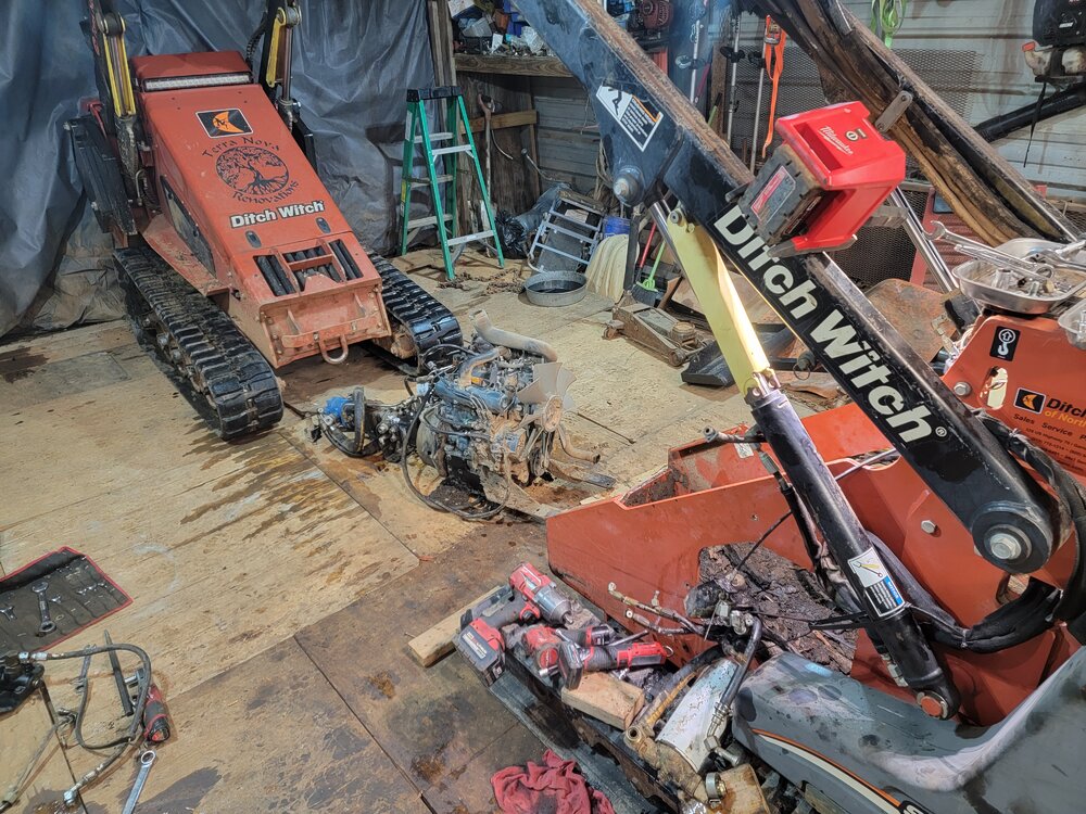

Got it clean today. I bet we got out 50 pounds of dirt from this thing. There goes my weight kit lol.

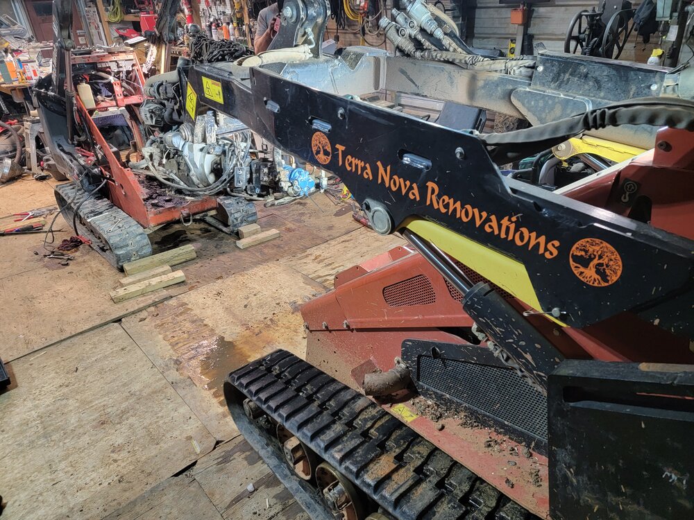

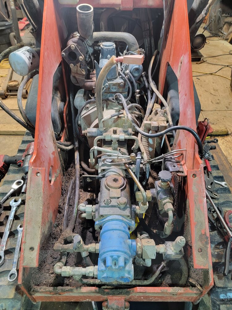

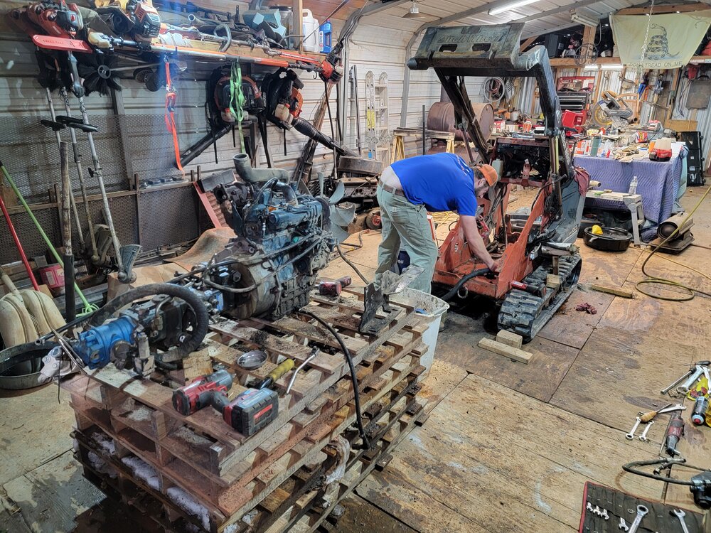

Nothing really crazy hard other than one 45min long bolt. Just a BUNCH of shit to deal with no room.

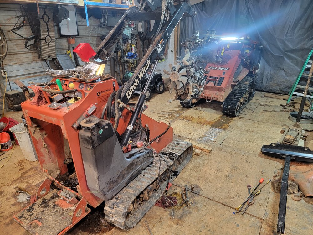

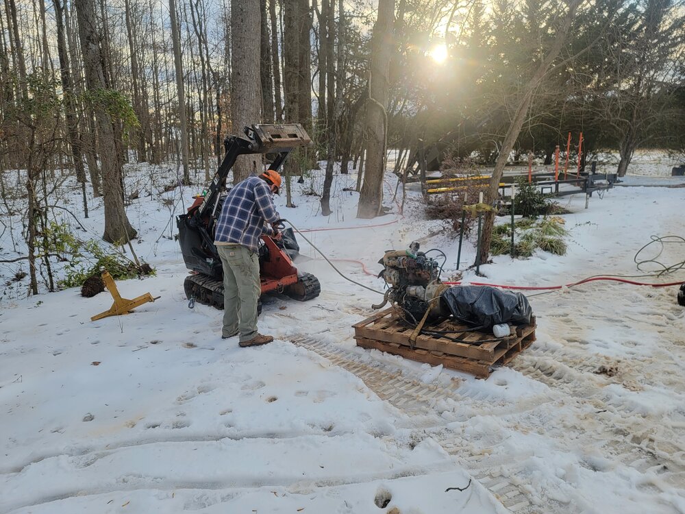

Including labeling, draining of fluids (oil takes 2 hours to drain at least), keeping the woodstove going and trying to find bolts underneath 4 inches of nastiness(and that's after pressure washing it) We had the engine and pumps sitting on a pallet in 9 hours.

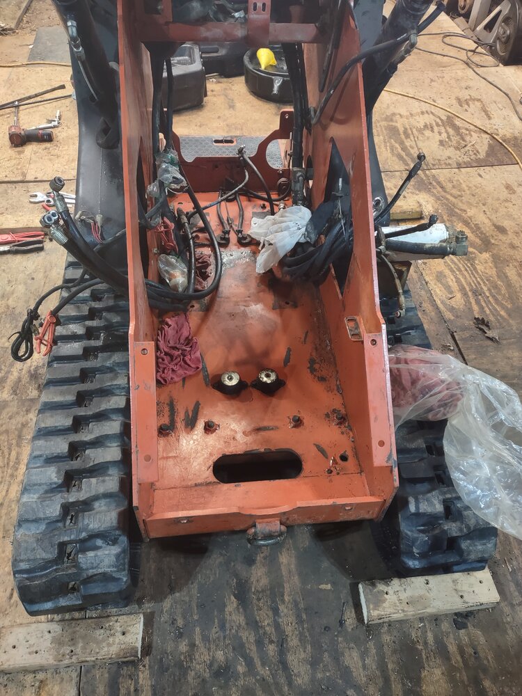

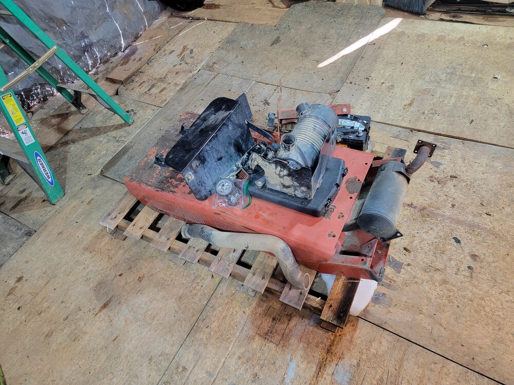

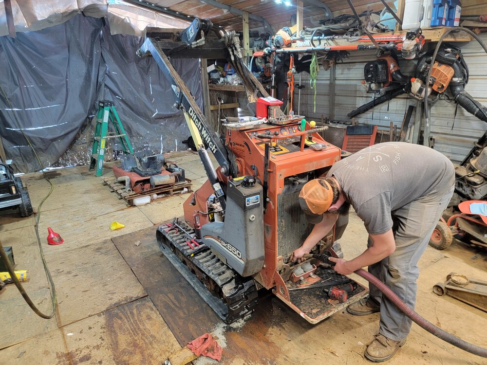

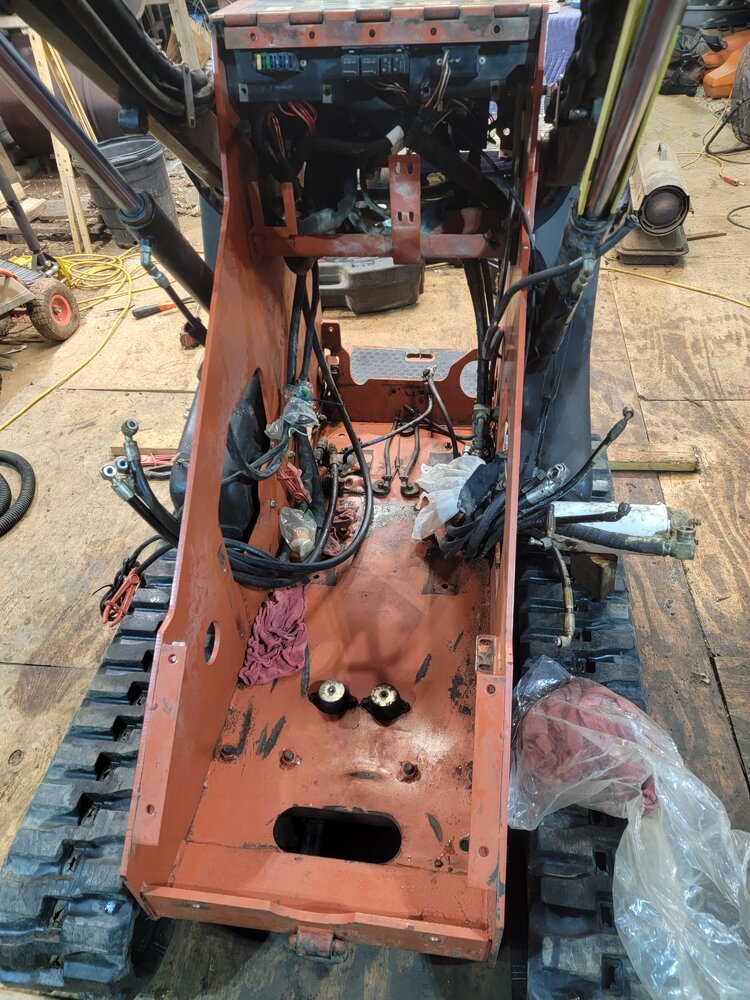

Spent around 4-5 hours cleaning it and the engine yesterday, as well as getting the radiator sent off to a buddy to have all 3 of the mounts welded back on (alum). Both of us were moving a little bit slower. The teardown was fairly intensive tbh, mostly due to being bent over all day inside this thing and under it. A hydraulic table or some form of lift would make this job so much better.
I am currently standing in the shop knocking the chill off with the forced air hearer while I get the coals rustled around in the stove to light up once again. Then will be adding the extra 2 holes per side on the mounting plates since DW decided you only need 6 bolts vs the 8 mounting holes in the Kubota block. I guess it's a good thing considering there is 1 hole per side that is 90-95 percent fubared.

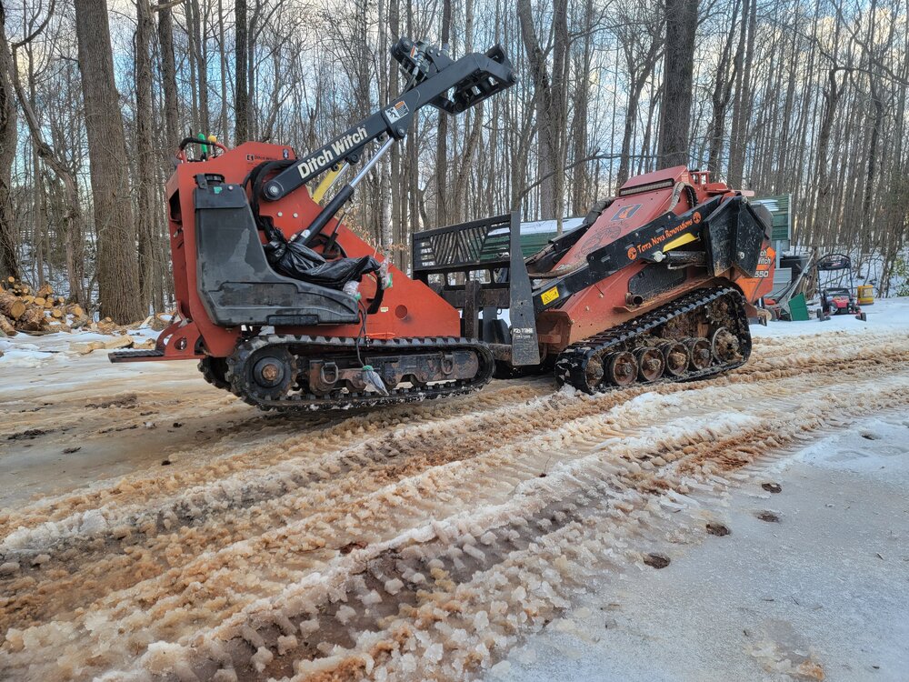

That thing was messy. I'm sure that second machine came in handy....

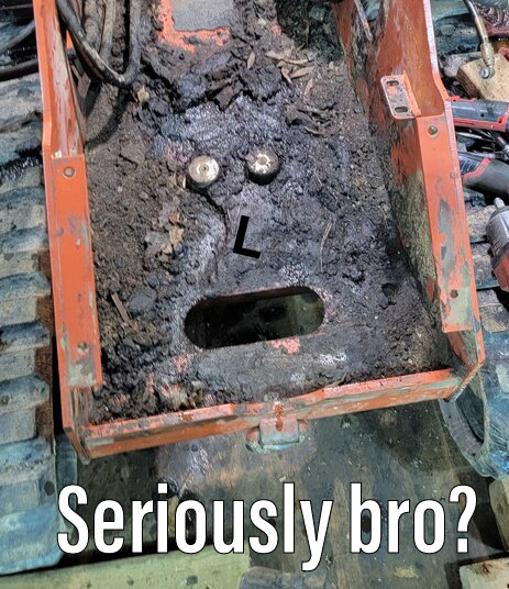

Man that's an understatement. Justin got it second hand about 2 years ago....pretty sure the owner before him had NEVER cleaned it. Hardcore pressure wash before I even put it in the shop, cleaned gunk and nastiness as we went. Then spent all day yesterday with pry bars, paint scapers and ice scrapers before pressure washing again.
How clean do you keep it? Engine bay I mean. And how many hours?

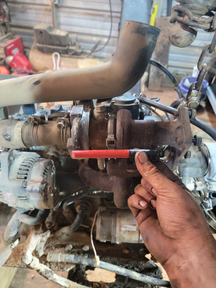

Well it's never been washed except for rain so she's a dirty girl. It's got a weird combo of spilled hydro fluids, oils and red dust. Last I checked it's at about 600 hours. Still pretty new for the issues its had but ditch witch was pretty shitty with they're routing of the harness. 2 grand for a new harness and I zip tied the shit out of it so hopefully there wont be anymore rub-throughs. Love the machine though. Needs little more ass to lift an entire pallet of pavers but it is what it is.
That thing on the exhaust manifold looks like a turbo...only smaller :D
