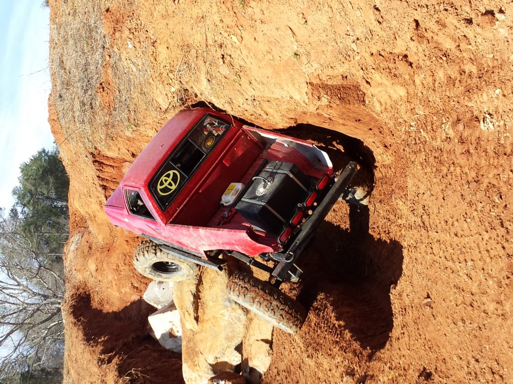

Im wanting to get some opinions on where i should go with my truck. Right now its your average toyota, junkyard leafs all around ifs hubs and ifs rear with 1.5 spacers all around full hydro drive flanges 4wheel disks spools 22r w56 stock duals 4.10s. My plan for a while has been interior cage, tubed dove nose front, weld the cab to the rocksilders, flat belly, propane, all new wiring, rear radiator.
Now the question burning in my brain is why not just build a buggy and get rid of the factory frame and cab (still gonna run toyota fender and grill) ide hate to do all that cage work to do a buggy a few years from now. Not sure if i wanna do links f&r yet but my plan in my head is 2x3 .125 main rails 1.5 .120 for the rest. Ive been around a few buggy builds so i have a good idea of whats involved and i have a jd2 bender, notchmaster welder probably every tool ill need.
After the back story a anybody have advice caged truck vs tube buggy
