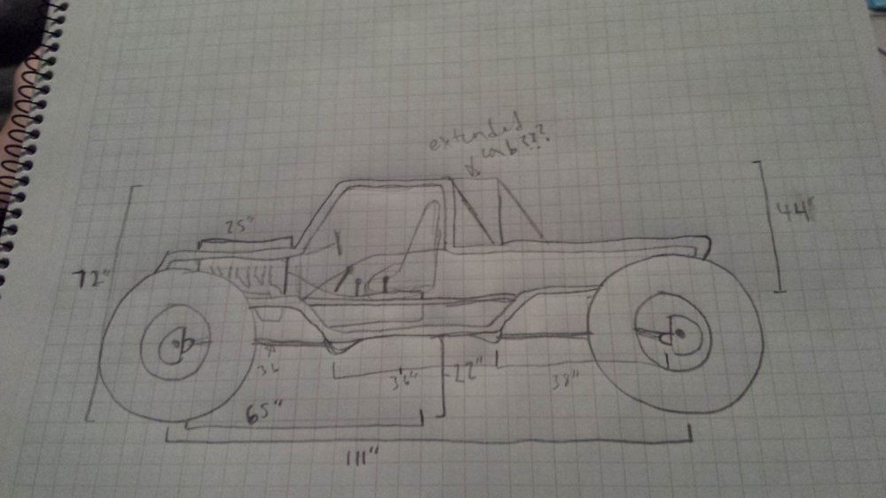

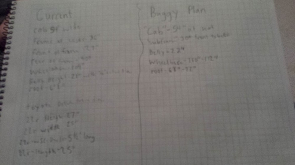

Took some measurements of my current somewhat capable rig taking what I like and don't like into consideration

I'm gonna do a 4 link out back and the front I'm not sure if I'm gonna do a 3 link or 4 probably 3. I already bought 14" airshocks and 16 coilovers
My opinion is decide what would be your dream build, then figure out if you can do anything close to it with what you have. Do not go the path that most everyone takes: truck> hardcore truck> truggy> buggy.
If you know you'll never want a buggy, then build the bad ass truggy. But if you think there is any chance on going buggy down the road, do not waste money or sacrifice performance by trying to adapt what you have.

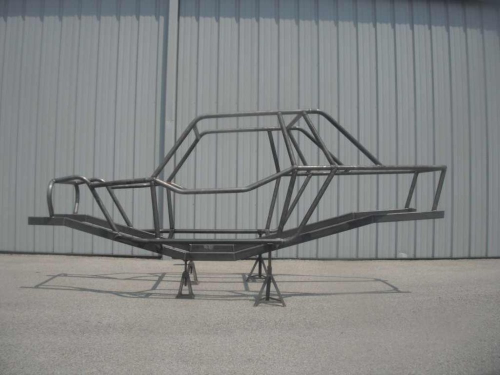

Going to be very similar to these lines except the grill hoop
Yeah that's a bent Fab evo2 I'm waiting on them to give the dimensions to see if it will work. @jaybird1ton

And Bent Fab does have some really cool chassis, that are really simple and clean.
