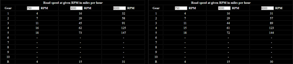

I can't see the 1.7% gear ratio variance being enough to hurt anything. Are you getting binding on hard surfaces in 4wd currently?
Another option would be dropping to a matching ratio like 4.88 assuming you can lose some gearing. That may be your cheaper option than building an 80 front.
I've always heard that within a percent or two is good. So yeah thats why I went this route. 5.29/5.38 is close enough.
If I dropped to 4.88 it would be a dog on the road. fifth gear useless more than it is now. 5.29 put me back in the powerband.
Its only got 6 japanese squirrels barely pushing 180hp with 37s and a whole lot more weight than stock. Its a tired dog nowadays.
Ya know the more I think about this, perhaps the issue is the front driveshaft angle hates high RPMs and its not so much the binding.
I remember snapping a rear shaft this year and having to drive out on the hwy with only FWD and the drivetrain vibrated like hell if i went over 30-35mph.
If I swapped to an 80 series front, I would gain a high pinion too. So food for thought.
Why is 4 Hi unusable above 25mph? Is the 0.09 ratio difference enough to worry about? I wouldn't think so on snow covered roads. I would replace the rear with a 9" before replacing the front.
Binding and any resistance from the ratio difference wouldn’t change at any given speed, it either is or it ain’t for my lack of technical speak.
Whatever it is making you feel you can’t go above 25, is coming from something else. If it were the gear ratio difference you’d feel it at 5 as well as 25. In fact I’d say you’d destroy something before you could even go 25.
Left chart is 5.29's and right one is 5.38s. The trans gears ratios are based on a w56, had no clue what was in yours. Should be fine to use assuming your not trying to go over 70.
