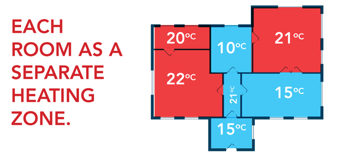

While the traditional boxes and ceiling diffusers are ugly as hell, the MOST ideal unit is the VRF....or, Multi-Zone. When I build, this will be the route I take, but with bulkheads and concealed ductless splits (i.e. living room ceiling at 10'-0" and adjacent room 8'-0" with the ductless split unit blowing sidewall into the living area over the 8'-0" ceiling room) But they are coming out with some creative solutions
This way you can control every room individually with one exterior unit
