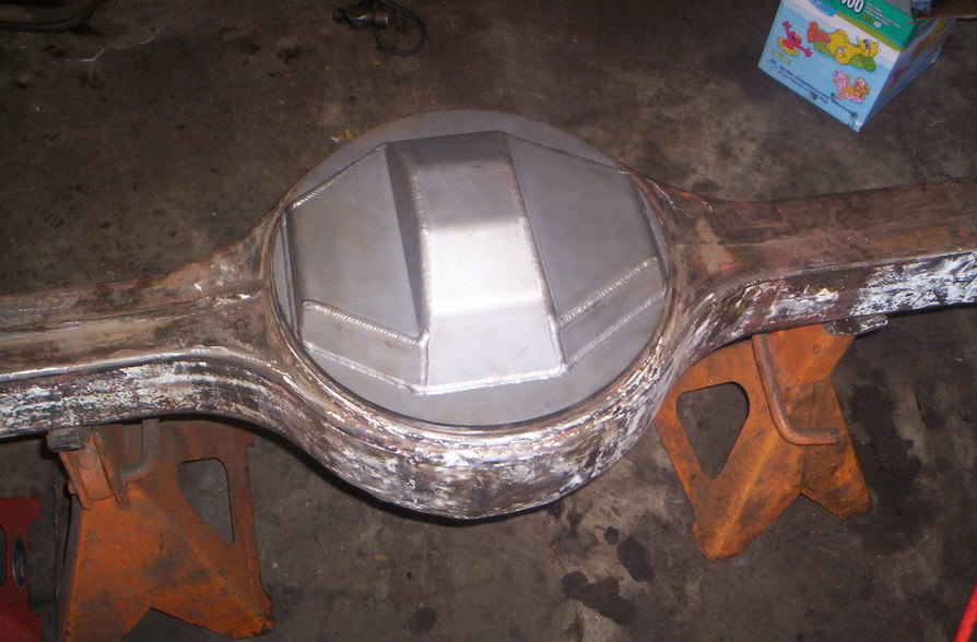

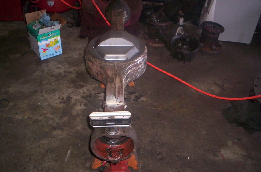

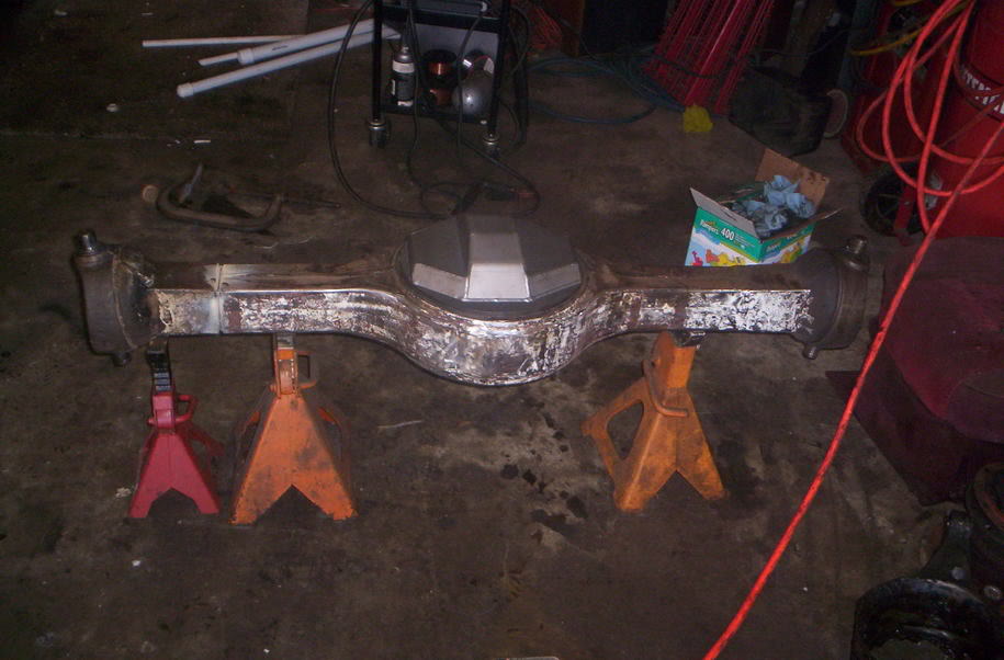

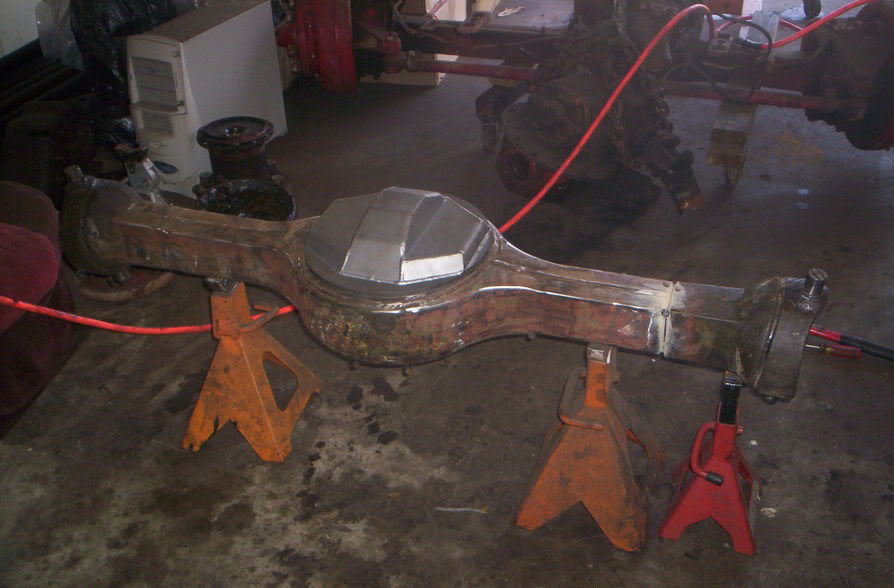

Heres a few pics of the first of the 2 Rocks to be narrowed,and of course the blingin Blue Torch Fab diff cover I won over on Pirate4x4.......now Ive got to buy the other one.Its a nice piece for sure.........axle tubes were a bitch to cut..almost 1/2" thick!
Now its time to weld the spiders on this one and begin re-assembly.....one down one to go....:D
Did you take 7" or 7" 1/2"? I read everywhere that you cut 7" but my shafts are 7 1/2" difference. I'm still on the fence about narrowing my front. Looks good and like the V8, I'm partial to the LT1 all day long.

Yeah LT1's are cool......I took out I would say closer to 7.5"
cut exactly like the guy from Ouverson posted on pirate.
He cuts the end off just outside the weld and then measures like 7 15/16 and cuts again.Then he leaves a 7/16 to under 1/2" gap and welds em up.....:huggy:
