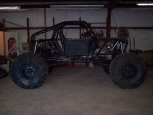

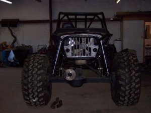

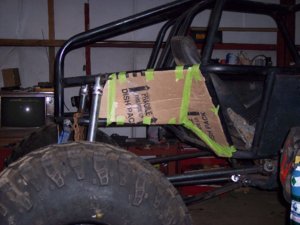

just in time for halloween ... also working on some rear panels

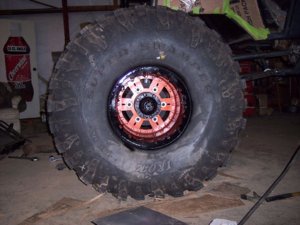

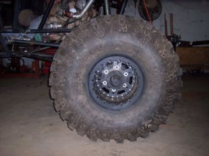

damn it was all good till I saw the heep grille :flipoff2:
