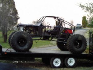

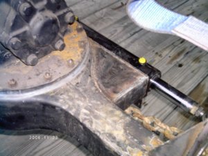

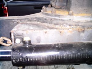

some steering pics .. got the junk on the trailer to get the hydraulic lines made

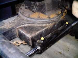

Damn, Bent them from hitting them or tourqe. Mine are uppers 1.75-.250 wall DOM and the lowers are the same sleaved with 2in .120 wall. No bend yet
i called today i can get 21ft. stick of 2.5" dom. with .500 walls for $280 .. thats a little pricey but the .250 wall didnt make it 20 min

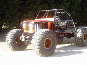

just about done

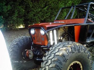

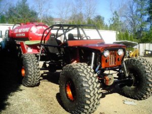

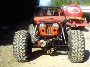

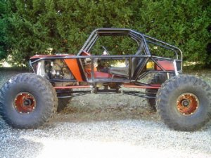

did you go with .5 wall lowers?
buggy looks sweet, how did you like the diesel in the rocks?
the bent ones are .250 wall the new ones will be 2.500 with .500 wall the diesel works good but im having a little trouble getting it to shift
Congrats on getting it out and tested! Please do take a shot of what you did to protect the steering cylinder?
I have a few ideas for mine, but I like seeing what others have done..
Whats that color called? Is it the same color on the wheels?
The tube work really works with the body.:beer:
