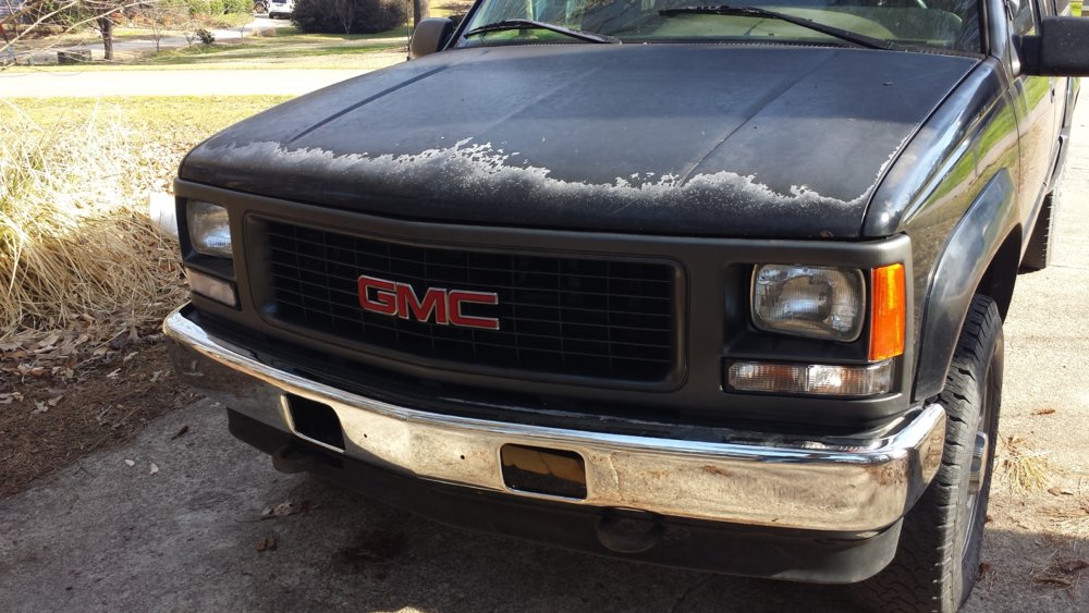

It also has a bumper and Chevy grille on it now that is pretty rough, so I bought a new GMC WT grille setup with the sealed beam headlights, black of course.

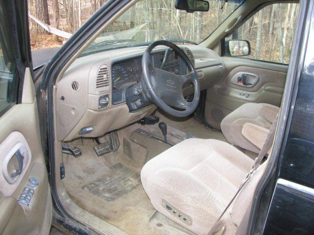

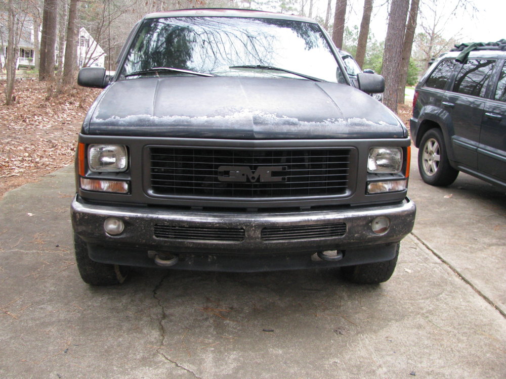

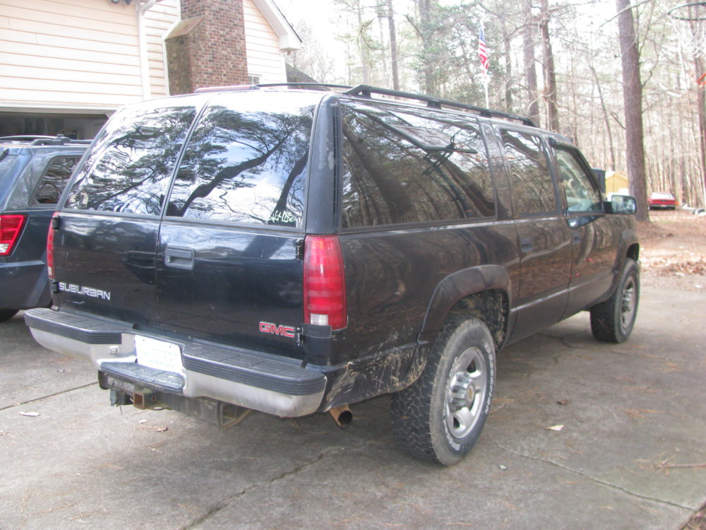

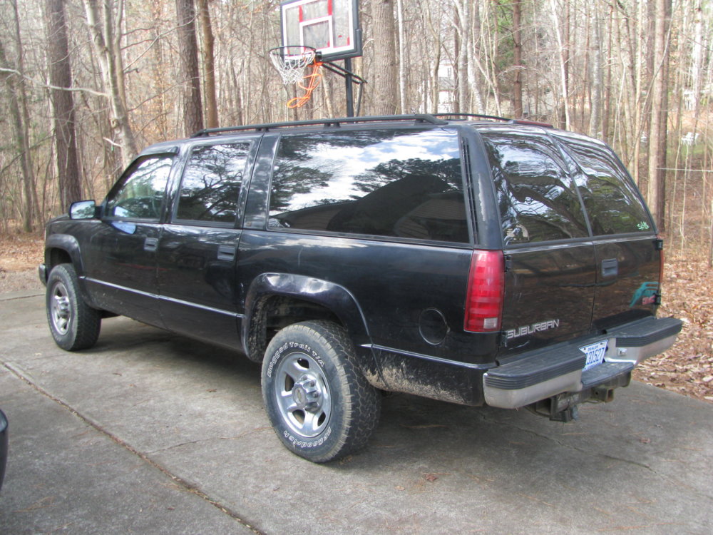

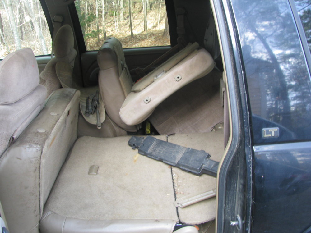

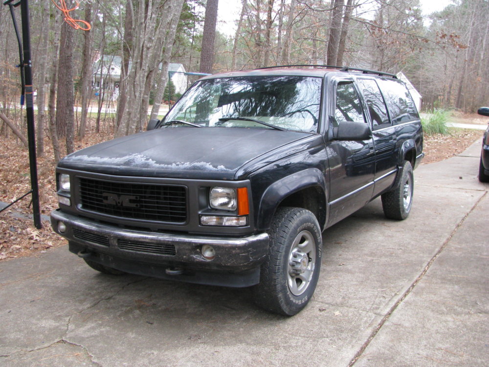

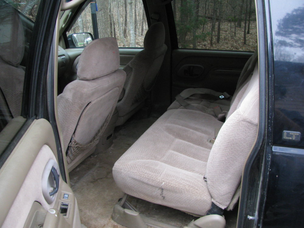

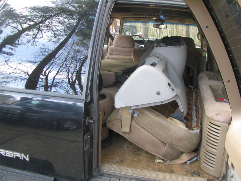

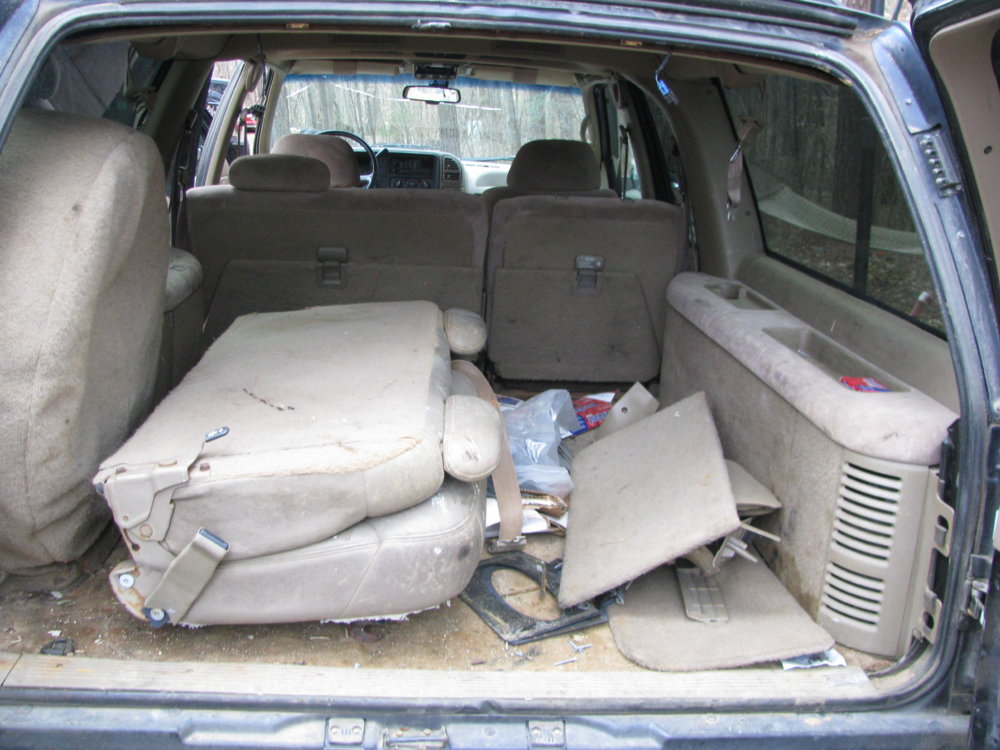

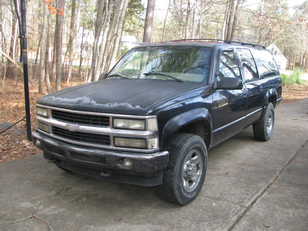

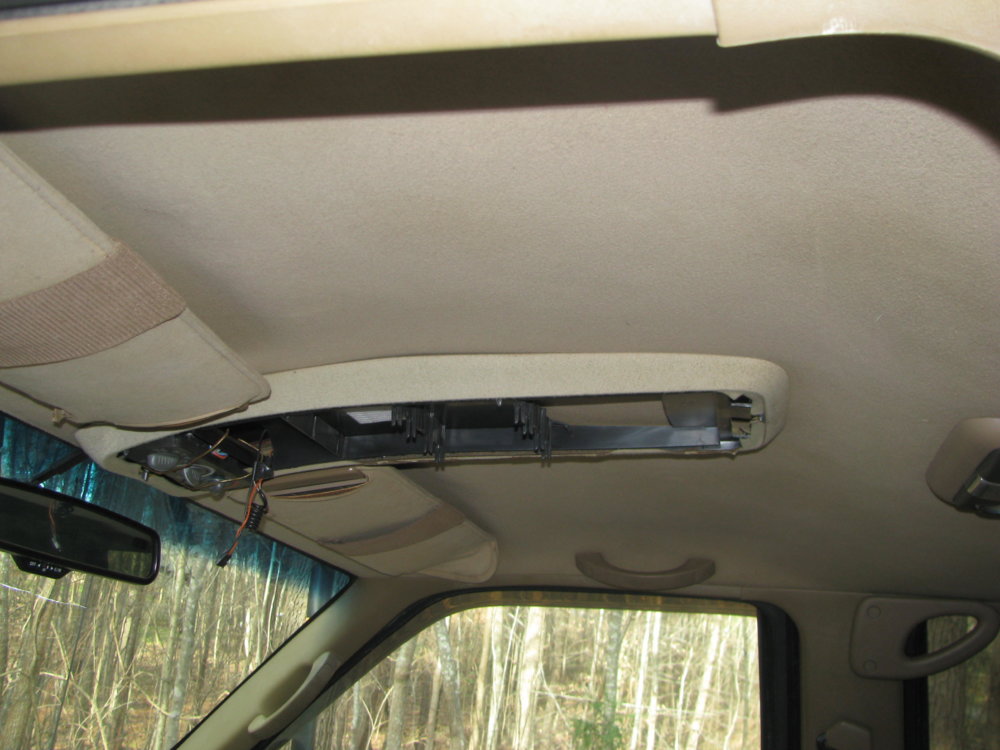

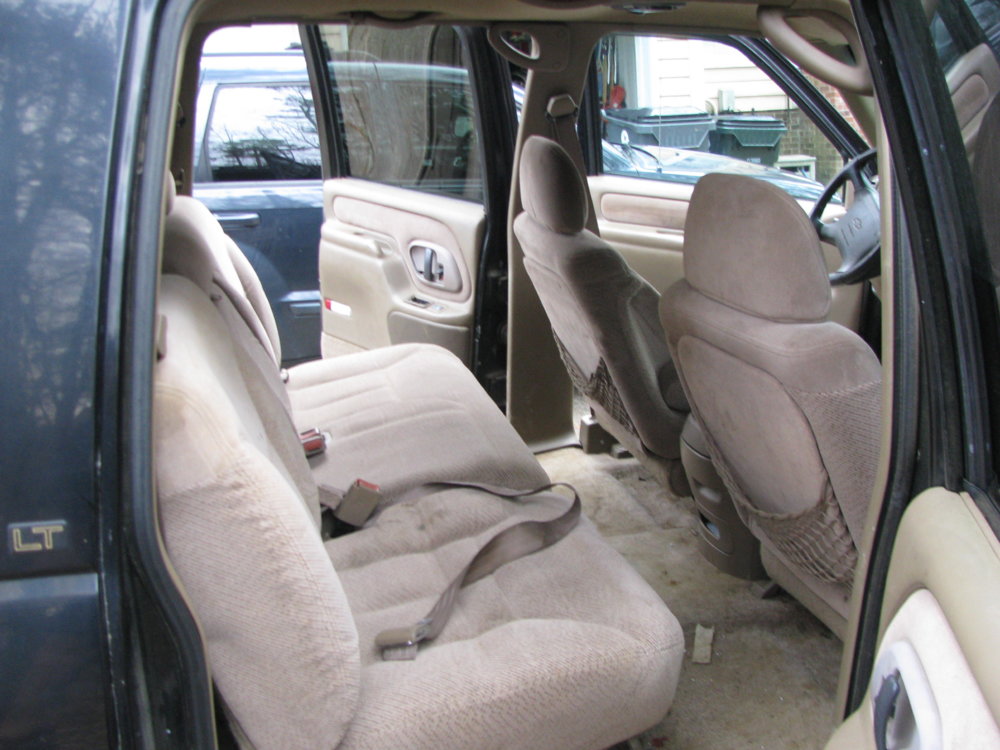

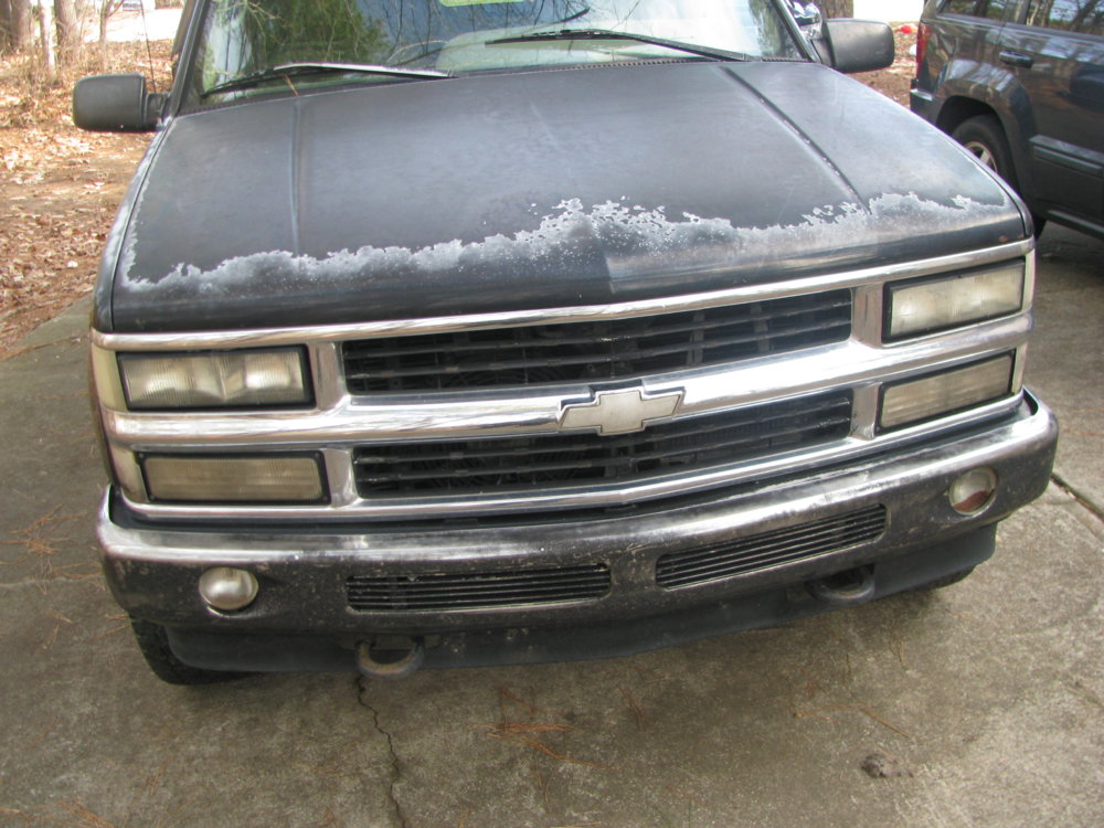

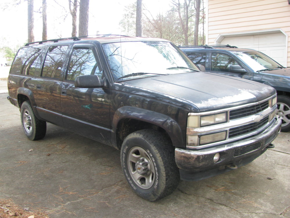

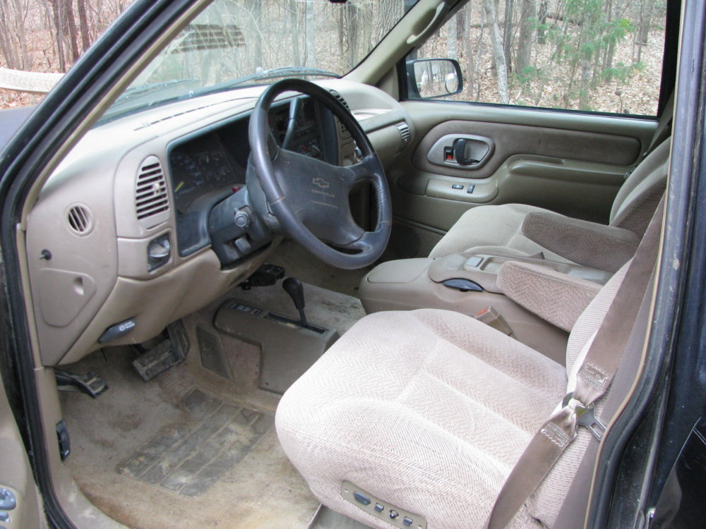

Here's how it looked when I got it home.

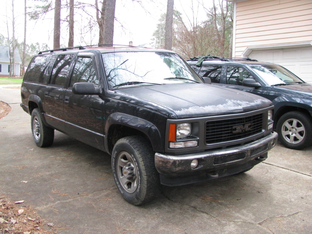

Here's how it looks after yesterday.
Dang tough trucks, has to be one of the best year models ever made.

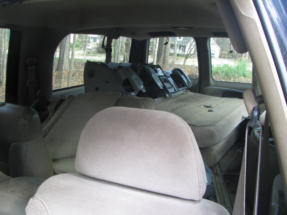

I've pretty much just been driving it. I had a 99 Burb parts truck come through the shop, so I pulled the complete gray interior out of it. I kind of like the darker tan color better, but I'm fine with the gray since it is so nice and my tan is so disgusting. I also am trying to find some new wheels for it, either the 2000s Duramax/2500 wheels or some 2500 steelies and trim rings from the earlier models.

It's not a straight swap out, but close. You'll need to install headlight buckets for the halogens and rewire the headlight harness because the plugs are different. I just pirated an XJ at the shop for the plugs and soldered them in. Everything else bolts right in.

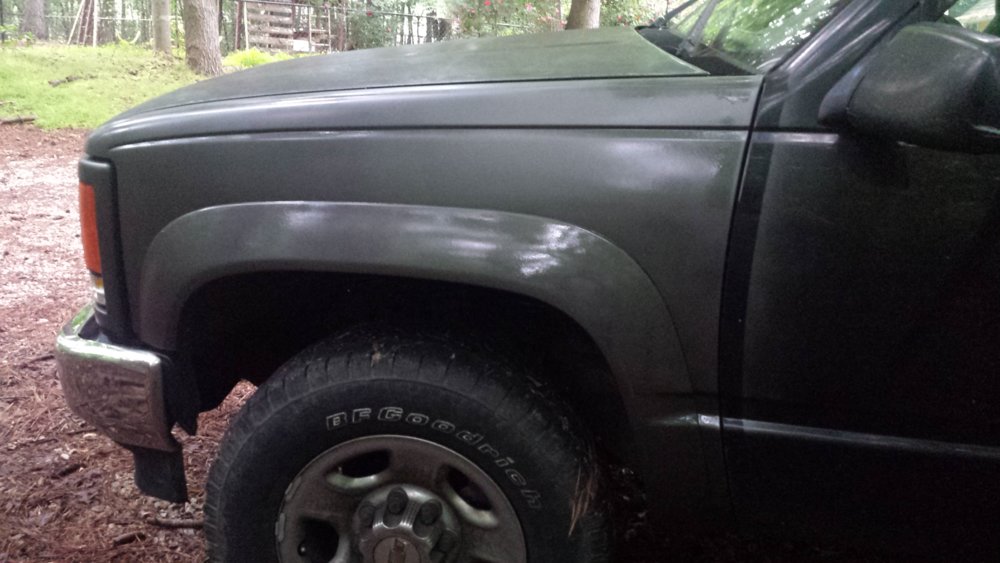

So in the daylight the grey looks kind of primerish. I asked my trusted adviser who is way smarter than myself, and also my beautiful wife, what she thought and she said it would look bad and to go with satin black instead. She's a smart one. Satin black it is.

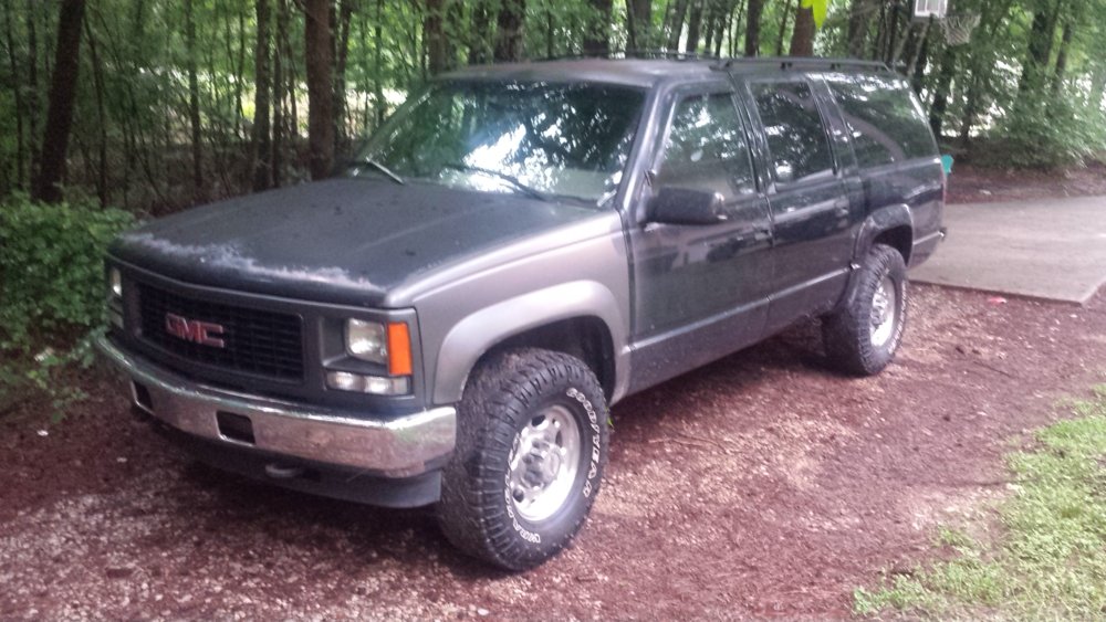

Installed some new wheels and tires last night. Well, new for the truck. Got some Duramax wheels with some Goodyear Duratrac tires. Didn't really want such an aggressive tire but for the price I'm fine with it. I already ordered some OBS centercaps for it to replace the NBS ones on it. Which is good because one flew off on the way to work today. :lol: This fixed all of the ride quality issues with the truck. I'm not sure if it was the 14 year old tires, the fact that the spacer prevented the hub from coming through the hole in the wheel, or what. The truck violently shook at various speeds, now it is smooth and rides great.

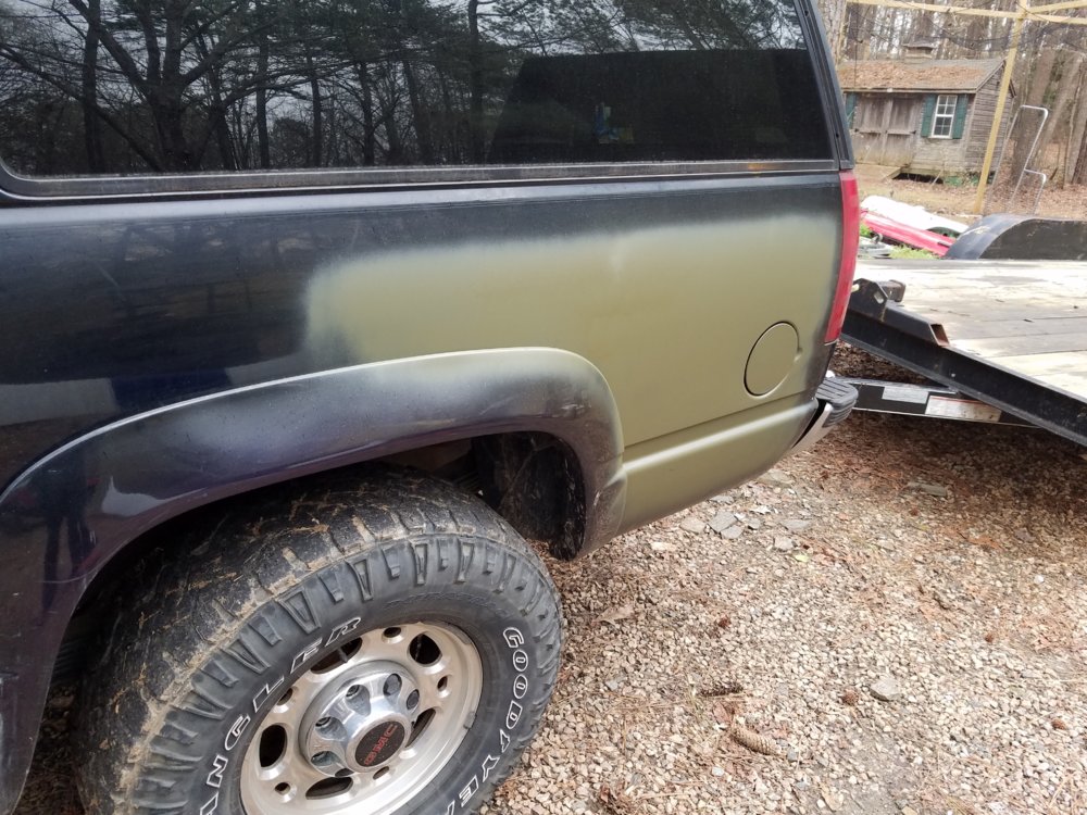

Respray it in flat olive drab green. I thought about satin black, but decided against it. Family wanted gunmetal metallic, but I really don't want to deal with spraying metallic paint and make it look nice. So I decided I'd just go with some military olive drab paint from Kaiser Willys. Easy to spray, easy to touch up, looks cool.
