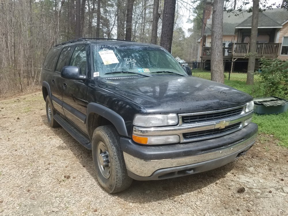

So here's the steaming turd pile engine donor. 330k miles but the engine runs strong as hell. Trans is shot and body is rusted to hell, but engine runs great!
Most of the 8.1s I've seen have a 300k+ on them
Still running strong
