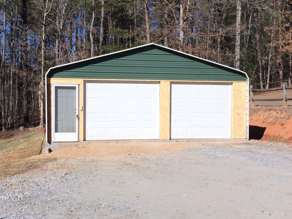

I just done a 24x28 metal building and did a monalithic slab it goes from 4 inches to 2 ft side to side, this is second one I've done this way and haven't had any cracking or other issues, on the 2ft side I came in 16 inches in from the outer form and built another form 20 inches tall and back filled in sand to save on concrete. You can kinda tell in the pic best way if your spot isn't level
