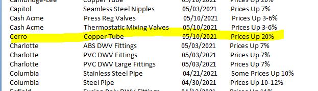

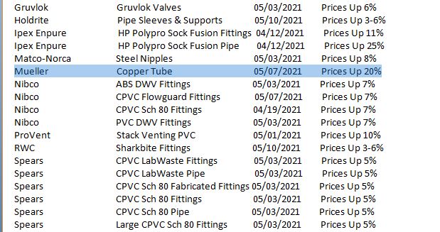

It's coming I'm afraid. I got the Mueller and Cerro numbers from wholesalers first of May..and expected the same for June thru August. Supposed to flatten in the fall, but I imagine these costs will hit MFG's very soon. Most HVAC bids are coming in 40% higher than this time last year due to rising material and anticipated MFG price hikes.
