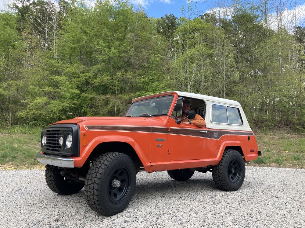

I have been working on this thing since June and I will add posts and pics of my trials and tribulations as I have time, but I figured you all would enjoy the ride and might help me sculpt my end goals for this Jeep. Here are some pics of my first commando, and the orange one is my new Commando.

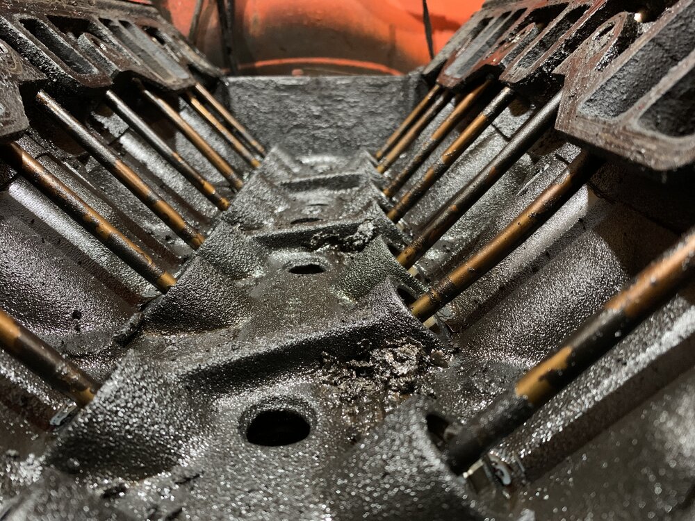

Now that I knew that I was dealing with a carb issue I decided to use some parts that I had accumulated and put a intake and 600cfm Edlebrock on it. When I pulled the stock intake I realized I was in more trouble than I thought. The valley looked like someone dumped a shovel of dirt in it (the pic is after a good bit of scraping and vacuuming), and there were 7 bent push rods. After talking to some engine buddies they seemed to think I had a wire out cam/lifters, but there was a chance it was just driven really hard and over revved. So with this info I figured I would just replace the bad rods, put it back together with the new carb and intake to see what it did.
It ran 1000% better, for a little while…

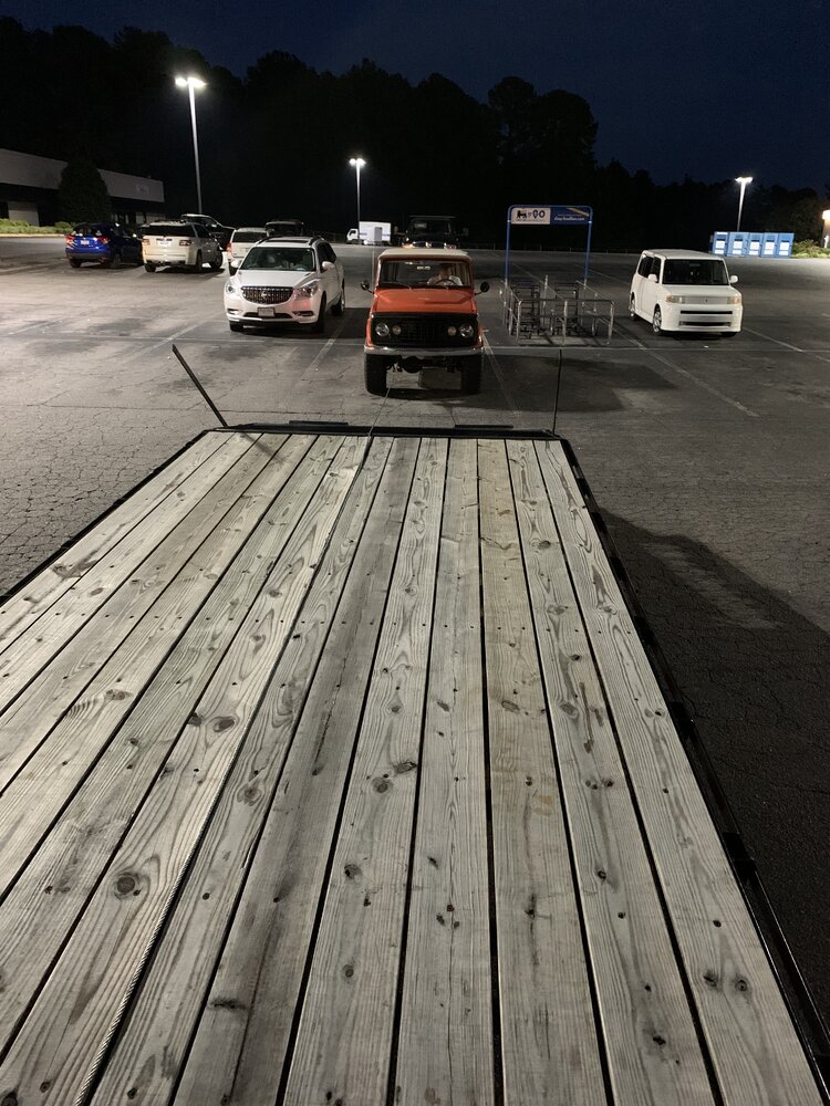

So I put about 50 miles on the Jeep with the new carb and intake. Started with small trips. You know just testing it. I took it to a neighbors across town which really gave me a boost of confidence. So I went to meet my parents in town for dinner and I drove it. The whole time I was telling them that I hope is starts to go home. Hahaha. We go out to leave and it cranks right up, so I decided to stop at Food Lion to grab some beer and that’s where it left me. It wouldn’t fire, and I was getting no fuel in the filter so I figure I lost the fuel pump. Well at least I had a case of beer while I waited for someone to go pick up my rig.

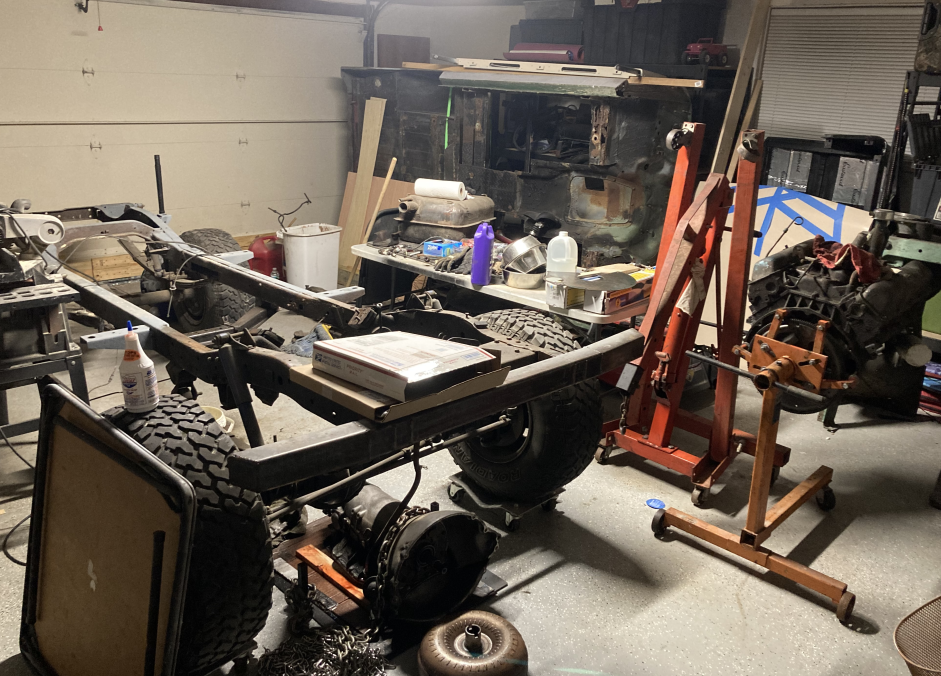

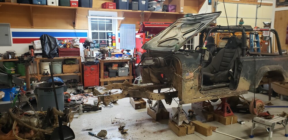

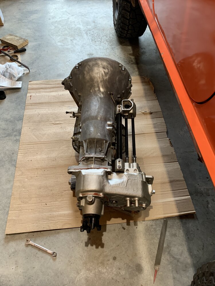

While I waited I dropped the t case and trans to clean and reseal. I did a full tear down on the D20 and resealed/repainted it. Both the case and the trans looked like they had been buried for years. I got them all cleaned up and then pulled the motor to do next.

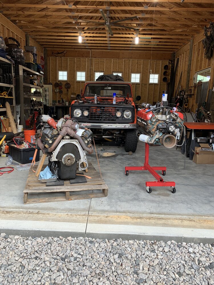

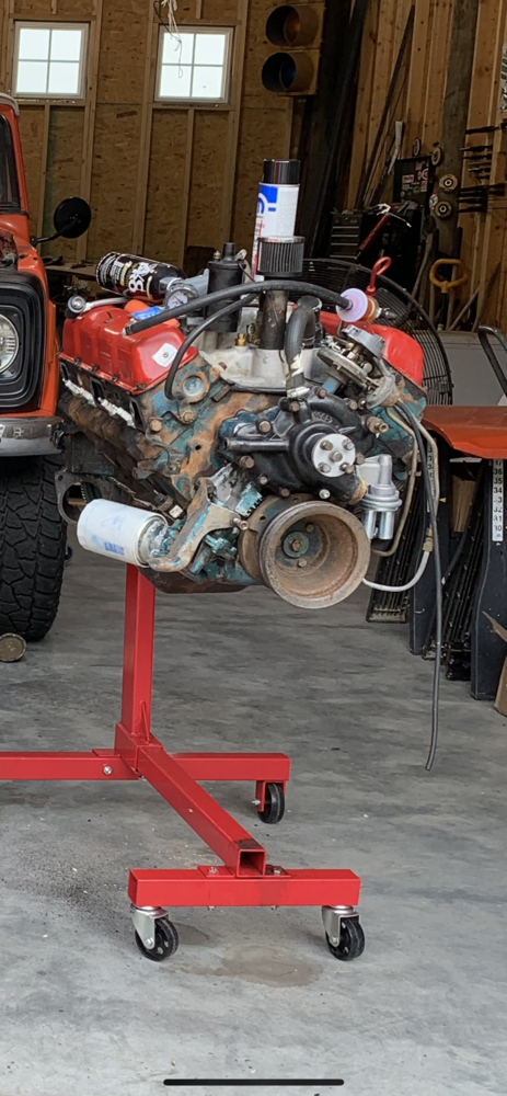

Pulled the engine and degreased/washed it off. It looked terrible and I ruined at least two sets of shop clothes due to the 50 years of crud that ended up on me. There is a lot more cleaning to do, but this is a start.

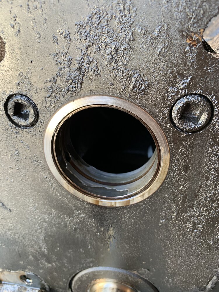

The cam and lifters finally came in so my neighbor and I took a Saturday and decided to do the install and put the engine back together. Everything was coming apart nicely and we knew we had all the parts so we were riding high. Then when we pulled the cam out we noticed this… and all the bearings were the same.
At this point we knew we had to flip the engine, pull the pan, and check the other bearings. I was getting pretty frustrated because I bought the Jeep with the understanding that the drivetrain was solid, and I had a stack of service records from the PO. Hell he had just had in in the shop getting a new oil pan gasket put on it right before I bought it.

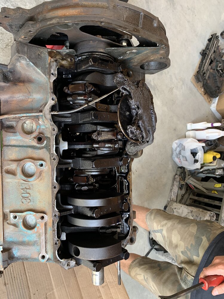

So we roll the motor over, and pull the pan only to see this.
Yes. That is a red shop rag stuck to the oil pickup.

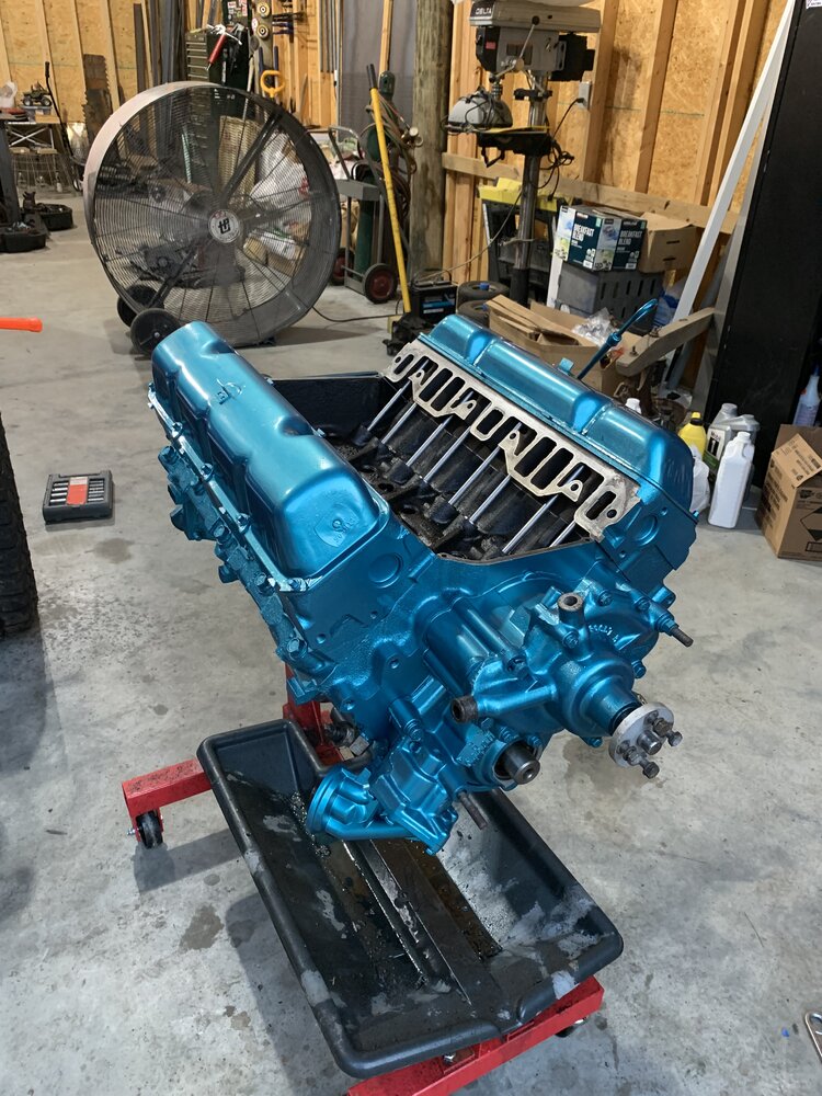

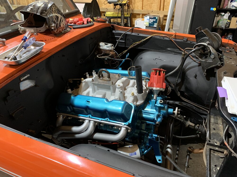

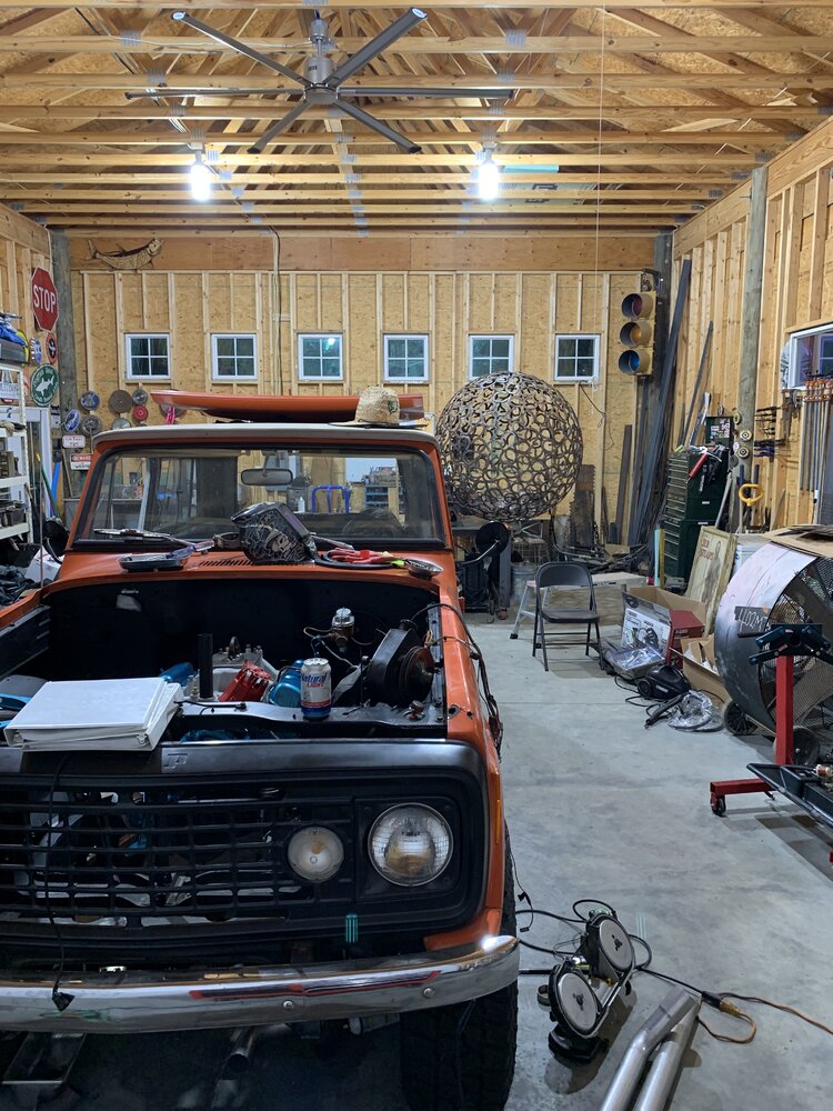

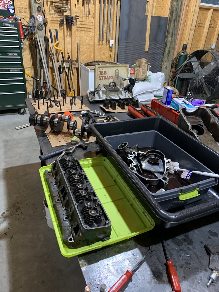

All of the bearings were shot. I figured I might as well finish cleaning the engine and put all new bearings in it and see how she does. I made the decision to not do rings or send the heads off cause At that point I might as well send the motor off and have it completely redone. So I tore the whole thing apart, and ordered all my parts.

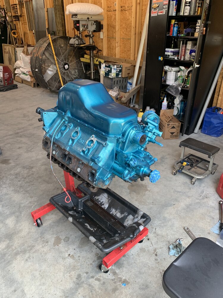

I ended up doing all new bearings, freeze plugs, oil pickup, crank seals, RV cam, lifters, head gaskets, oil filter housing, oil pump, timing gear and chain, and all gaskets. I also decided to put on full MSD system with billet distributor, MSD wires, and headers.
