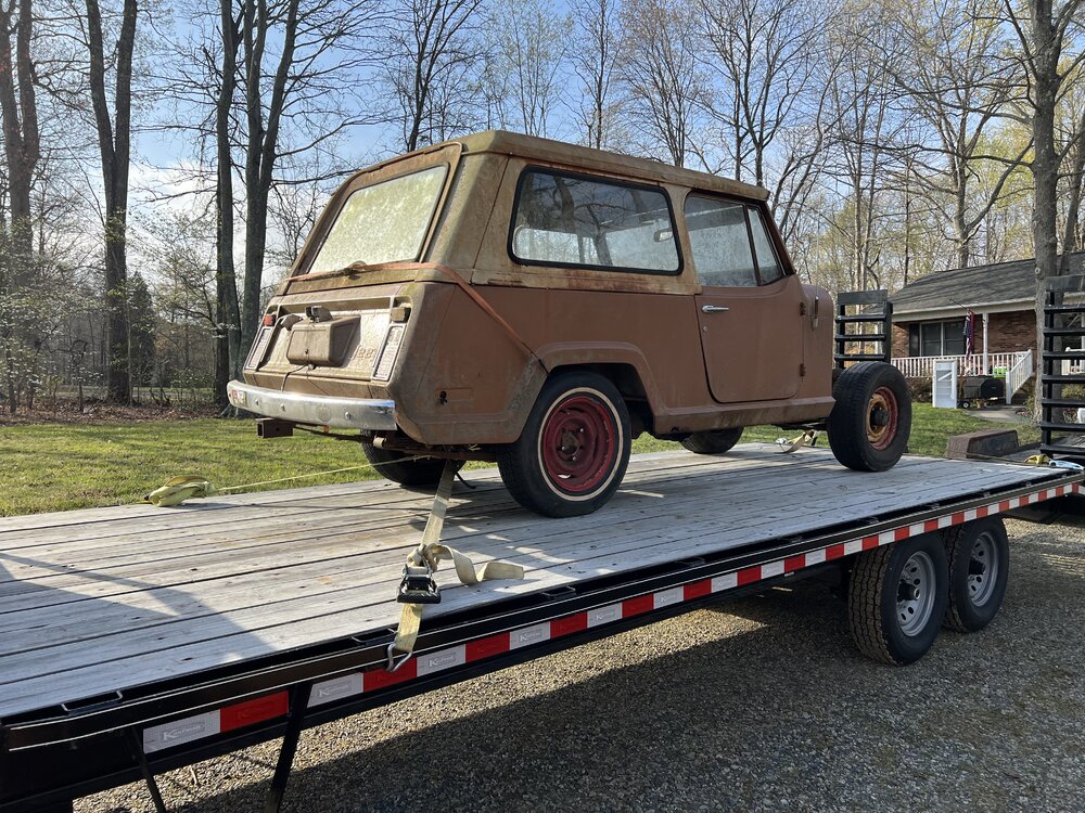

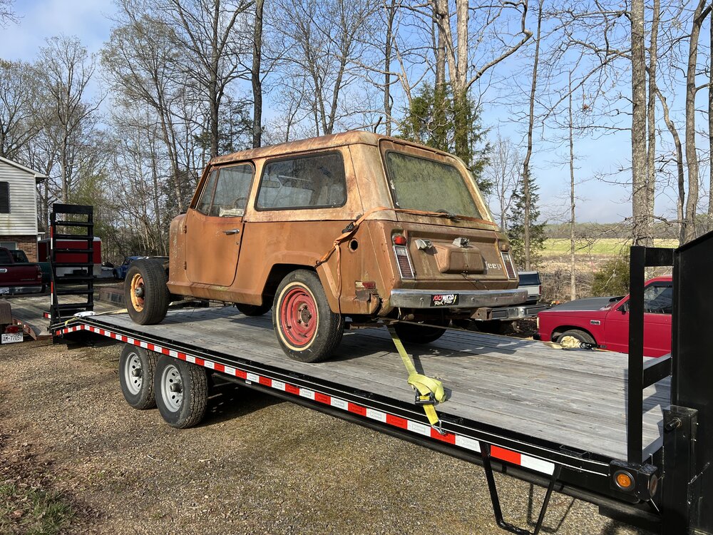

Bringing this thread up to date finally. I am forever on the hunt for a ā€œbetter bodyā€ (arnt we all hahaha). Last week one popped up on a nc farm equipment page for sale. The guy had two and was going to crush them. Luckily I was the first person to contact the guy and was able to grab the better of the two (my 24ā€™ trailer wouldnā€™t fit both otherwise I would have brought both home for $1000). I ran down around Highpoint and grabbed this thing for $700 and I have to say it is better than my tub, but not by a huge amount. What is great is the tailgate and rear hatch are in great shape! Also this gives me a ton of spare parts, and a top that I can make a safari top from if I feel so inclined. Other than that I havenā€™t really spent much time looking it over.
I will say I absolutely am loving the fact that I put a rear 12k winch on my flatbed. This thing had seized front brakes and I drug her right up on the trailer.
